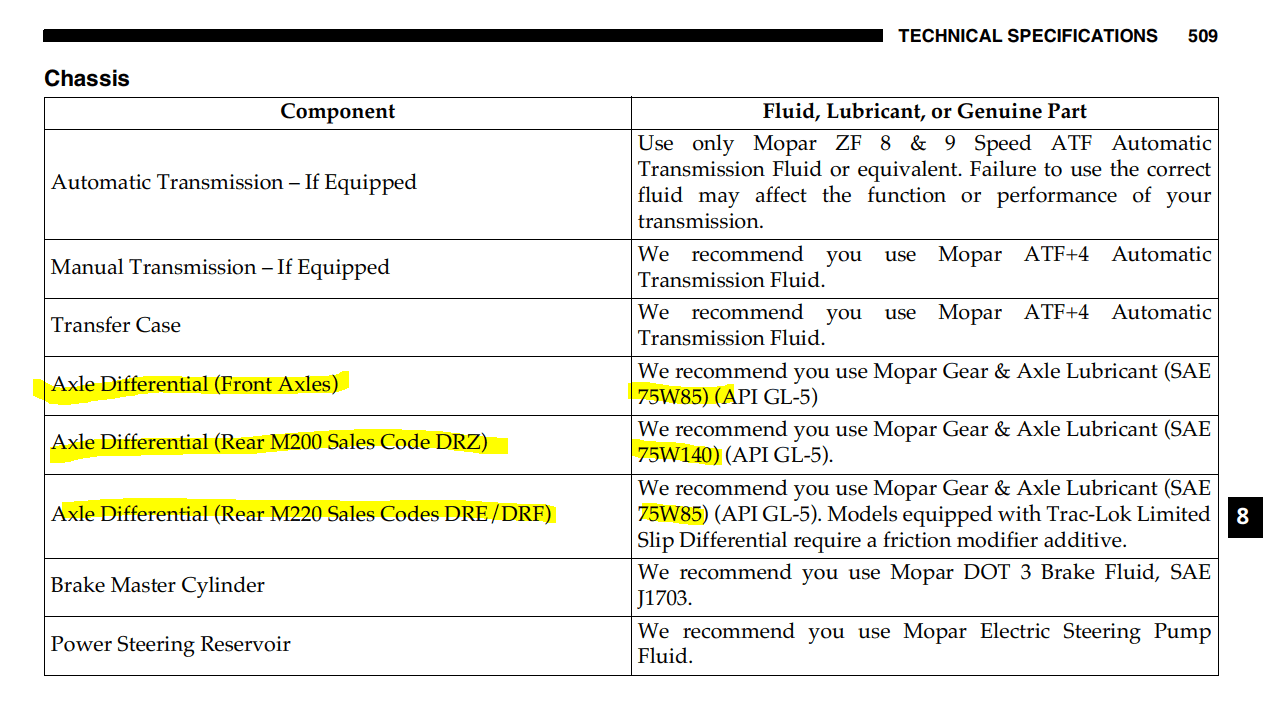

Could it be - GASP - You looked in the BOOK??
It looks like "it depends" on which axle/differential you have back there................ there's a difference.
Jeep Gladiator Gear oil question axle-fluid
I have been known to read manuals occasionally. shhh… Don’t tell anyone though!
