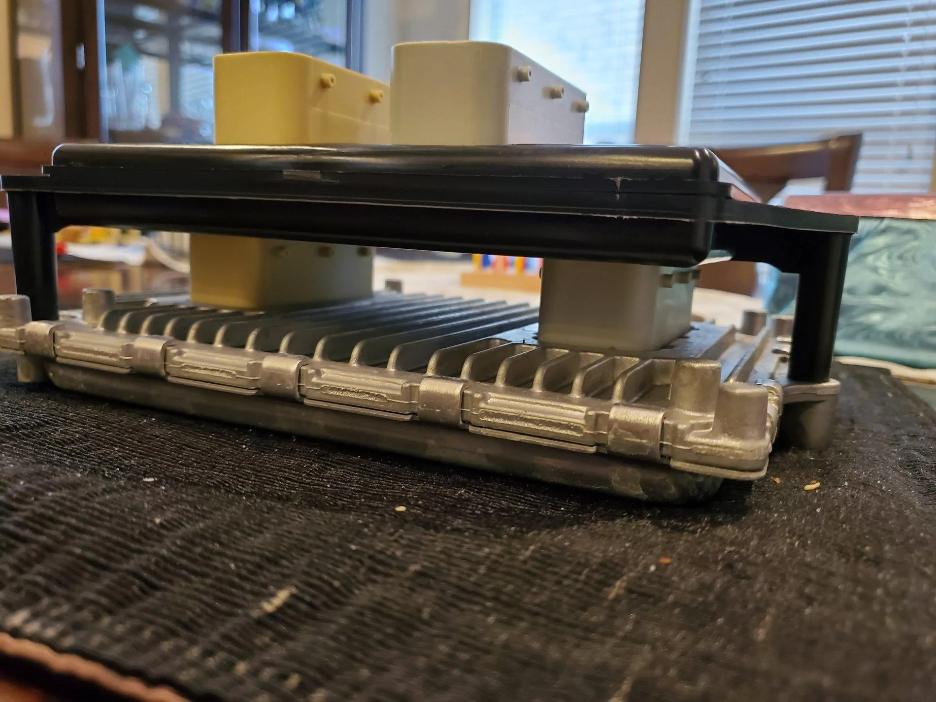

Ok got my pulsar installed that thing is amazing!!!! It deff makes a big gain in power[/QUOTE
That's Really cool. Does it actually increase performance that much or is it just more throttle response from Pedal tuning?

I would say it deff has throttle response I would say yes it's really cool gas got better that's really what I wanted, well gear ratio and tire size too. I still want a taser to add the front camera

I don't think it would void the warranty at all it's just a piggy back really you unplug it goes fully to stock. It's really neat. Just be careful with the pcm when pulled out. It's an awesome upgrade
