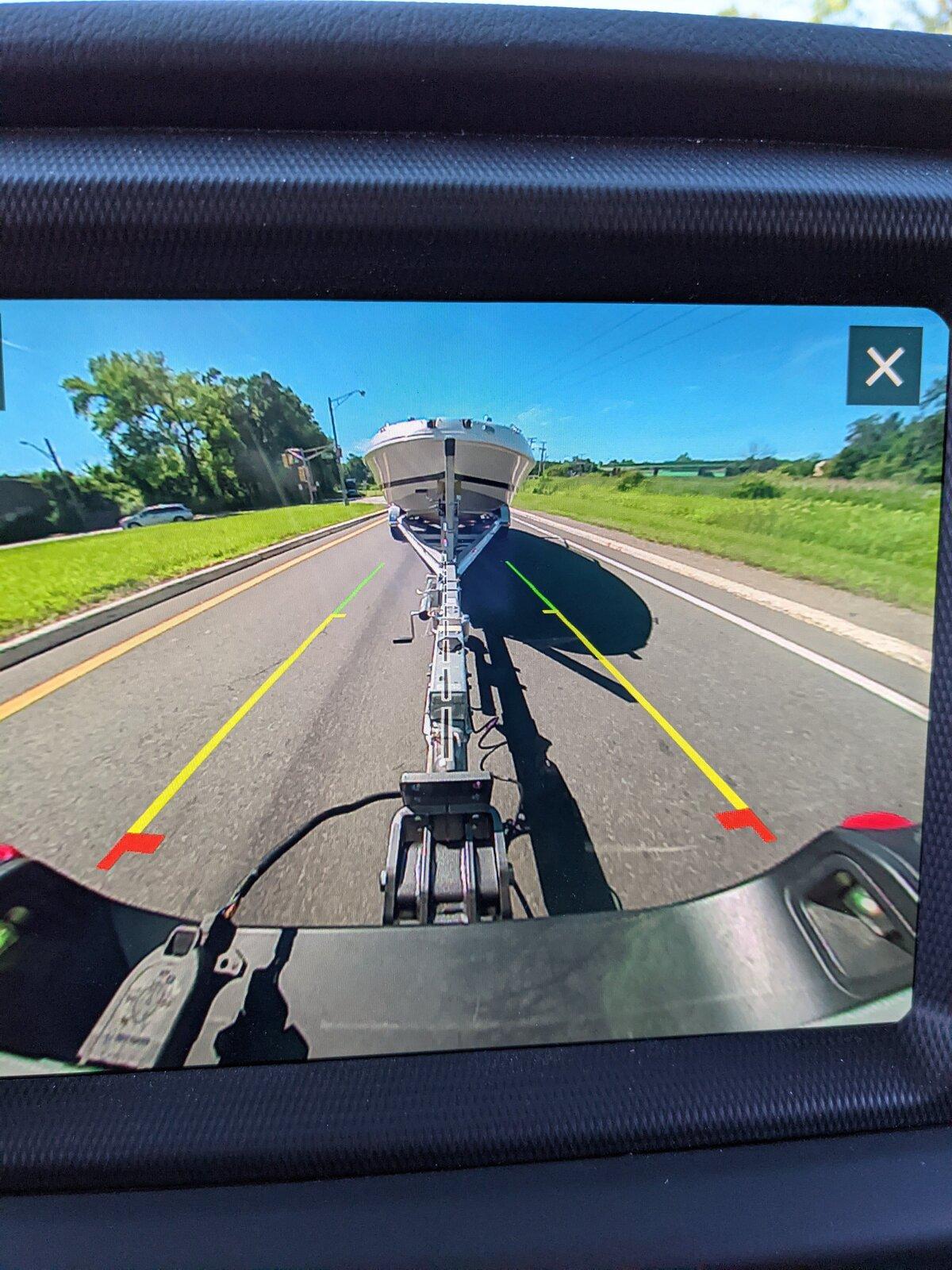

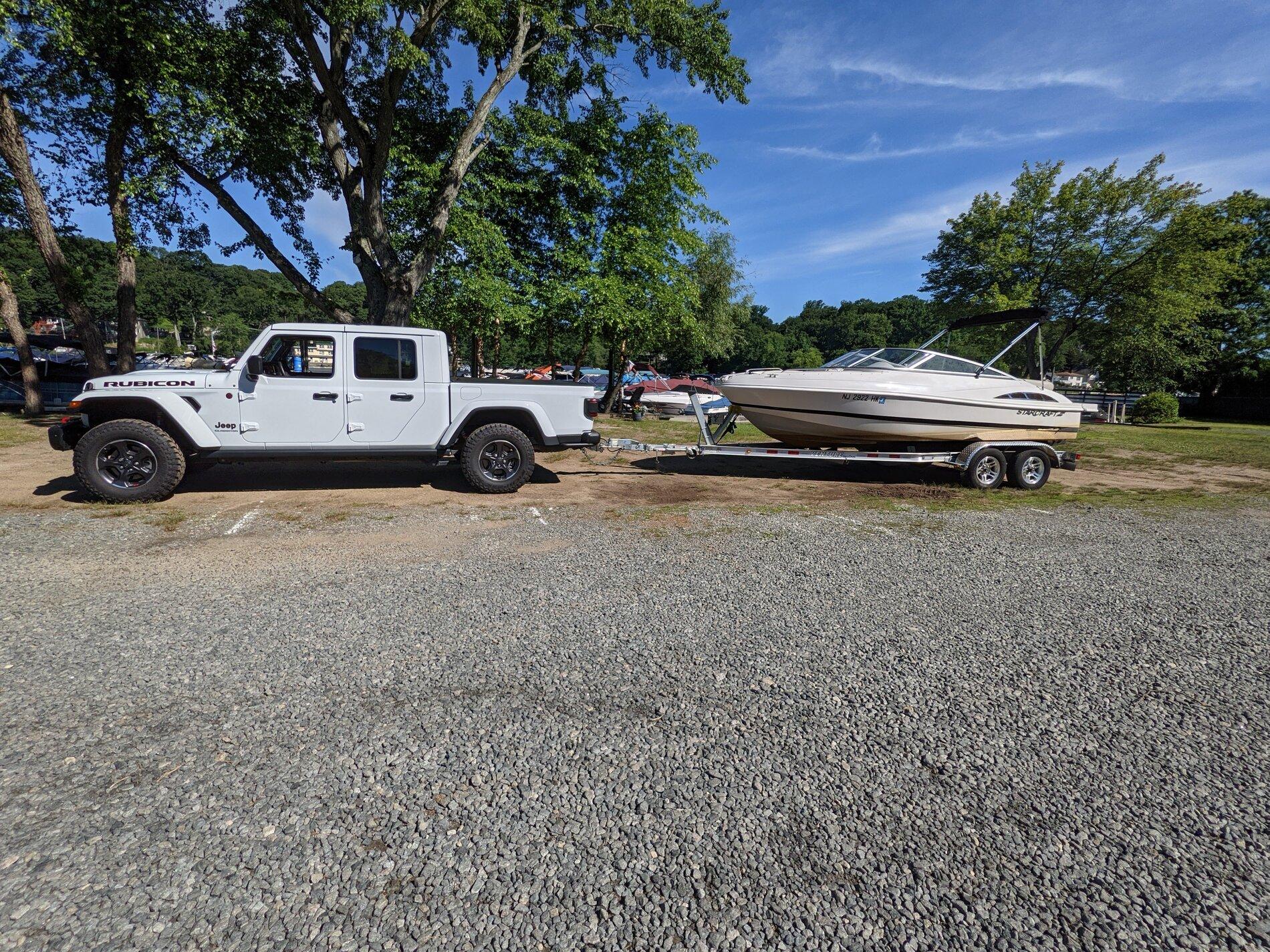

First time towing with my JTR, and I'm loving it. Felt strong and stable, and climbed hills with ease. Much smoother running with the boat hitched up vs. my GX460.

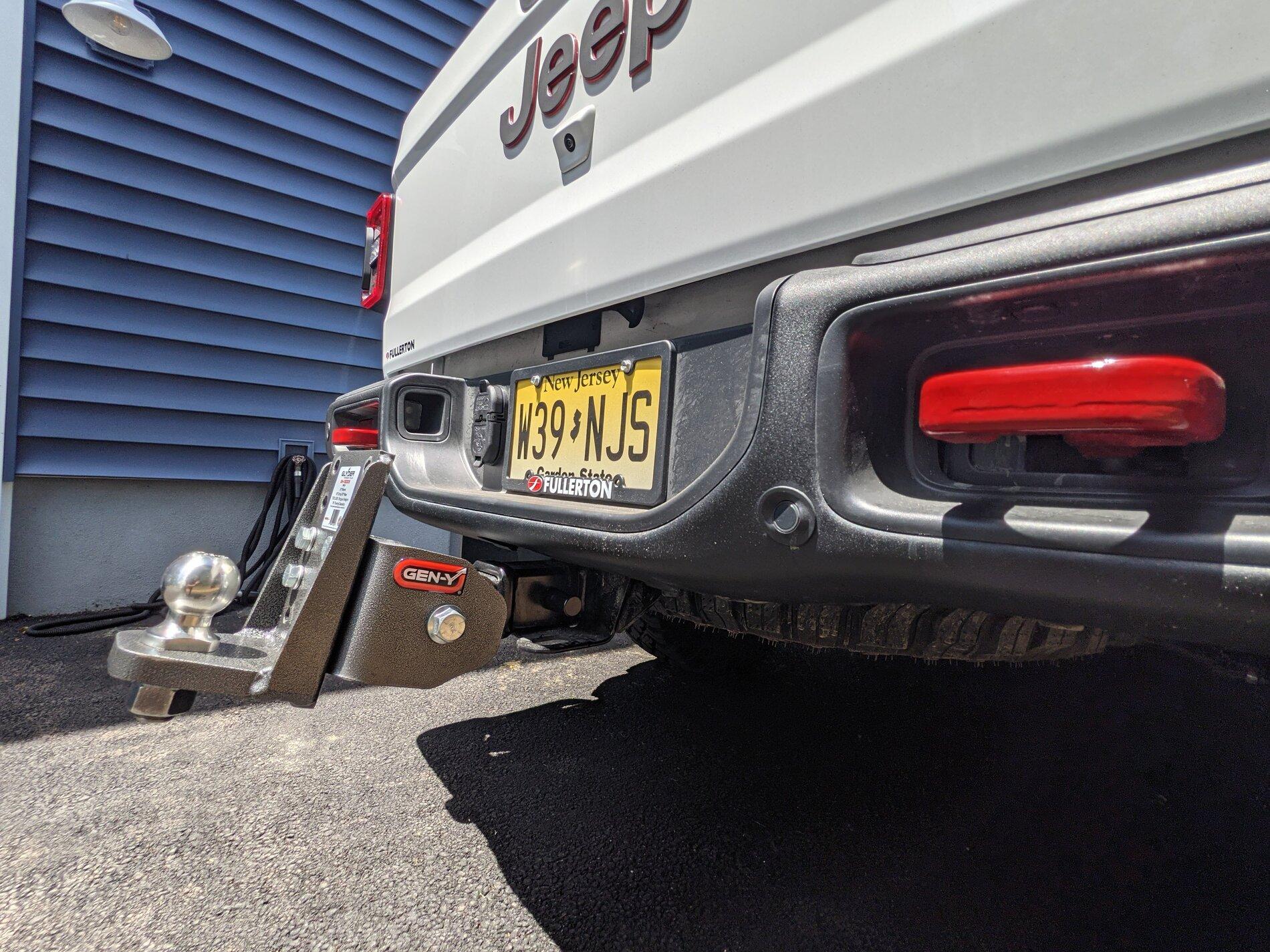

Also this is the first time I'm using my new hitch. So far I'm really impressed with this Glyder hitch from Gen-Y. Extremely well made product, and the 1hr ride from the lake to home was silky smooth. No more pulling & tugging from the trailer on bumpy roads. The test will be tomorrow, as we are towing a solid 12hr+ down to NC.
Super happy with the setup so far. Anyone considering the Glyder, I say its worth it. I went with the 6" rise/drop version. This should give me the flexibility when I add larger tires and modest lift. 🍻

Any idea on overall weight? Where does the leverage come from?
I like the Husky setup we have, but it's 100 lbs and the Anderson setup is 50 lbs.

The hitch weighs around 40lbs +/-
There's a thrubolt with rubber bushings to allow that flex and cushion. Check out their website, it's got a video showing how it works.
600+ mile trip, and it was super smooth ride. Really happy with the setup.

Glad you are happy with your hitch, but you should really consider a weight-distribution setup if you are towing anything significant (especially on bumpy roads). Far safer and an overall more enjoyable ride.
I personally use an Anderson style hitch when towing a 4k lb travel trailer and it made a world of difference. Though I might try a hitch like yours towing a light weight trailer or something.

I don't think I have ever seen a WD Hitch on a boat trailer. At least not sport boats. I could be wrong, if so someone will step in and show us.

I'm all for towing safely and I'm sure a WD hitch wouldn't hurt. In this case, my boat is 1,800lbs dry, aluminum trailer with tandem axels is about 1,000lbs.
I think as you approach 5k pounds, you should strongly consider a WD hitch + brake controller. Again, just my experience.

And if you tow a car on a car trailer at around 6k#, which I do, you don't really need one because you can move the towed car forward or backward to distribute the weight properly.
