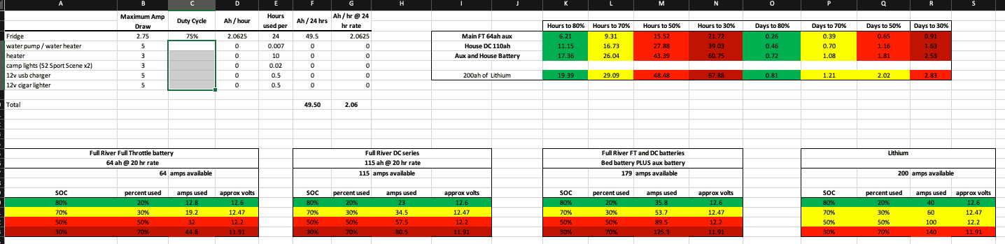

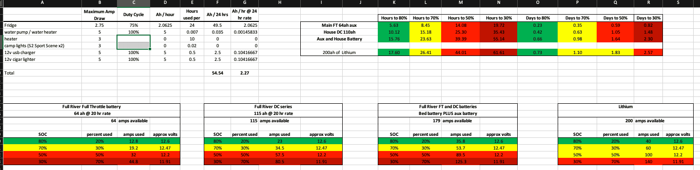

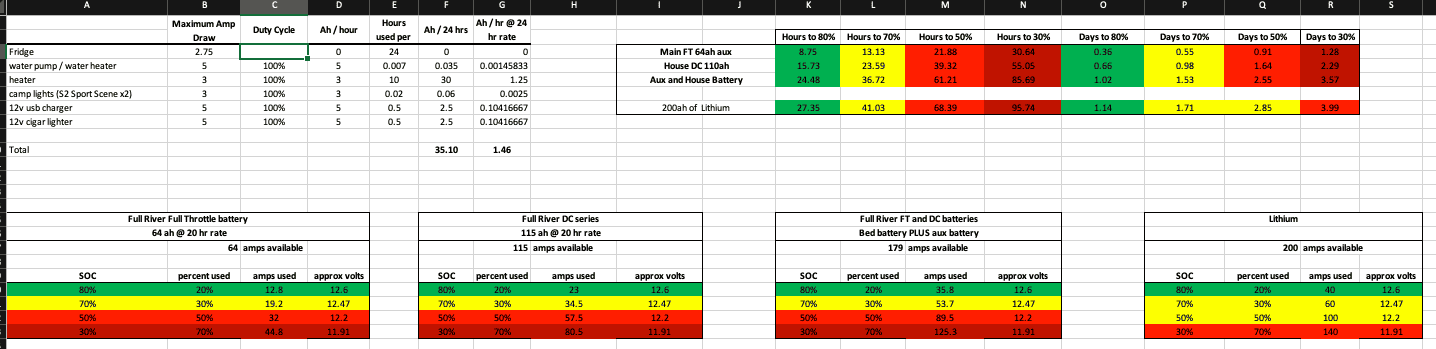

Here are a couple more screenshots to compare with the one referenced to above. Note the differences.
Heater removed from equation
Jeep Gladiator Genesis dual battery system - a discussion Screenshot 2023-04-23 at 17.44.12
Heater and lights removed from equation (why not, I have a new Coleman LED lantern that is super cool)
Jeep Gladiator Genesis dual battery system - a discussion Screenshot 2023-04-23 at 17.43.36
Everything except fridge removed from equation - which is what most people really care about anyway. Charge things when your driving....

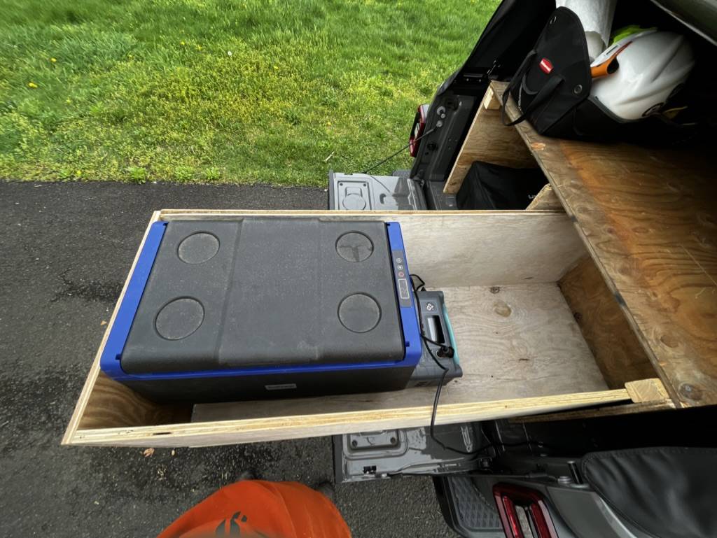

Looks like your fridge is in the bed? If you had a trailer I'd recommend a propane powered fridge.
mine is yes. The last propane fridge I had was in my travel trailer and it never worked good and almost set the trailer on fire.
