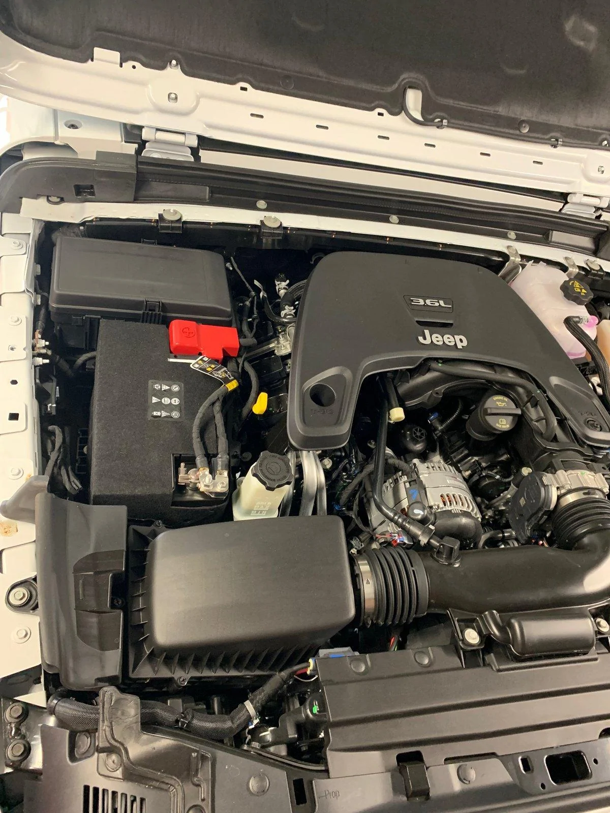

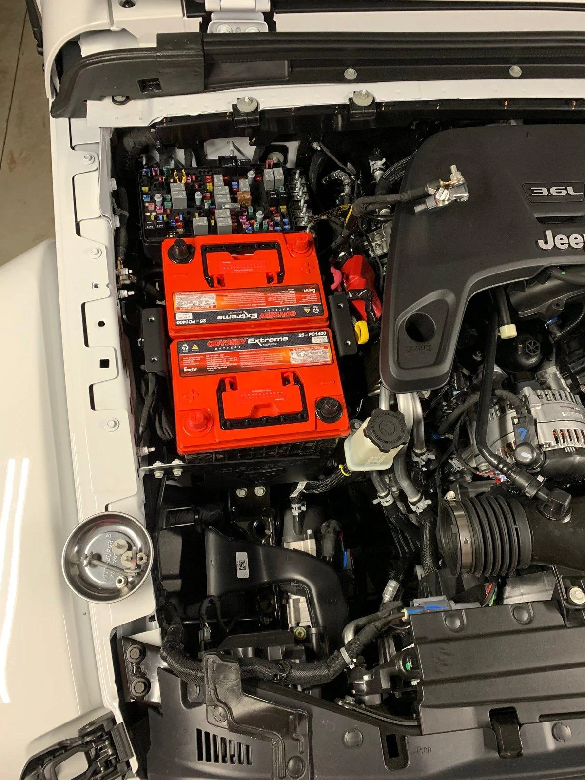

So, does the stock battery get reused or do we have to buy two Odyssey batteries?
The stock battery does not get reused. It gets removed and replaced by two Group 25 batteries (in my case I used Odyssey batteries).
The stock battery is 75Ah with 700 CCA. Each Odyssey battery is 65ah and 850 CCA.
Stock battery:
2x Group 25 Batteries in the same amount of space:
Stock battery:
