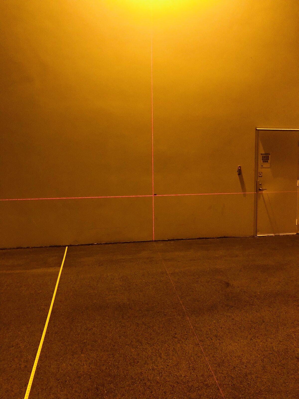

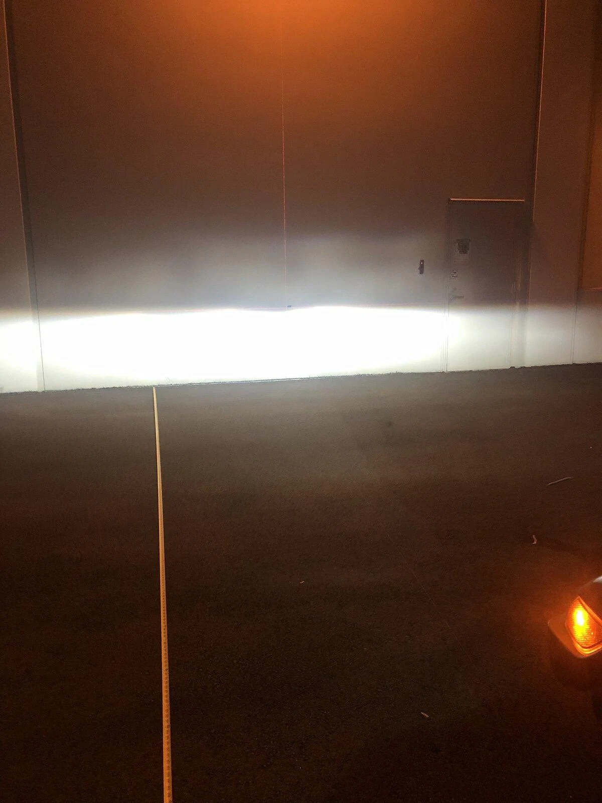

gsxr310
Jonathan
Apr 3, 2019
151
201
CA
JLUR & JTR
Adjusted mine a couple months ago as I got tired of seeing oncoming hi beam me. No more issues w oncoming traffic. Used a laser level I bought same day. Just a reason to try a new tool out!
