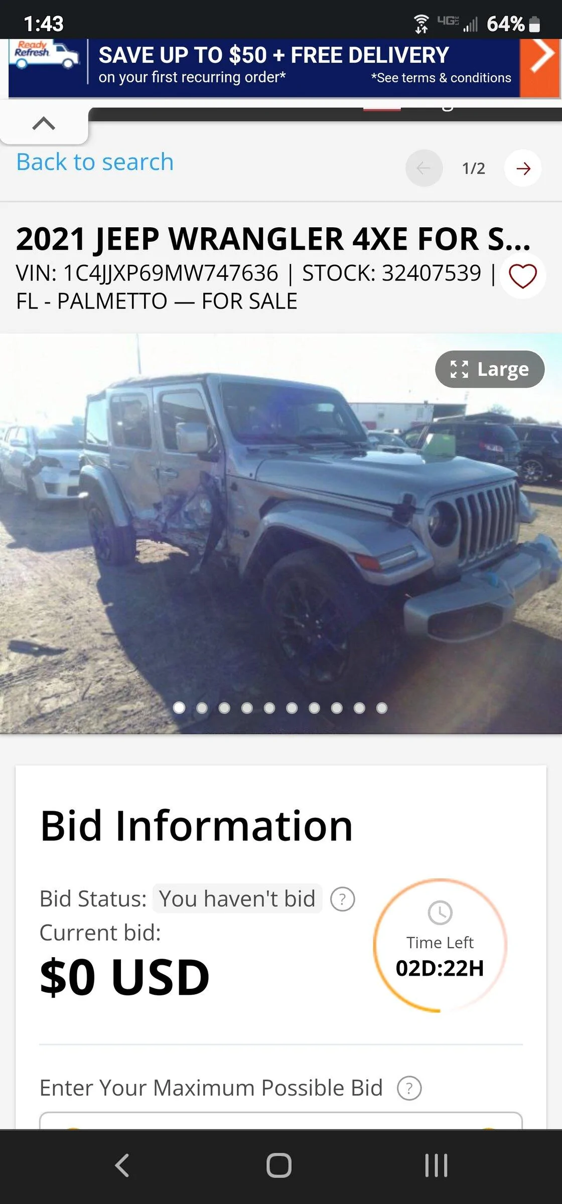

Everytime I drive my wife's 4xe, I am so impressed with that power plant. Nothing is stressed, it runs on 89 octane. It is smooth as silk, it has so much torque it pops into 8th and stays there. Oh and it is dead quiet. The get up and go is downright impressive.
Found a couple of these. I could rebuild the jeep for my daughter to use when she gets her license.

That'd be interesting to see... I wonder how much the extra weight (700ish lbs) will effect payload and related numbers as well as your current suspension set up. Especially since the Diesel guys have noted bottoming out their suspension with that added weight

May have to wrangle up some new coils. Probably no worse than an overlanding rig, but yeah.
