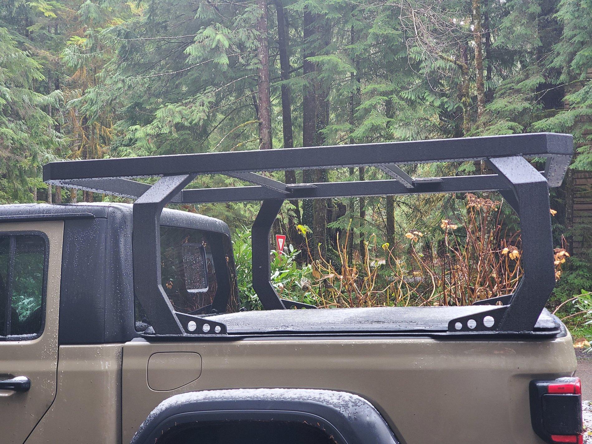

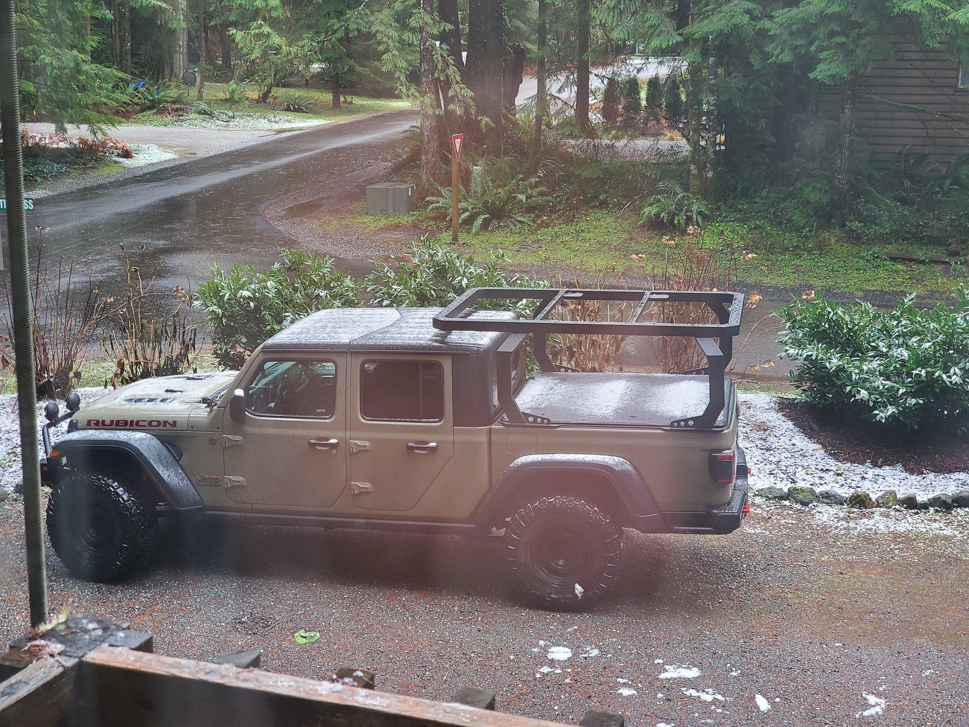

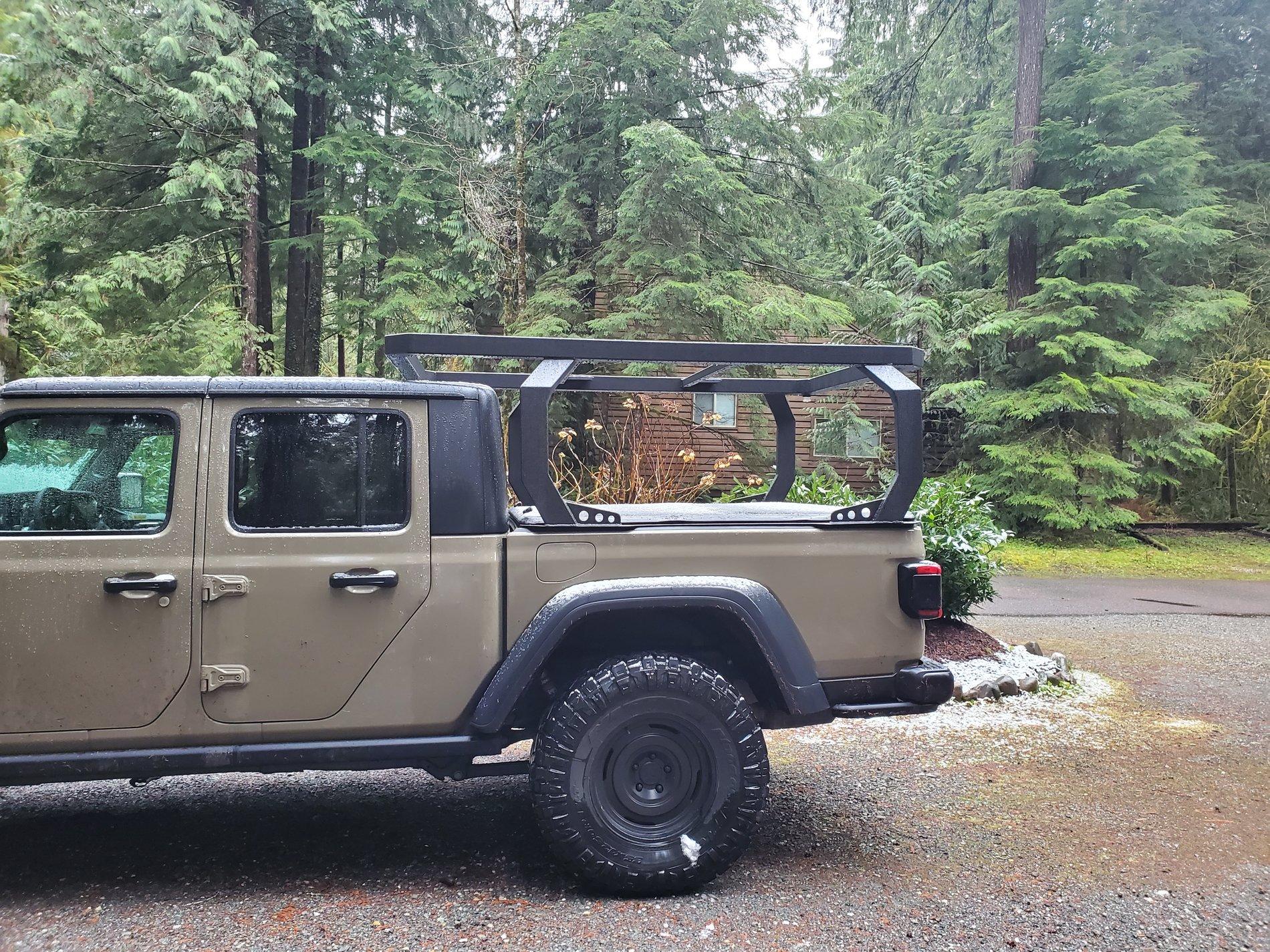

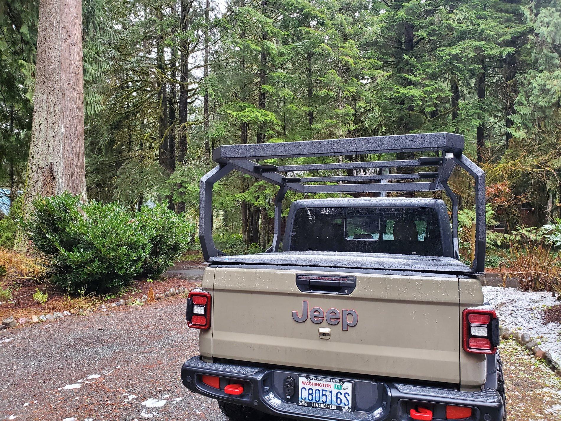

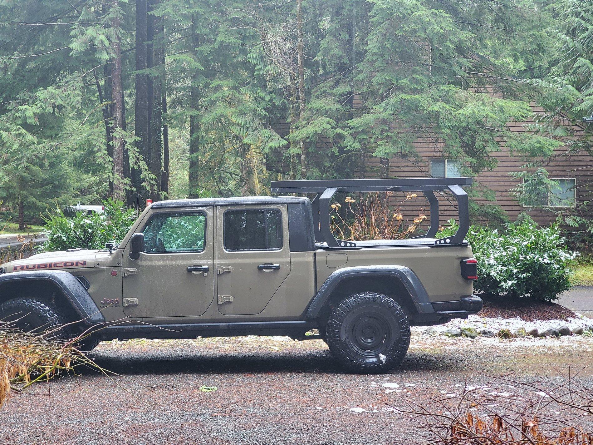

Got my rack back from line X yesterday. Pretty happy with the end result! This is the rack without the RTT. My RTT is also line X'd so the will look as one unit once I put it back on.
Next step.. next week hopefully is to have all the wayout decals installed.
@WhatExit?
You've done it! That looks great! :party:
Tell us about the water storage :rain:
The upper tube will hold just over 9 gallons of water. On one of the threaded sleeves I will install a Schrader valve so that I can add some air pressure into it to get the water to flow better. The other threaded sleeve will have a have a quick connect coupler with stop valve so water will flow only when the male part is connected to the female coupler. I will fill the tube using this and that way once I disconnect all the water will stay inside. This port will also serve for either mounting a shower head or garden hose for spraying stuff off. I'm looking at shower heads that are .5 to 1 gallon per minute so from my math I think with this I will be able to get at least 2- 4 minute showers out of a tank. I think for field fillings, if needed, I will come up with some type of funnel that mounts to the threaded sleeve so that I can fill it without a hose and domestic tap water if i'm in a pinch. I don't think I will use this for potable water at is going to heat up quite a bit in the summer and I don't want to drink hot water. All my fittings should arrive today so after I install them I will upload pictures of the finishd water set up.
The unit you can purchase online that is basically the same set up is called the road shower, but it only holds 7 gallons and cost over $300.00 OUCH!
