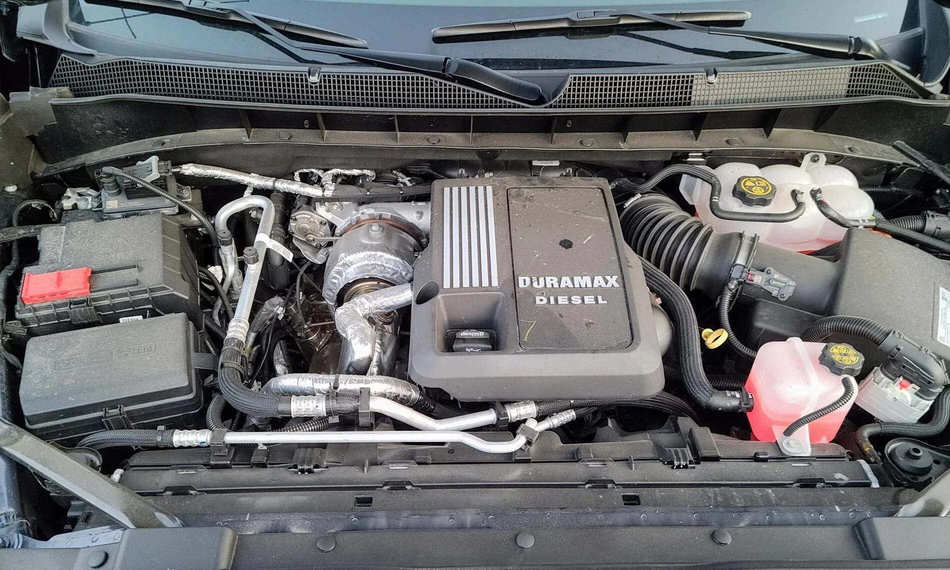

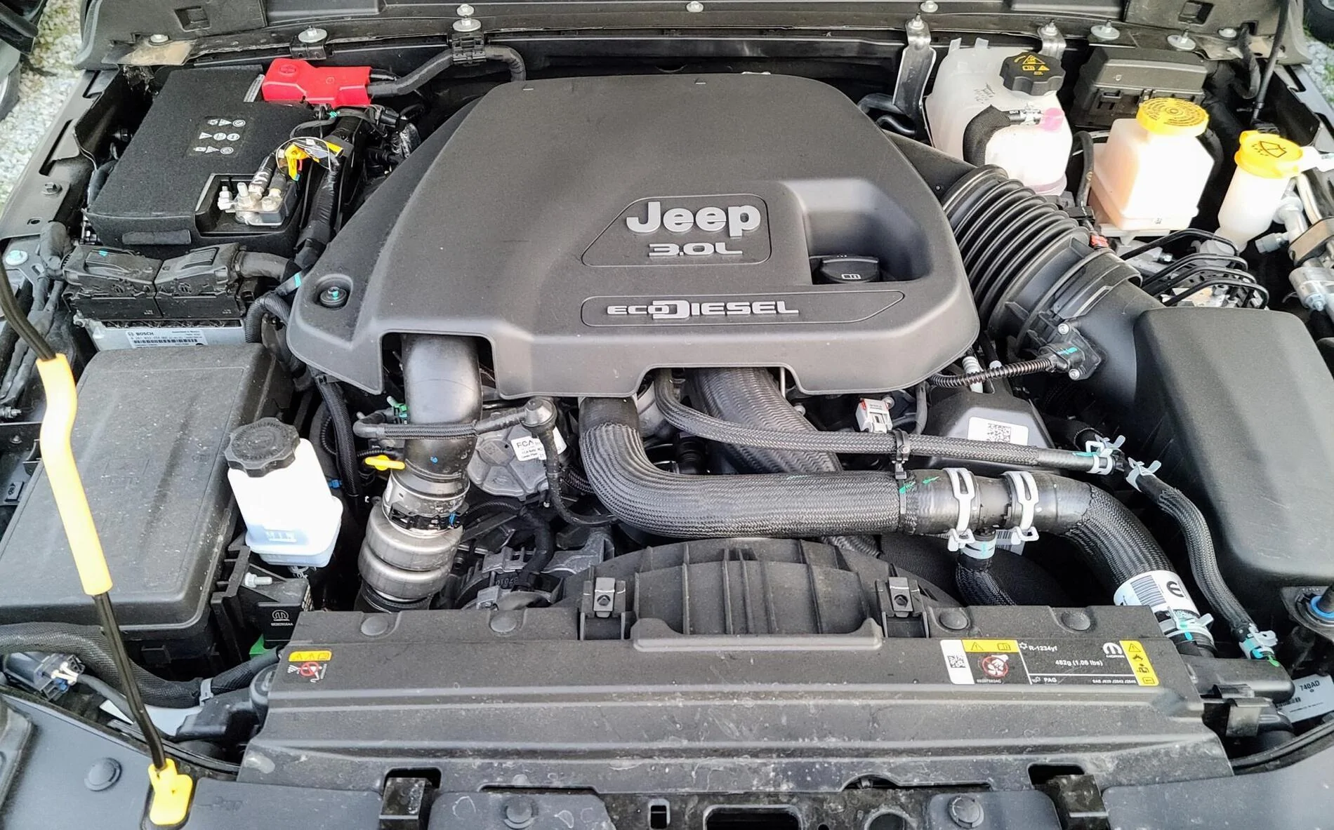

I just picked up a Gladiator High Altitude Diesel about three weeks ago and i got a new ‘21 Silverado LT with the 3 liter turbo diesel in late December last year as my new company truck. I figured you guys might like to know how they compare. At this point I’ve got a whopping 850 miles on the Gladiator and just rolled 9400 on the Silverado.
While both these engines are 3 liter, 6 cylinder, 24 valve turbo diesels otherwise they are pretty different. As we all know the Jeep is a 60 degree V6 and the Chevy is an I6. The Jeep uses an air-to-air charge cooler and what appears to be a mid-size top mounted turbocharger. The Chevy has an air-to-water charge cooler and a pretty large turbo. The Jeep of course has the 8 speed ZF auto and the Silverado has the joint GM-Ford 10 speed auto. The Gladiator has 3.73 gears and factory 20” wheels versus the Chevy’s 3.23 and factory 20“ wheels.
When new the Chevy was ridiculously quiet for a diesel. My previous company truck was a 2012 Silverado with the 5.3. The diesel was and continues to be much quieter. Now that I’ve got almost 10k miles on it the engine now sounds much more like a baby Cummins 5.9. It’s still pretty quiet and I basically have to mute the stereo to hear the turbo. Honestly for “cool factor“ I wish the turbo made more noise…..
The Jeep is much more “diesel“ sounding. Driving around town with the windows down gives me a bit of a “baby Hummer” vibe. The engine shakes more than the Chevy, especially when it does the auto start-stop (that I hate). The turbo doesn’t make much noise on the Jeep either. We’ll see what it does as it continues to break in.
The Chevy is quick on the bottom end but isn’t even close to as fast as the Jeep. The Chevy has very minor turbo lag, especially compared to the Gladiator. The Gladiator definitely has some lag. The Silverado is very smooth to drive overall. Good power compared to the old 5.3 and the 10 speed is very well tuned. The Jeep borders on being a sports car. Very fun to drive and the torque just pushes you back in the seat and keeps you there. I will say the lag kinda annoys me and I feel that the transmission downshifts on hills more than it should considering the torque of the engine.
So far on mileage the Silverado wins and I’m going to assume that won’t change as the Gladiator is a brick……. I’m averaging 26+ with mixed driving on the Silverado with a best 50 mile average of 32.5 mpg. I had to drive to the edge of Lake Erie a couple weeks ago for work and the Silverado got 31.3 average. That’s better than 750 miles on one tank. The Chevy does have a tonneau cover and that helps. Ive got a tonneau cover coming for the Gladiator and of course it isn’t even close to breaking in yet. I’ve been seeing 21+ right now and 26 on the few short trips I’ve taken. The mileage does drop on both when you get up around 80 mph on the highway but there’s still LOTS of power left to keep going faster.
In 9400 miles I’ve basically used one tank of DEF in the Silverado. No good read on that with the Gladiator yet as I just haven’t gotten enough miles on it.
Overall I really like both of them but obviously the Gladiator is WAY more fun. As I pile on more miles I’ll update.
