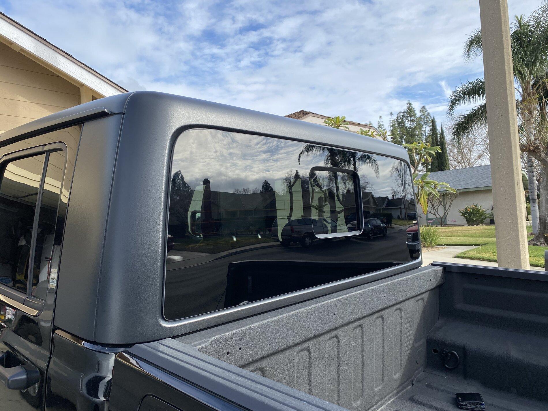

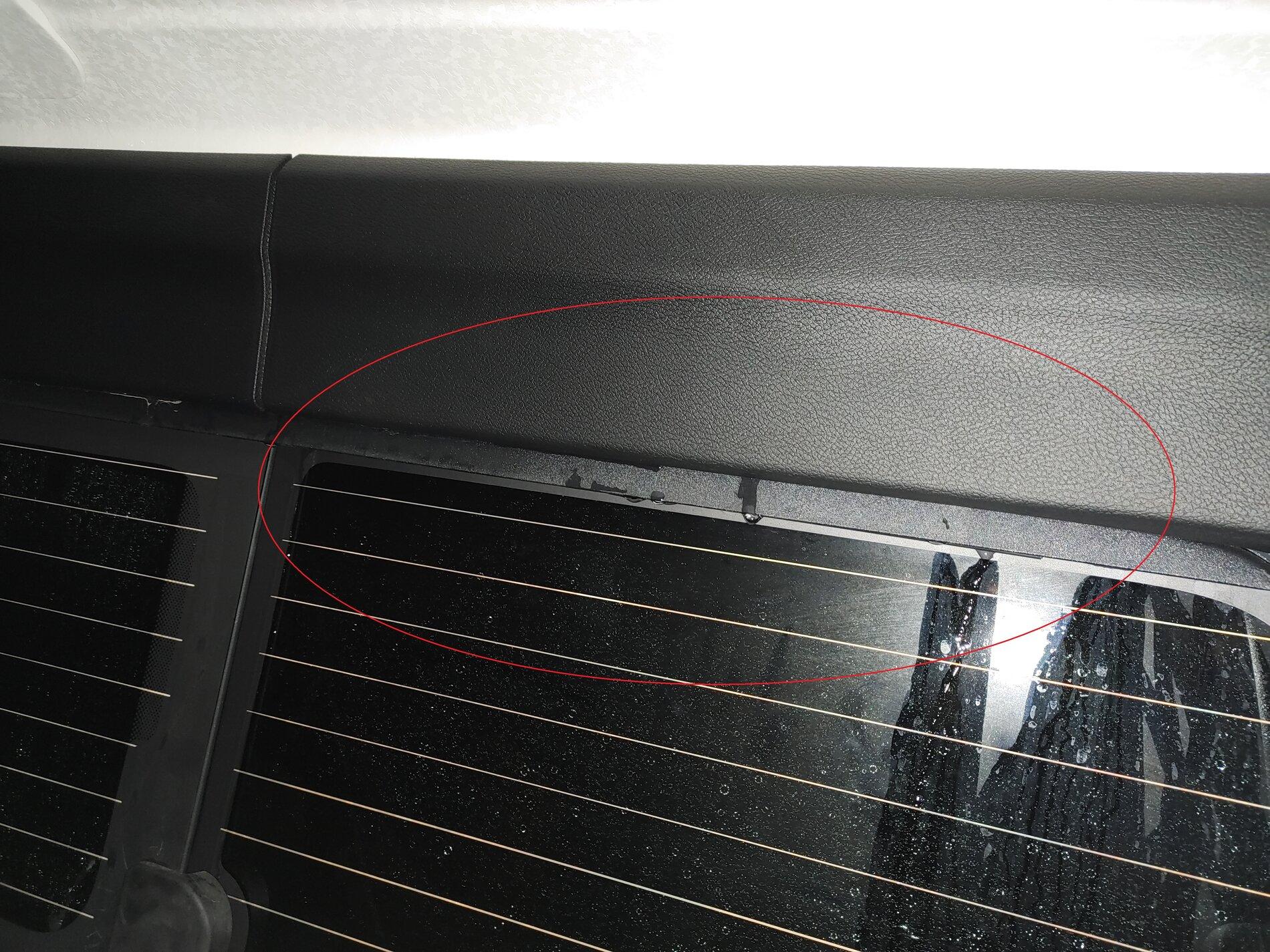

Been having this issue with my back window since the last time it rained here in SoCal. I believe that was in November. Took into the dealership and just got a hug with a circle and a have a nice day.
I learned the dealer I’ve been going to is JUNK. I also found out that all dealerships are 3rd party owned. So each one is different. I also called Jeep to press the issue but there was no luck. I was making an appointment to go to the next dealership over but I had a death in the fam and didn’t get around to it.
There’s a storm coming in this wk and I felt like I needed to do something since we are in the peak of winter. From what I’m told we’re supposed to have a ton of rain. Which doesn’t happen much here in SoCal.

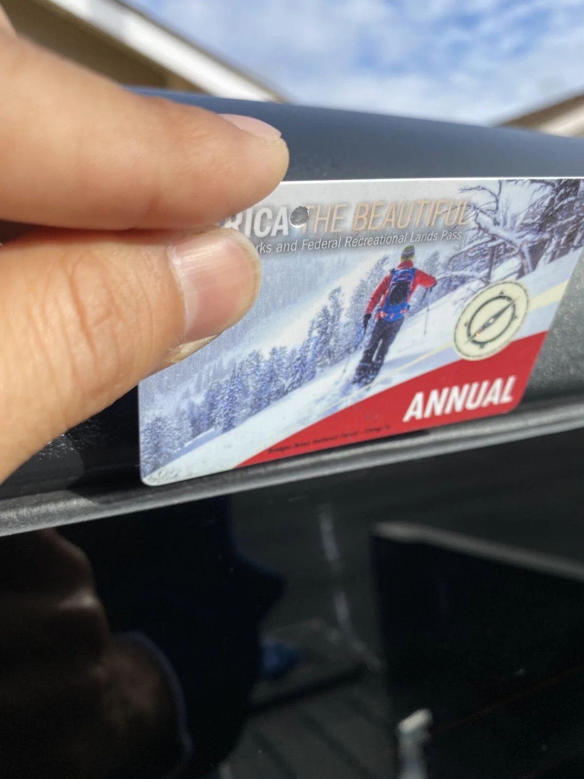

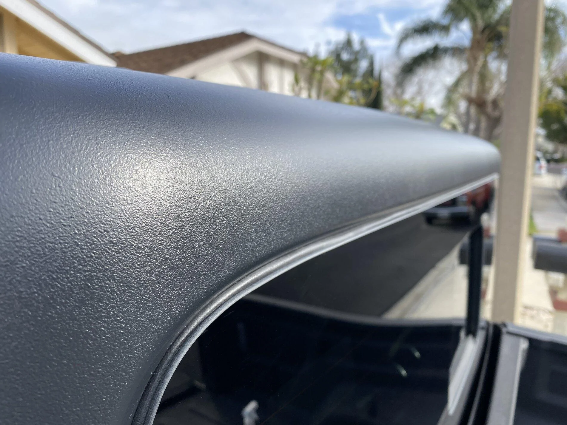

Here’s what I did....

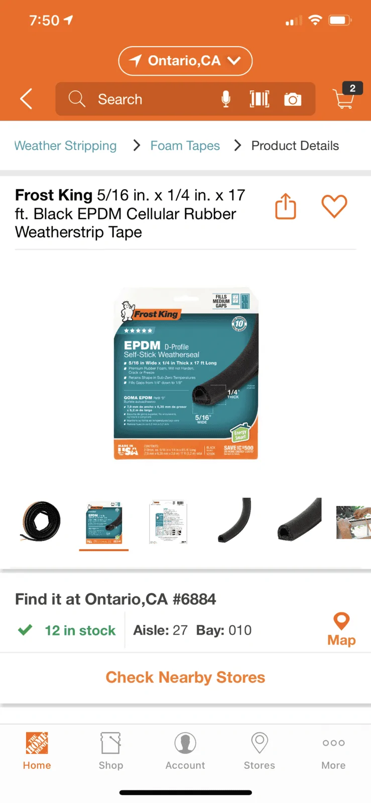

-went to homw depot and bought EPDM self stick weather seal.
- lined it up to the window. With the adhesive cover still on
-used my “America the beautiful” annual national park pass to tuck it in.

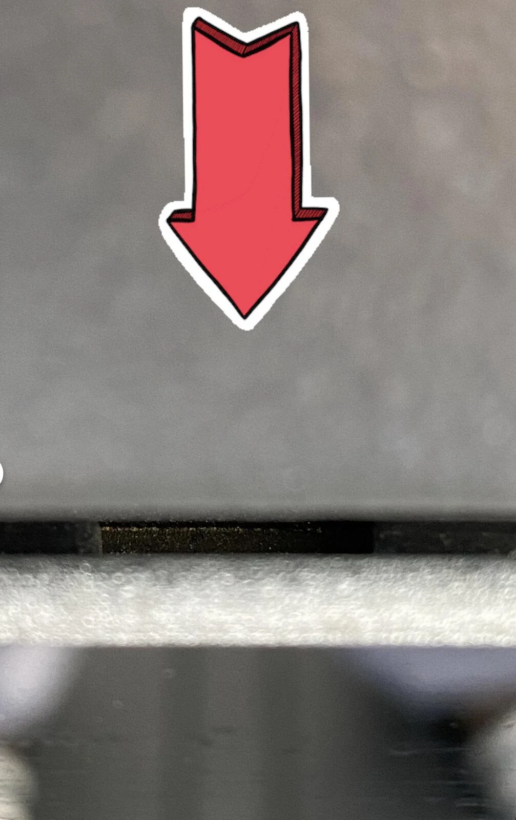

tbh- I think I only need it forthw top portion. Looks like there a short in weathering or something inside the window seal. I took a photo to show but you have to reall take a look at it to see. Anyways, I went all around window and left the bottompart of the window alone.
I’m testing today....

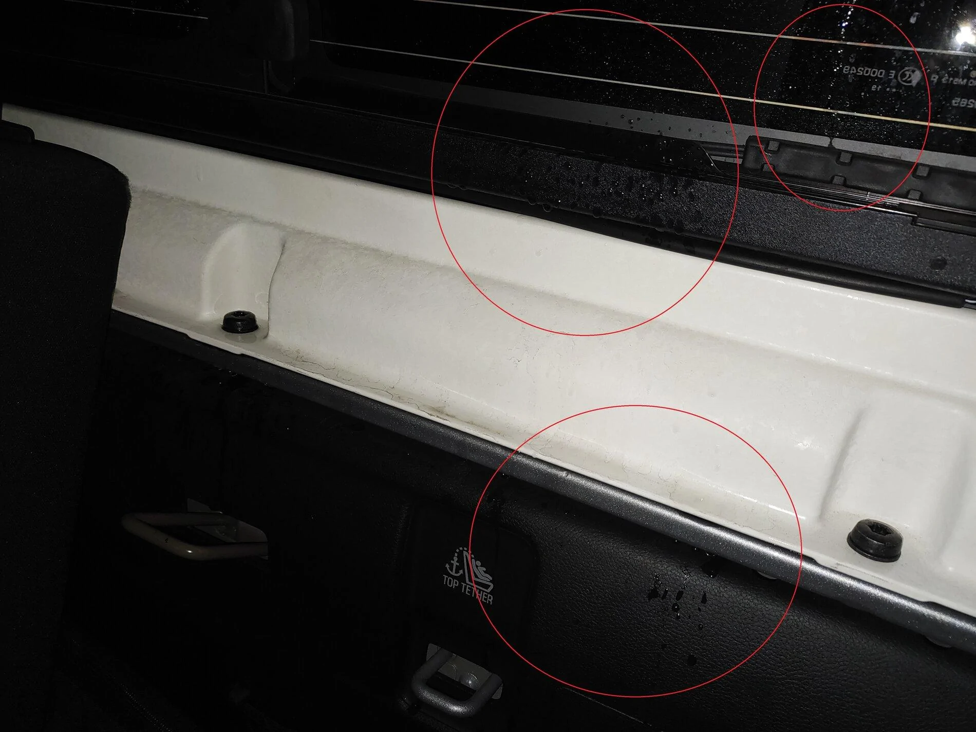

Well crap! This prompted me to ho look at mine, and sure enough it has been leaking down the inside of the rear window too...
I bet its something on the assembly line that their missing with the glass/window installers. There seems to be 2 gaskets holding the window in place. These 2 are located in each side. Dead center between the window and the roof top is where my 1st photo is taken. It is perfecting aligned as if there should be 3 gaskets. Missing the 3rd gasket in the center. That’s where I think the leak is from.
I’m still waiting for this heavy rain to see if my fix worked. What I did figure out before trying to fix anything is....
if you park in your drive way and your drive way has a small slope, have your window toward the bottom of the slop. This will help the water to run out Vs. in.
Also- I believe gladiator Rubicon are water resistant up to 30min. So as long as it’s not much leaking in, you should be good. Just annoying as hell!
Quick update-
Seems to be doing fine so far on my end. Try that fix out. If you opted in for the alpine system you have that sub I the back. That’s where all the water eventually makes its way. And in the little storage compartments back there. Here’s a photos below of mine when it was leaking....
& no it’s not because the roof wasn’t installed correctly lol. I thought that to at 1st. Then I saw actual drops come from the top.
hope this helps you like it helped me.

I’m going to try that, thanks. Yours looks a lot worse than mine, but it may be because mine is usually in the garage...

Sheeeeez! That's a lot of water. Didn't realize it was that bad. Glad you found the solution.

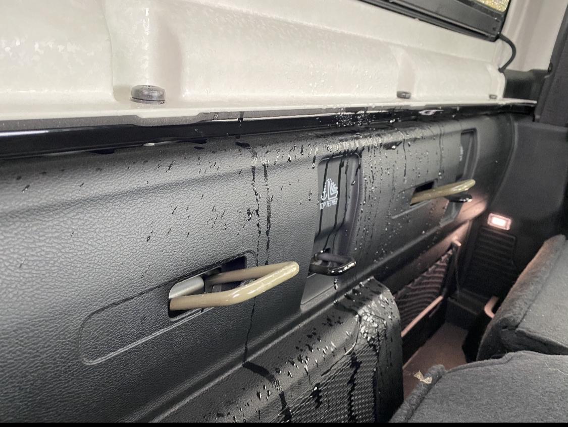

Well, crap. It's raining here in Ventura too, although lighter than everywhere else. Guess what I found in the Jeep?
Jeep Gladiator GLADIATOR BACK WINDOW LEAK 0128212338c
That’s unfortunate... I haven’t had a leak in mine since I added that weathering strip. $6 bucks for a fix and a piece of mind is worth it!
Good luck
I bought some of that yesterday, and plan to put it in today. I did notice while looking at the stock gasket that it appears to have low spots which will allow water to collect and sit. I think this is why this problem is occurring. If there was a nice arc to it, the water would probably just roll off the sides.
