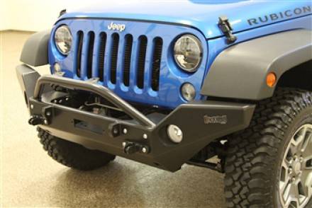

I just ordered the Rock Hard Patriot full width. bumper. I picked this one because I am going to flat tow my Jeep and I like the way to adapts to that. It was pricy. I looked for a better price on the internet, but I couldn't find a deal. I ended up ordering from Rubitrux in Boone, NC ( https://www.rubitrux.com ) because their shipping was cheapest. I talked to Dillon in the parts department at Rubitrux and he was knowledgeable and helpful.
