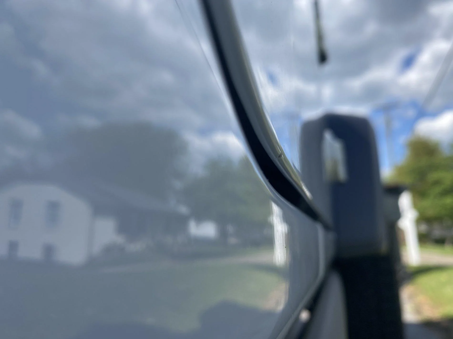

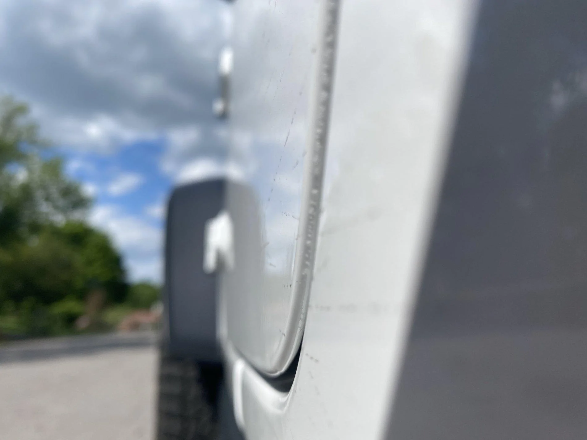

Hey everyone. I’ve had my JTR for almost 2 weeks. I noticed this morning that the passenger side front door was not flush along part of the bottom. I opened and closed multiple times, and to no effect. I thought it may be the MOPAR door sill guards, but they do not come in contact with the door or the seal, so that’s not the case. My first JK was a lemon and Chrysler bought it back due to the fact that after multiple trips, they could not get the JK to quit leaking water. Obviously, I’m concerned here. I’ve contacted Jeep Cares, and I have a case number. I’ll be taking it to a local dealer next Monday for them to look at it on the spot. Any thoughts or guidance?

Comparison shot

other updates: Now with almost 2 weeks in I’m seeing production issues
1) the gap above
2) passenger side cowl sticks out slightly and not flush
3) paint defect on lower passenger front door. I’m not sure if it’s a clear coat issue or what.
4) front passenger side headlight surround has a noticeable scratch. I noticed it right after delivery but since I didn’t point it out at delivery the dealer will not assist.
5) driver side door near top edge has a spot where a slight amount of metal is showing. It looks like it may have been done during painting as there are a couple of raised areas of paint and the small metal spots.
This is my 3rd Jeep (2 JKs prior) so I get the whole “it’s a jeep thing”, but at 50k it’s hard to argue quality control. I know things get passed people. I drove it for almost 2 weeks before noticing most of these things. Once I noticed the passenger door being misaligned I started inspecting everything more, and am finding one issue after the other. Let’s hope Jeep steps up.

I hate to be that guy but... I think you're nitpicking
As for the doors they're adjustable via the hinges, a quick search should help you find this. Maybe not necessarily here but other wrangler forums.
While yes they are are adjustable, as I know from previous Wranglers, they should be correct from the factory. Due to a previous bad experience with a new wrangler, I need FCA to know they came this way in case it causes issues down the road. The wrangler I’m speaking of could never get its doors aligned, and because of that had a massive leak form.

Just an update. I took the Gladiator to a local dealer today for pictures and a look over. We found that the seal on the rear passenger door window is rolling out and the foam is exposed, so less than 3 weeks old and a seal is failing. The dealer said they’d never seen that particular issue. The other issues were documented. Also, along the bottom of the driver door edge (who ever looks there) an area was found that was silver and rough. The silver area was raised above the paint, so it’s not damage from opening and closing onto something. Seriously FCA, any quality control? I love this truck, and that’s why it’s so frustrating.

Definitely. I build cars for a living and was at various times responsible for door fit and entry seals. Door fit is something that's checked in the final stage of production, adjustments are made when required since there will always be an off fit now and then. Generally, the striker (the metal plate bolted to the door frame) has play built in to allow the door to close inwards or outwards depending on fit.
Every car has alot of hands working on it, which is why like you said QC is a requirement to verify everything is how it should be. Anomalies exist however but in those cases, problems should be addressed.
