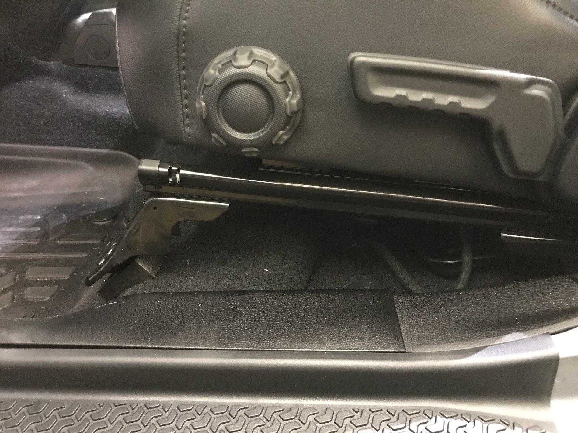

I have short legs and I found that I could not get enough tilt on the seat bottom to not feel like I was sliding out of the seat. So I went and bought two large nuts, about 1/2" thick and unbolted the front seat bolts and put them under the rail. Now I have a bit of tilt to the seat.
The problem I ran into was as I raised the seat, the front did not rise as fast - say half an inch for every inch the back went up. So after raising it a bit I ended up with what felt like a downward slope and I felt like I was going to slide off the seat. And this is on my Wrangler - which will be the same in the Gladiator.
Can you post a picture. That could be helpful idea to me. Thx
Exactly what i did. Made a world of difference for me.

Auto is jacked up as well this Jeep has the worst seating angle of the many vehicles I have owned! 6’ tall 34” inseam and sliding forward all the time! Fixing this was my first mod!
What did you do?

What did you do?
Purchased the spacer block kit made to lift the seat front and back and only used the front blocks. This involved using new bolts with a smaller shoulder (front) and ever so slightly slotting the rear seat holes so bolts holes would line up. Tried the washer thing first and it just wasn’t high enough ( still tipping forward). All the best
