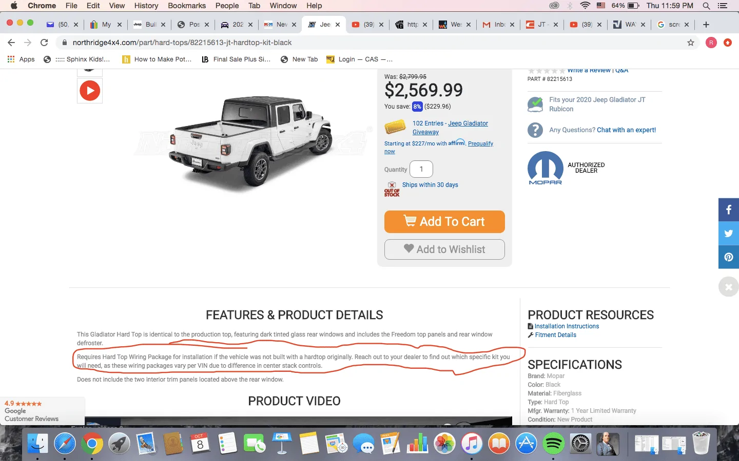

Does the wiring for the hard top still come with soft top only builds? Salesman says it wont be there and Northridge 4x4s website says you need the wiring also if you only had soft top(See screenshot below). But, I've seen a few say they had the wiring already in place with their soft tops, someone said it's only included with all Rubi & overland models soft and one even had the wiring show on the build sheet? So, I'm confused...

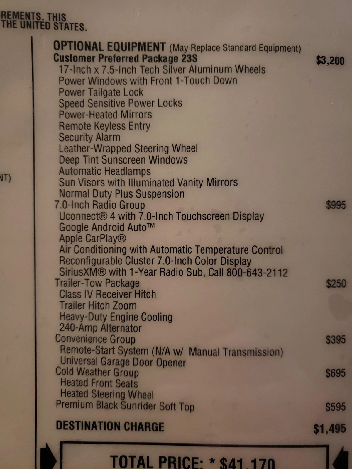

My 20 Sport S was a factory Soft top. I just traded for a hard top. Wiring was in fact there for the rear defrost.
However, there are brackets that are needed for the front and rear freedom panels to lock into.
The options I have.
23S Customer preferrred
7 inch radio group
Convenience group
Cold weather package

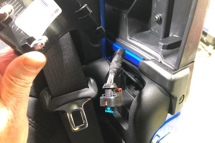

My build sheet had the hardtop parts module listed on it, even though it came from the factory with the premium soft top. Once you get your Jeep you can pop the rear cover to see if the defroster wiring is there. If it is, you will also already have the rear defrost button with your climate controls. If you buy the hardtop shown above, it comes with the brackets. You can see them listed in the installation instructions. However, it doesn’t come with the interior trim panels. I bought those from Northridge. You can also buy the freedom top storage bag and/or a headliner from various places, if you want all of the options

I have a 2021 base sport and I don't see the end of any plug sticking out at back drivers side( I guess it's possible it's tucked down behind panel). Plus check pricing at local dealers on tops.
There is a little cover that snaps off, the wire is behind that.
Shown right about the 1:35 mark.

Ah, you are correct. Yes I have the wire. My build has 4 options, upcharge paint, automatic, max tow package, and factory tinted windows.

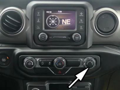

@NACLS6, there seems to be a difference whether it is a Sport or Sport S model. Possibly the stripped down base Sport models don't have the wiring and the Sport S models do. All the Sport S models I've seen have the wiring. Haven't seen a base Sport model yet.
The easiest way to tell in person is whether the Gladiator has the defrost button on the climate controls. If it does, it should have the defroster wiring in the back.
