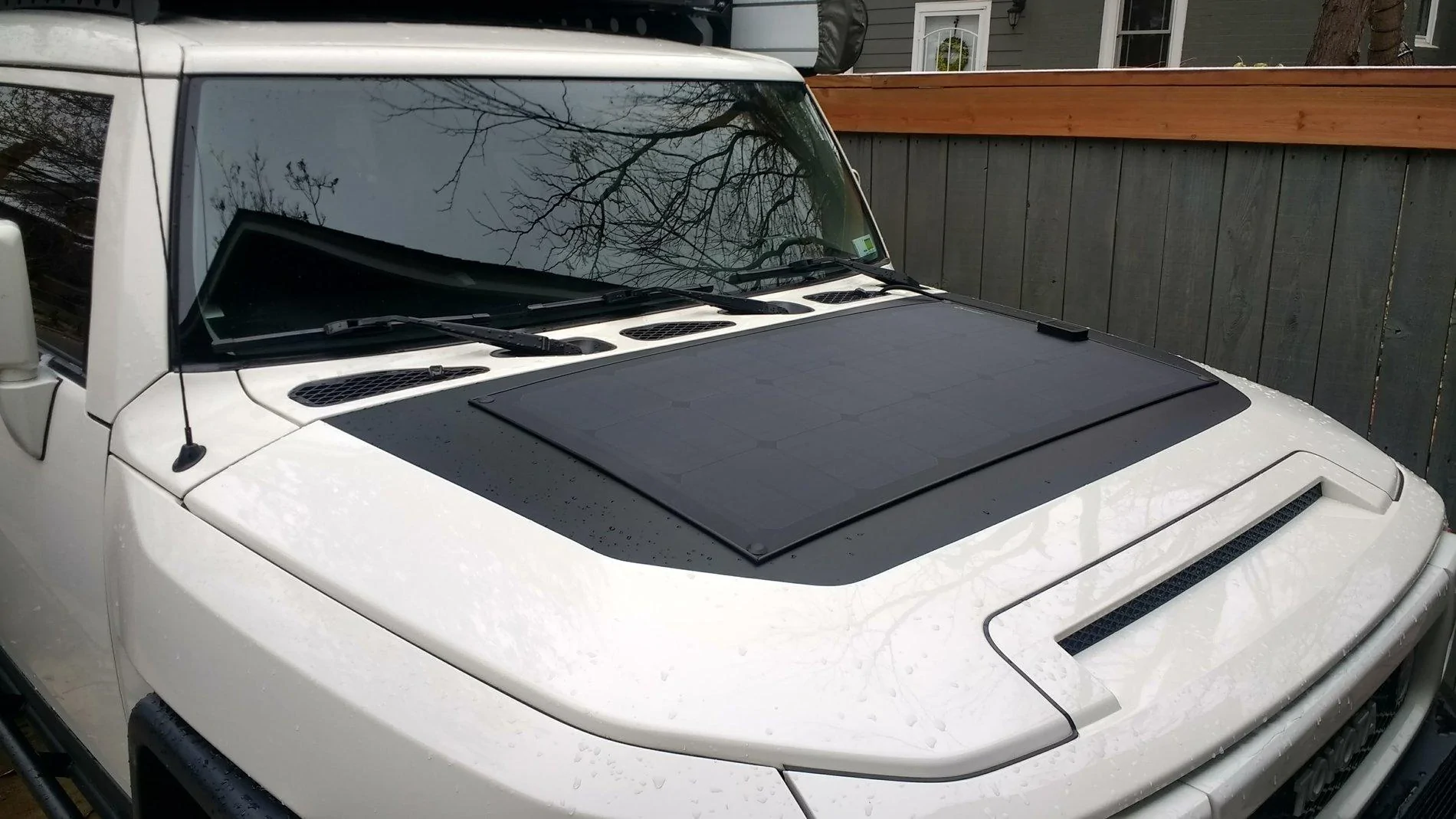

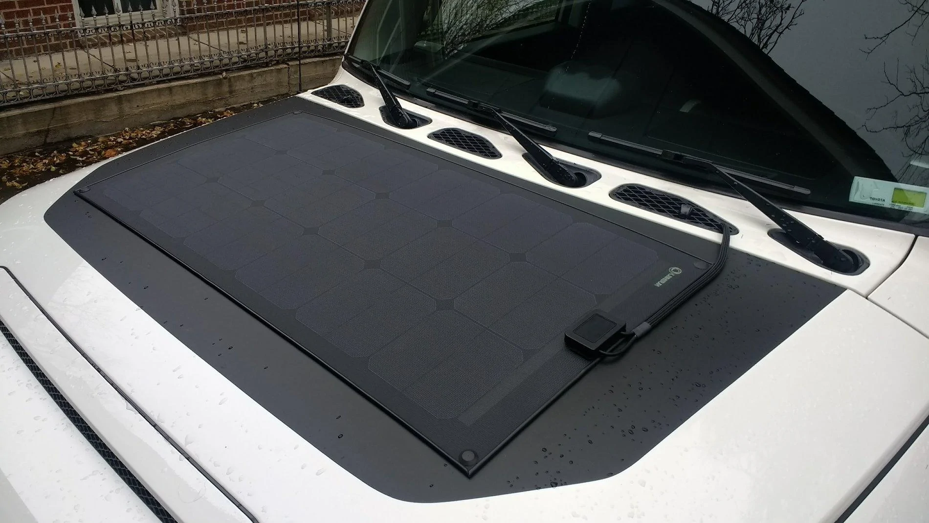

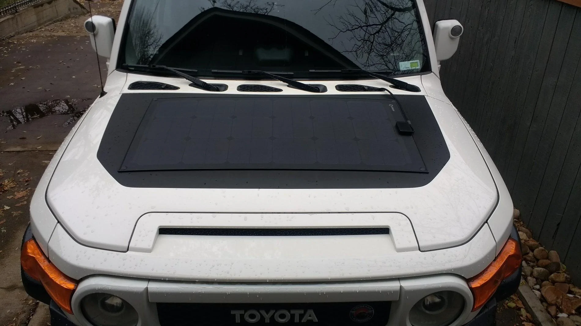

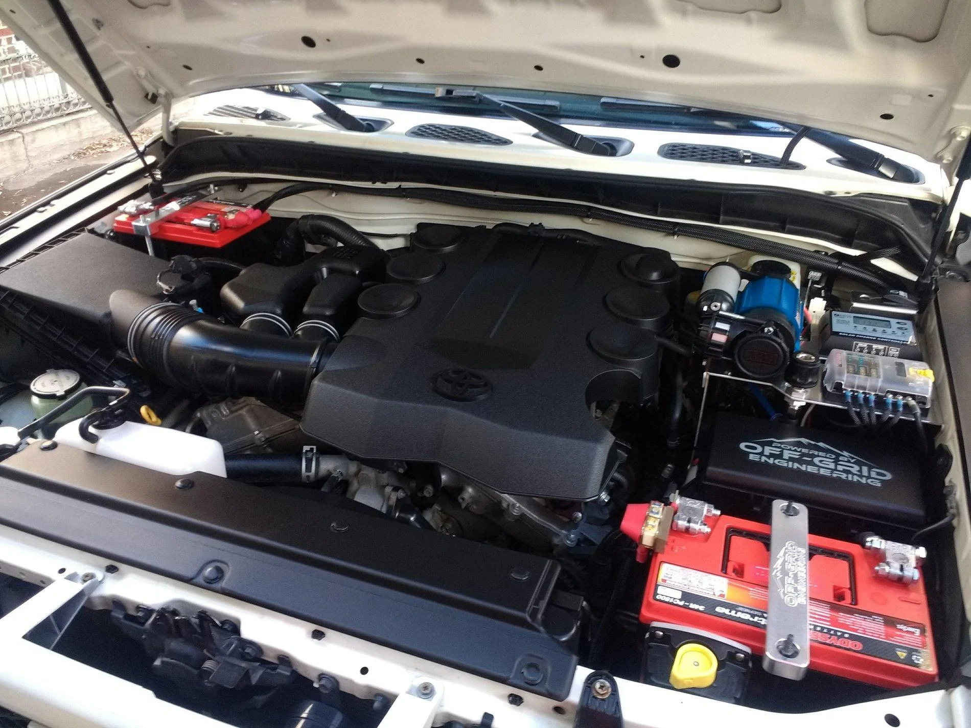

Hey everyone, I didn't know about Cascadia 4x4's version so thanks for the post. We just got our JTR a couple months ago but prior to this I've been running hood solar on my FJ Cruiser for about 3 years and found it invaluable for keeping my dual batteries topped off and ARB fridge running all year round. Yes, there are instances where shade in not your friend with a hard mounted solar panel, but we do a lot of trips in CO and UT where we are fully exposed for days on end and the panel really works well. Some of the guys also carried a portable flexible panel to plug in as well (using a Redarc DC/DC w/ solar)
Juniper Overland here in CO installs a bunch of hood solar panels and I plan on going there for another install on the JTR. Heck, even in my driveway the panel would consistently top off my batteries. I am reaching out to Lensun to see if they have a custom panel in the works as 30W is just a touch small... 50W seems to be the minimum that a lot of Tacoma and GX guys/gals run out here. My old FJ panel was 80W fyi.

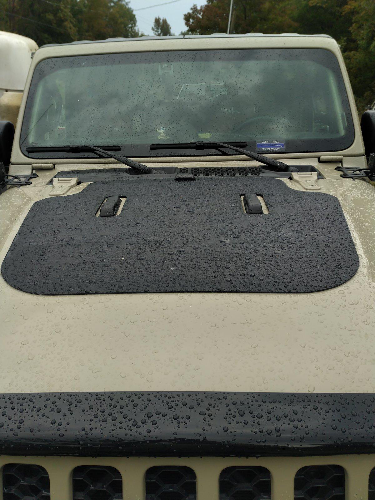

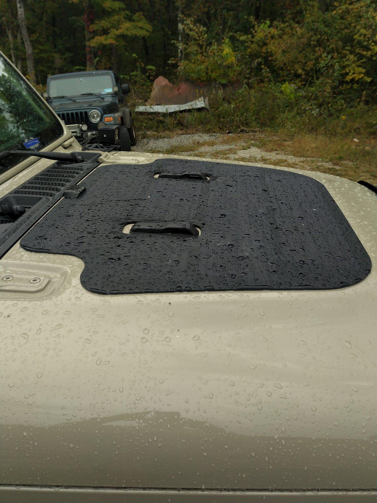

A update on their 80 w Non-Rubicon one. It was not a fast delivery. I got it in on Tuesday. Then luckily had good weather for last 2 days.... My off days and got it installed. I skipped getting the clear film "patch" I had about 2.5 ft of 6in film that I used.
First thoughts on it....
1. Expensive but complete and good instructions. note: I had to email company to find out status of my order, after I did I got update(s) on it
2. It would be better to include 2 more 3M adhesive accelerate wipes and second strip of 3M tape on front edge.
3. Something to think about for install further down hood it will block windshield washer spray nozzles but you can lay hood on windshield vs the panel controller hits cowl if paid back on windshield. "A shift of box forward on it about 2-4 cm would eliminate the issue plus might stress cable less that way."
4. Cable ends up needing to do 180° bend. Over edge of hood and in to engine compartment. Might be problem in future.
5. Install instructions was good. If you can't follow them or figure it out... Best bet.... Contract the job out.
6. Battery lead wire is long enough to get started to hooking up dual battery setup.
7. I seen charging of battery as soon as connection was made, and Jeep was charging from panel when I was driving still. :like:
** Later planning to run wire from it's charge control box to power fridge freezer in Jeep, and to charge secondary battery I'm planning to install. Still thinking about installing of solar panel(s) on hardtop?
