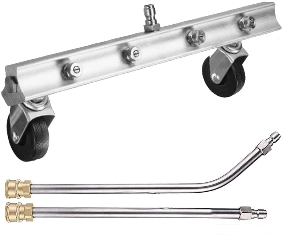

Have a power washer ? $30 from Amazon will get you one of these
Jeep Gladiator Gladiator Maintenance - Undercarriage Washing; How Necessary Is It? 2E3E817B-B1CA-4A33-9F34-D067692EA161
I actually do! That seems like a genius product.
Do I just run it on the undercarriage, hitting all the areas I can? Oh, important question - are there any parts I'm not suppose to use a pressure washer, or this attachment, on? (As in sensitive parts that may be damaged by a pressure washer.)

IMO, a pressure washer is good at pushing salty water/sand/debris into places it would not normally get, and places you don't necessarily want it to be. I recommend a relatively low pressure flush.
I wash out the undercarriage and fenderwells of my Jeep JK a lot - almost every time I go wheeling - to get mud & debris off. I have found that a multi-pattern watering wand is the best tool for this (FYI my house water pressure is 50-60psi). I like the telescoping type, and they are only about $20. The design lets you wash down from all angles and reach into tight spaces instead of just spraying water up from underneath. You can gently flush areas like brakes and the insides of the wheels with the shower pattern, while you can use the more aggressive fan pattern for the fenderwells. The jet pattern is good for flushing out the LCA and shock mount areas. And you can reach all these areas without crawling under the Jeep, or worrying about damaging something or forcing water & debris into places it shouldn't be.

just a few passes with it is good, don’t super hose everything and it will be fine. I wash off my motor each wash with no problems. Some have problems with this, I’ve never had a issue.
now I don’t understand the pushing stuff into cracks comments. You don’t think driving it wet weather for hours doesn’t do this??? Most on here won’t own their vehicles long enough for rust to form. A quick blast with a under washer will do more good than harm. A consumer based power washer spread between 4 to 5 nozzles really knocks down the pressure anyway.
pick which advise you would like, I’ve used a pressure washer attachment for around ten years and love it.
Oh, okay. I was concerned I wasn't to wash with the jets pointing upwards on the undercarriage around the engine; I was worried of damaging sensitive parts.
