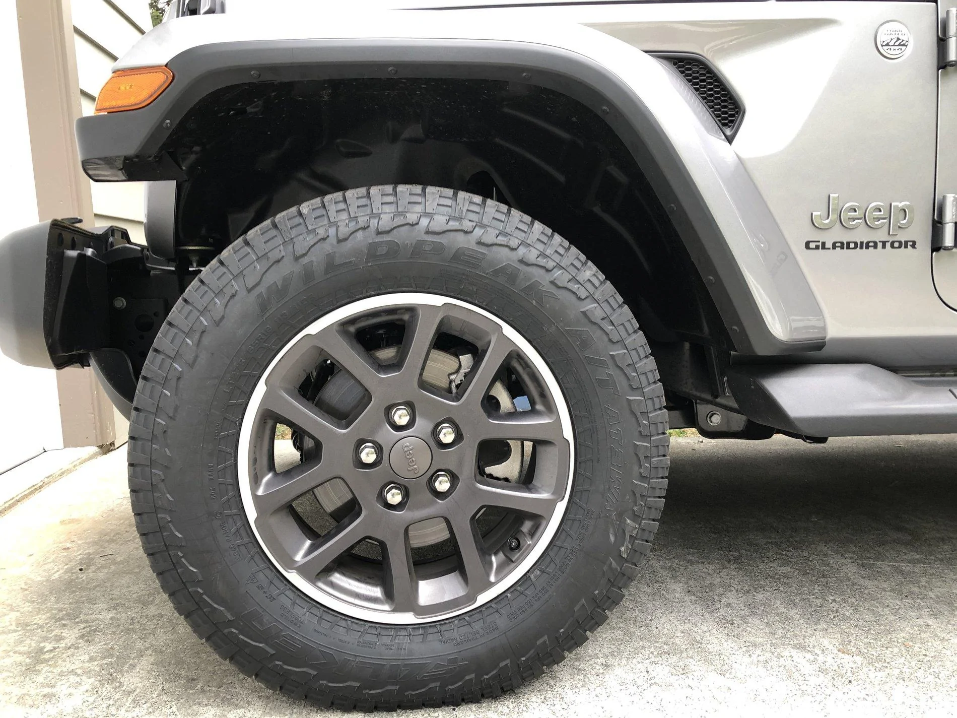

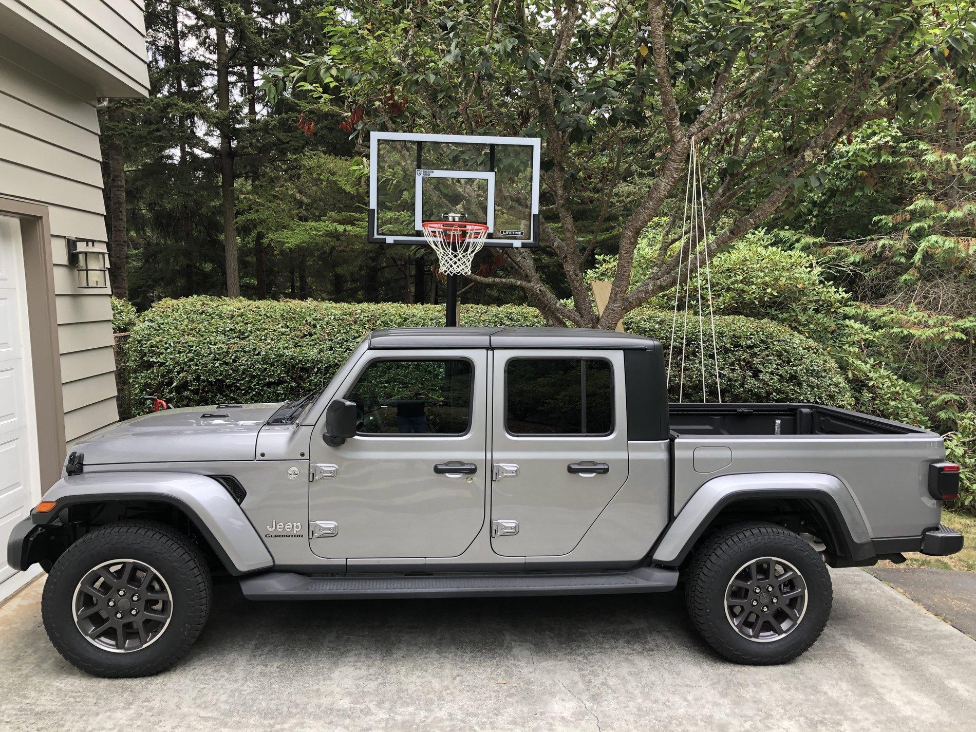

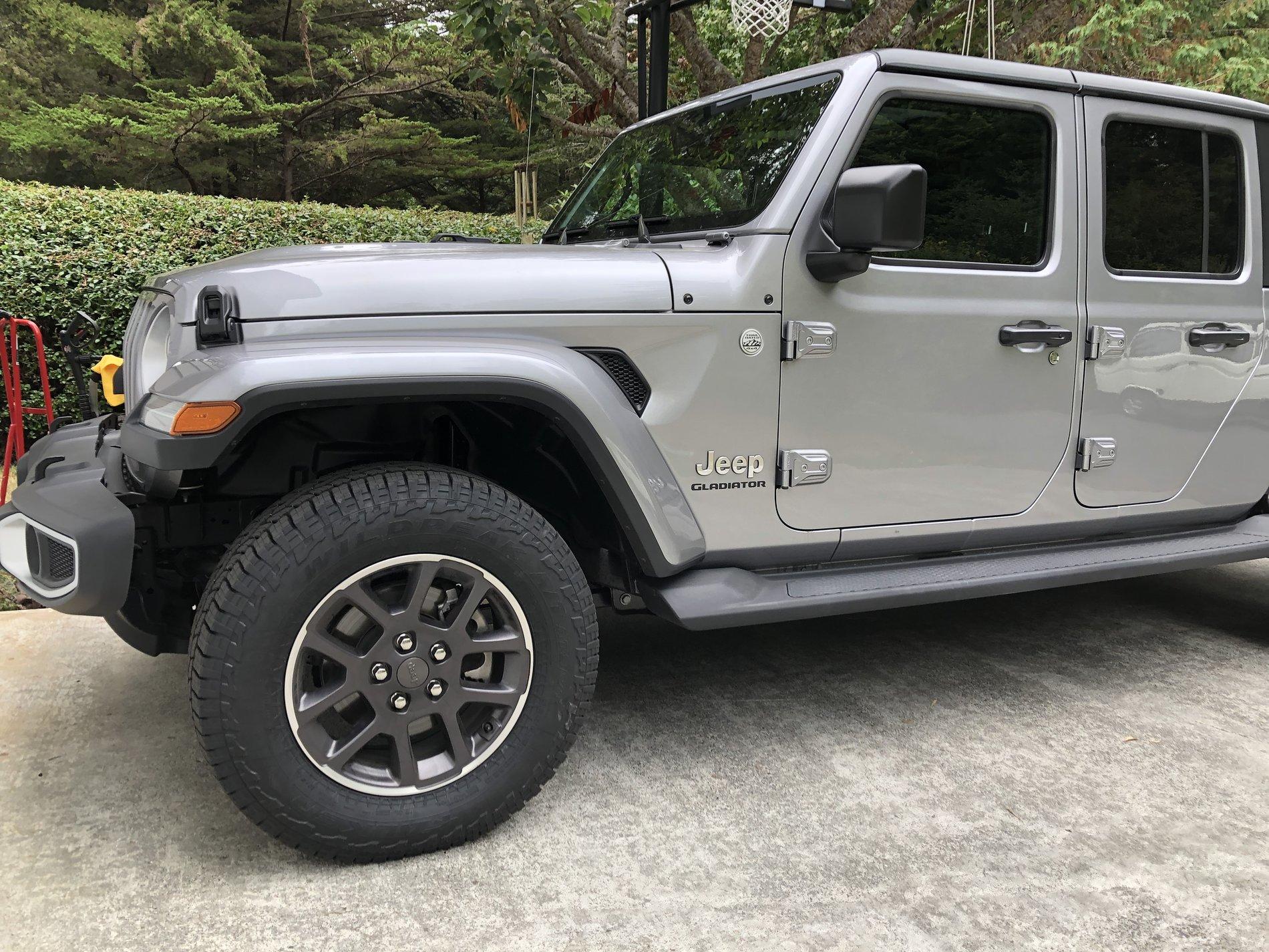

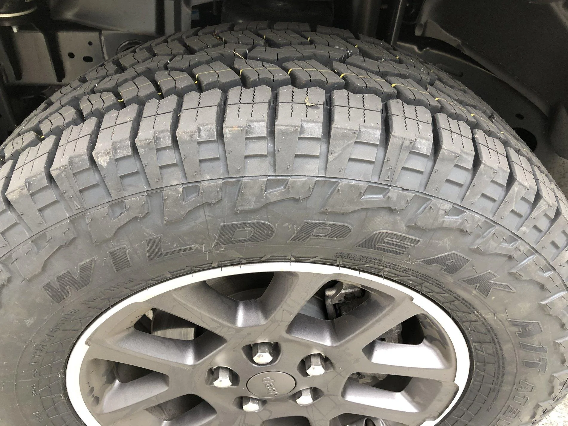

I installed a set of 275/65/18 Falken Wildpeak A/T AT3wa (C rated) on my OEM 18" Overland wheels. Same diameter and same sidewall height as OEM 255/70/18 tires just wider. No speedometer adjustment needed.
So far so good. Nice and quiet on the road. I’ll report back after a few thousand miles.
The set of 4 Falken tires was about $950 inc tax, mount, etc. I posted my set of 4 OEM 255/70/18 Bridgestone Dueller H/T 685 “street tires” with 1275 miles on Craigslist for $500 and sold them in 1 day. I kept the Bridgestone Dueller 18” spare as it is the same diameter (32.1”) as the new Falkens.
Might be cheaper to buy someone's 17" JTR take-offs with the same tire, but don't forget to buy all 5 (inc spare 17") if you go that route.

PS - Part of the reason I went with these Falkens is that the 275/65/18 is C rated. BFG TKOs in the same size are D rated and several members here warned about D and E rated tires being "too harsh". Again, 17" wheels give you much greater tire choices that 18" (including C rated BFG TKOs).

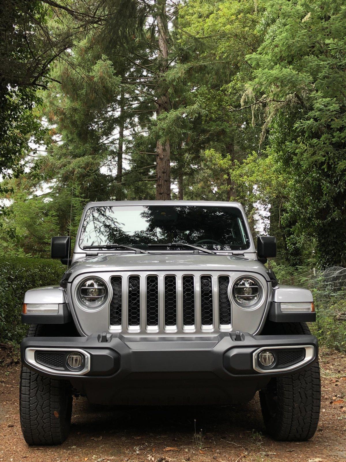

Can you post a pic from the rear , showing how wide they are and stance.
