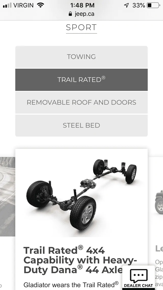

Just looked on the jeep Canada site and it looks like the sport comes with Dana 44s on it. This could be crazy.

I think the Official Press Release Thread said 44s, but with 3.73 gears. I think.

Dana 44's are standard on all models but the Sport can get the optional max tow package which upgrades the axles to wide track Dana 44's and 4.10's along with some other goodies (cooling, etc.). Very cool!

Standard D44s front and rear with standard 3.73s?? This is HUGE!!
