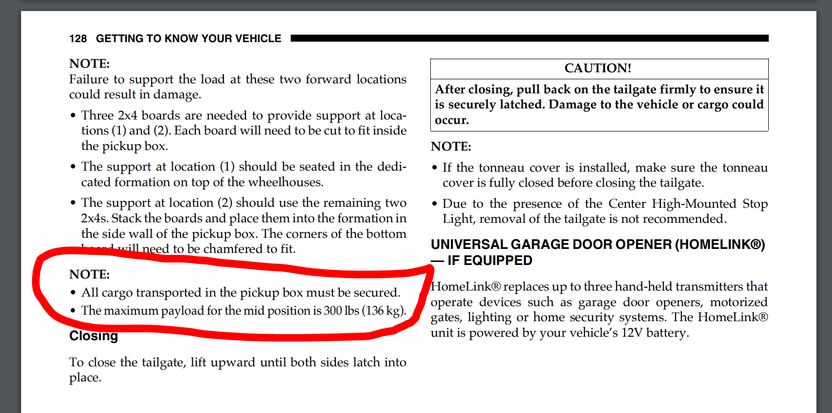

Well the JT manual says we can only put 300lbs weight on the tailgate at half position. So we still have a possible bed problem!
Even 1/4" plywood weighs about 22 lbs per sheet, at 19 sheets that's, 418lbs......hey @JeepCares , which is it, 418lbs or 300lbs? Is Engineering right, or is Marketing right? Or did Marketing not take the engineer's numbers correctly?
i'll post the manual in a sec. https://www.jeepgladiatorforum.com/forum/threads/gladiator-owners-manual-download-in-pdf.15679/

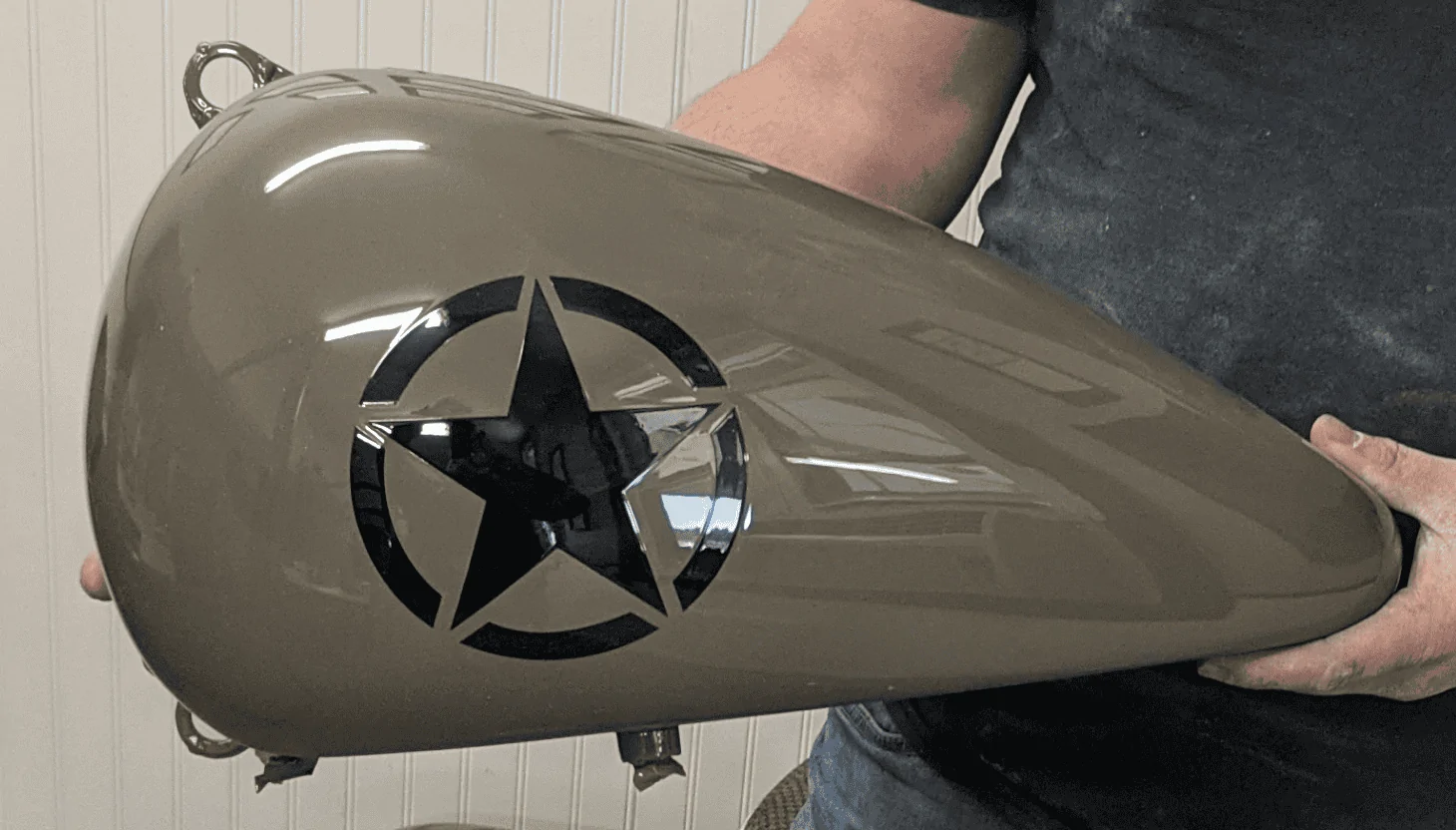

My 97 flstf is getting new gator paint but when it's done, I'm taking it on a couple of 600mi trips in back. I found some great ramps (see link) and they're coming next week. I was originally worried about tailgate weight, both for (A) loading and (B) road bumps in travel. To manage those concerns, I have a couple ideas, and I think they're good ones, but I'm hoping for some confirmation or warnings. For loading, I'm thinking of just putting a 2x6 across the gate between the ramp and gate, to better distribute weight of the ramp/prevent possible taco-ing. I realize the 2x6 will likely be pinned under the tire but it won't matter, because I plan to scissor jack the frame, 6" from the edge of bed - leaving enough room to chock-up the frame, remove the board & ramp (for loading before tie-downs), and barely resting (if at all) on the tailgate. I hope to have pics of all this when it all comes home next week.
Softail bike ramps: https://www.amazon.com/dp/B00EV2EALS
cheap jack: https://www.amazon.com/dp/B07F851KGD

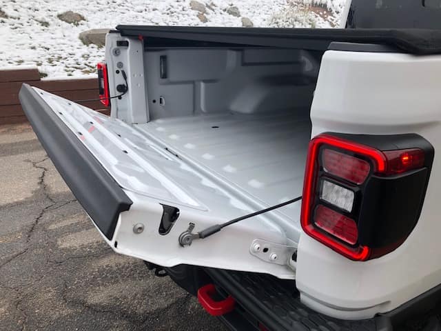

I'm still wondering WTF is the middle position? Mine is either all the way up or all the way down. Please edjumcate me.
4xjeepr
DON
Aug 30, 2020
788
1,200
Thomasville, NC
20 Gladiator Sport, 06 Wrangler Unlimited Rubicon, 95 Wrangler Rio Grande
Middle position is when you use the cables on both side of the tailgate to position gate half way down. There are black brackets down the side of the tailgate recess where you hook the cables to have the tailgate partially down.
