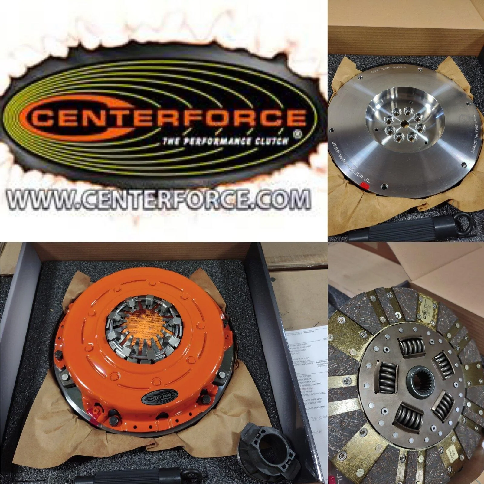

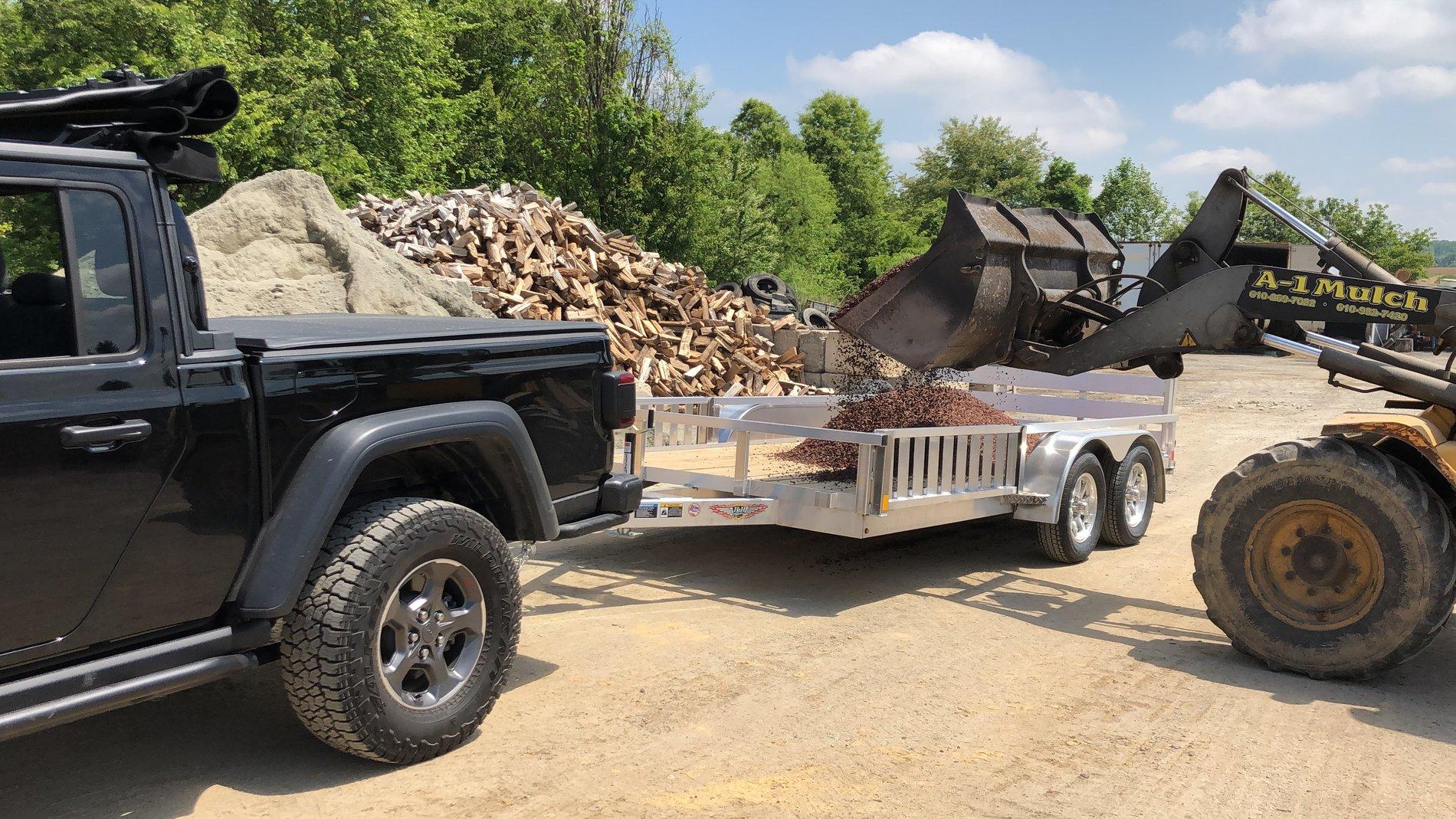

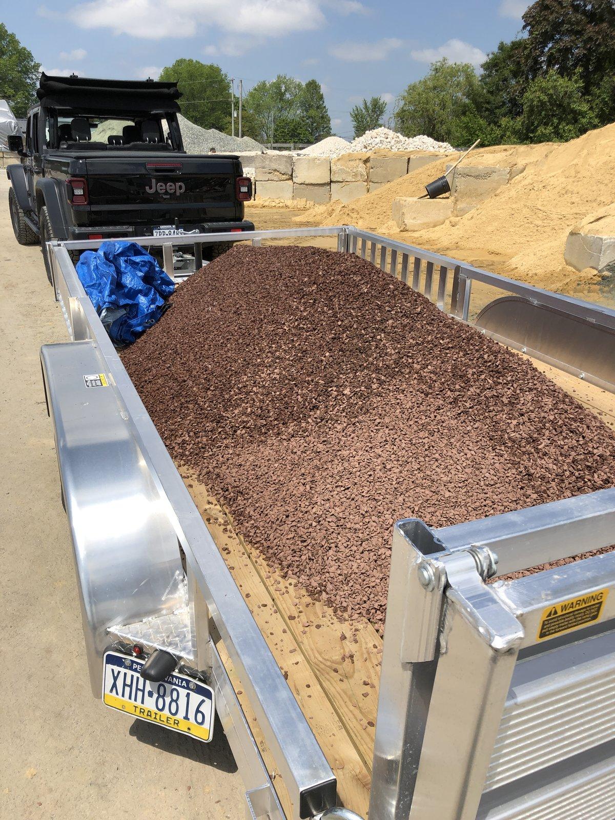

Towed about 5500 lbs (2 tons of stone on my 7x14double axle trailer that weighs 1500lbs) and it was ok. Mostly flat and pretty short distance. Definitely know it was back there but not a big deal. I think 7k might be a stretch with the stock clutch. Maybe occasionally on flat terrain. I’m going to a Centerforce clutch and I’ll be routinely towing 4500lbs. Not worried at all. Will provide an update once the clutch upgrade is all planned.

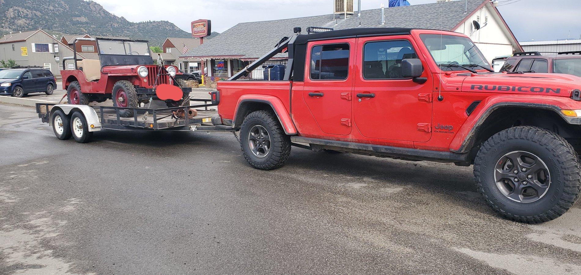

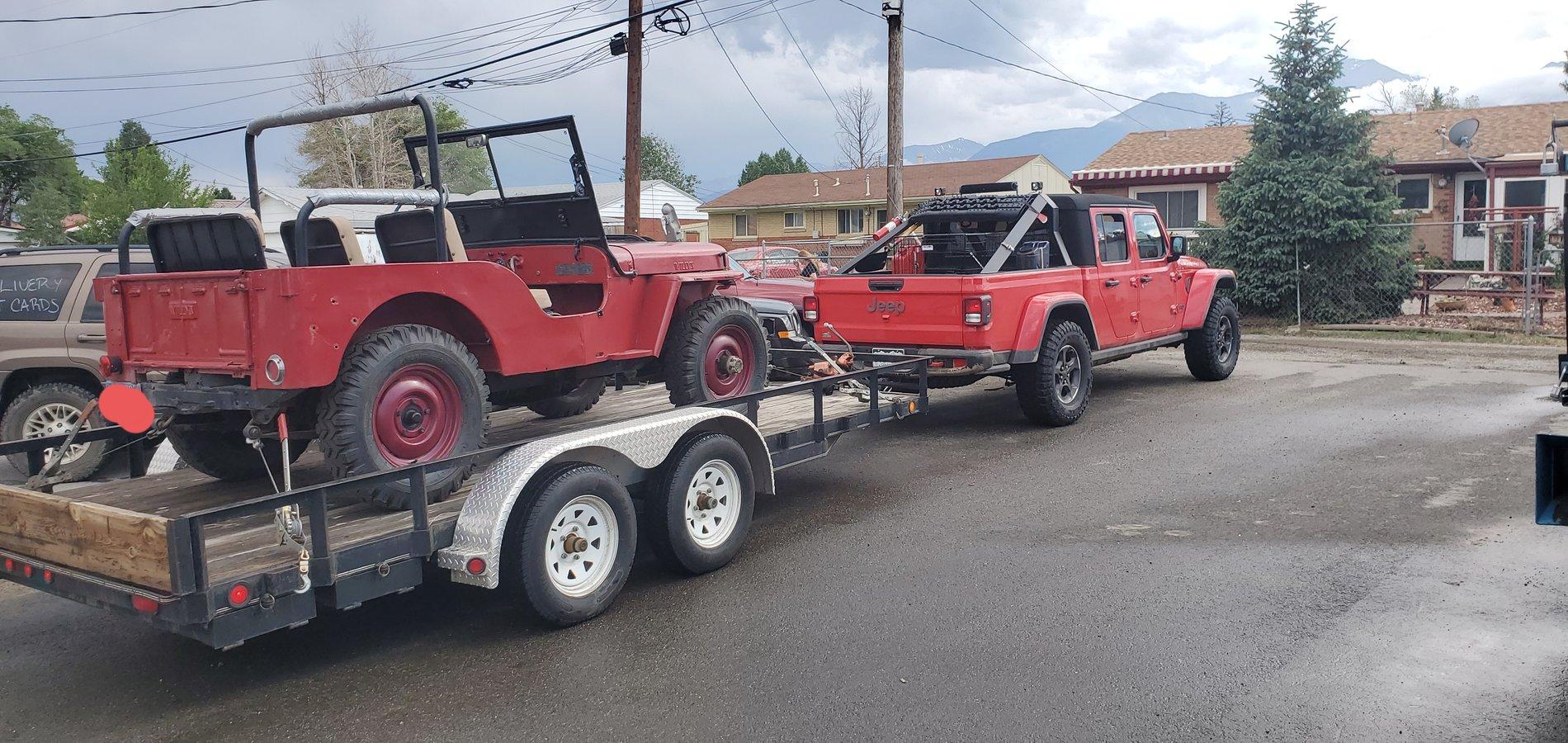

First tow with the 35's(all stock other than the tires)... about 4k lbs, it wasn't the worst I guess. Did this same tow with the the stock setup, it was better, but not by much. Second and 3rd are my new friends while 5th and sixth are now total ex-girlfriends . Pretty wimpy up all Colorado hwy passes.
