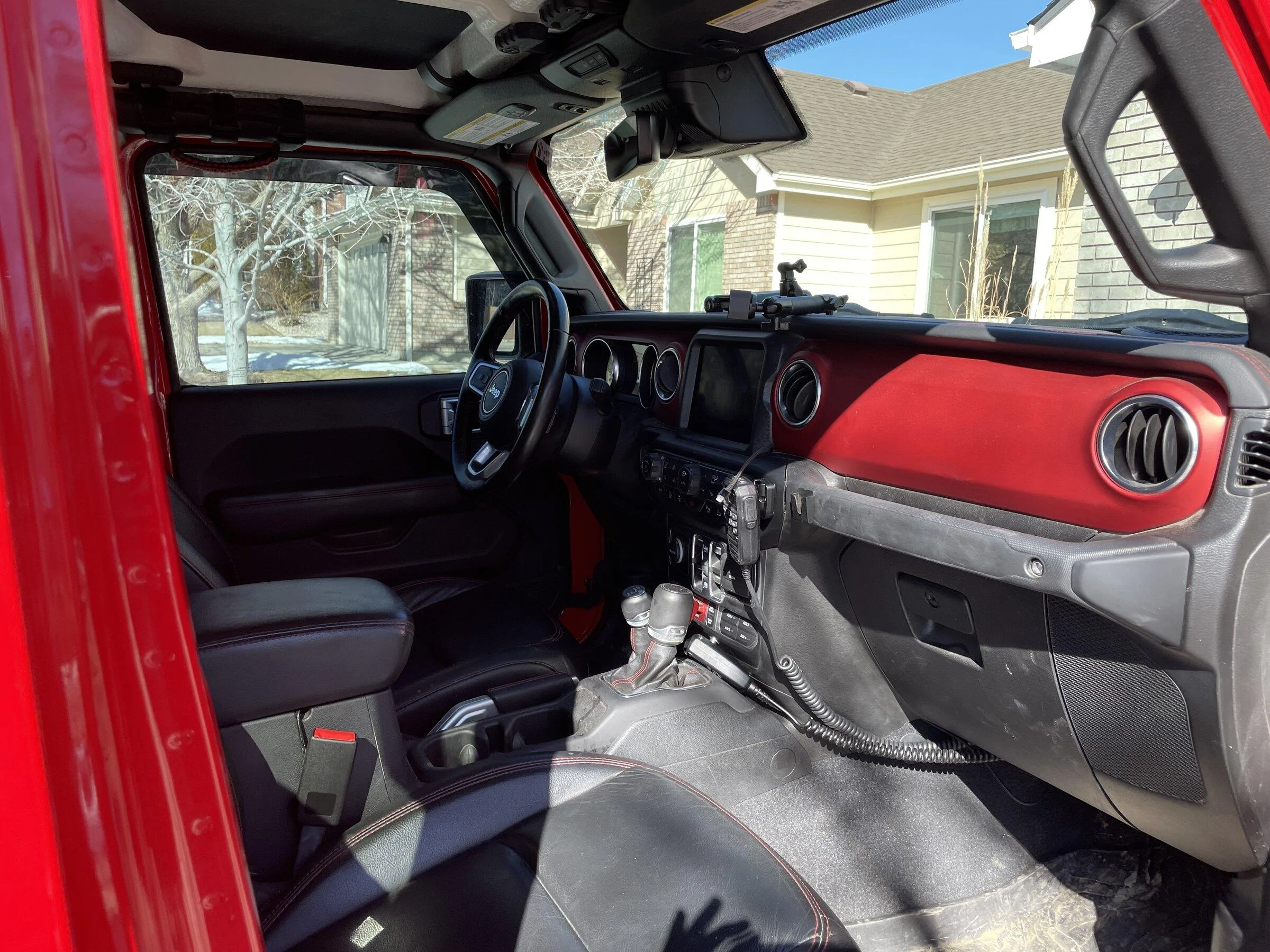

I have two amateur radios under the rear seats, not mounted and just sitting in there. One is a Yaesu FTM400DR and the other is an Icom 706MKIIG. The control heads are on a RAM swivel mount sticking out the front of the center console. I ran 4ga wire from the battery down into the frame then out under the rear seats where there are some plastic grommet things you can pass the wire through including antenna cables.

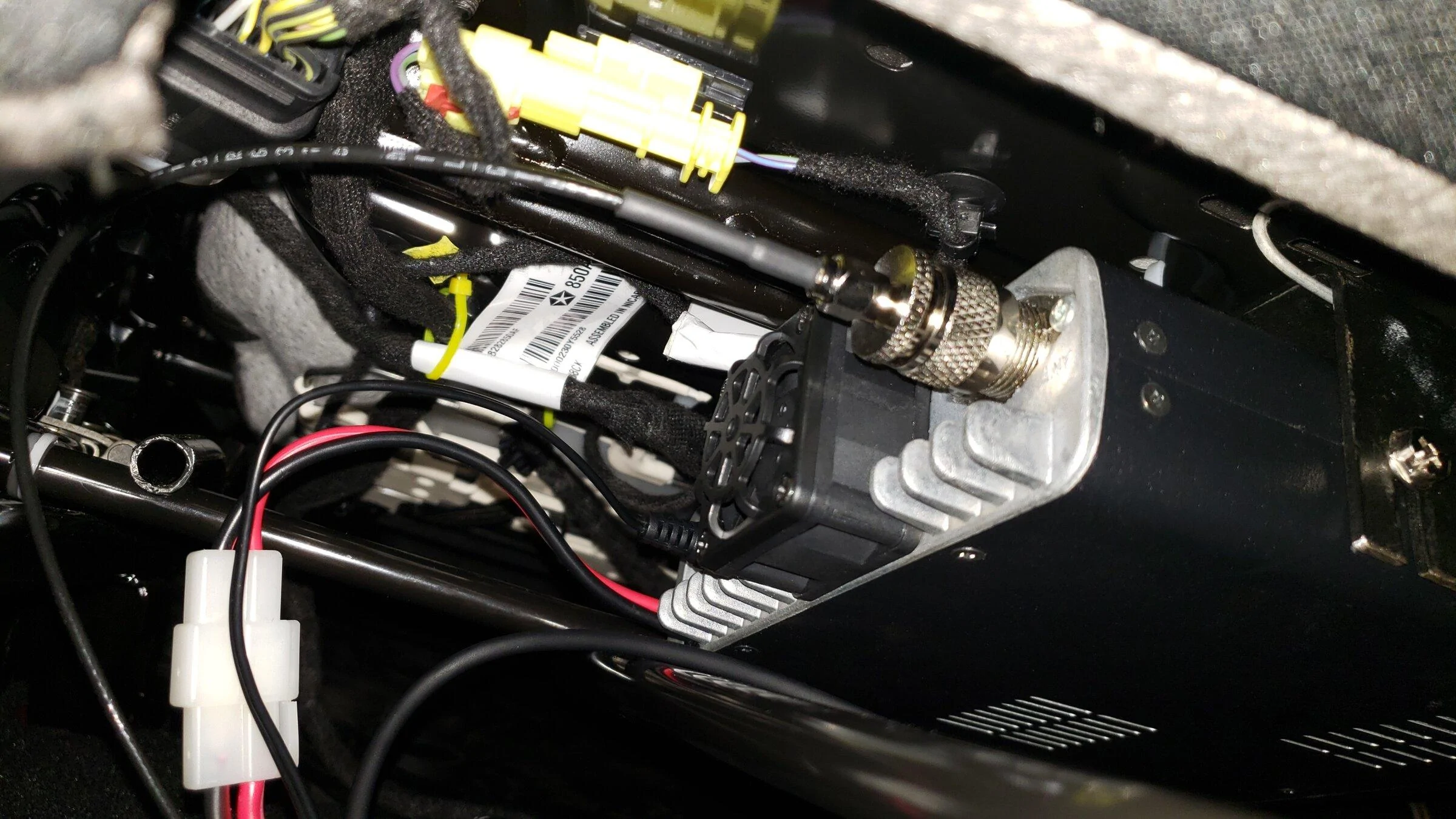

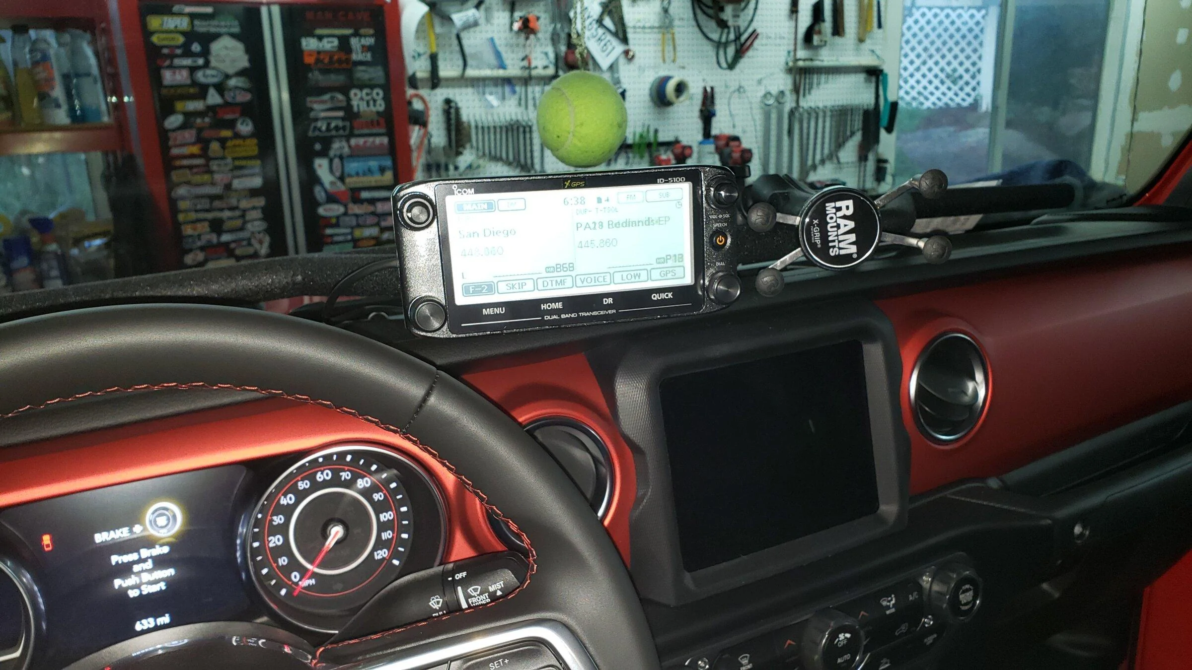

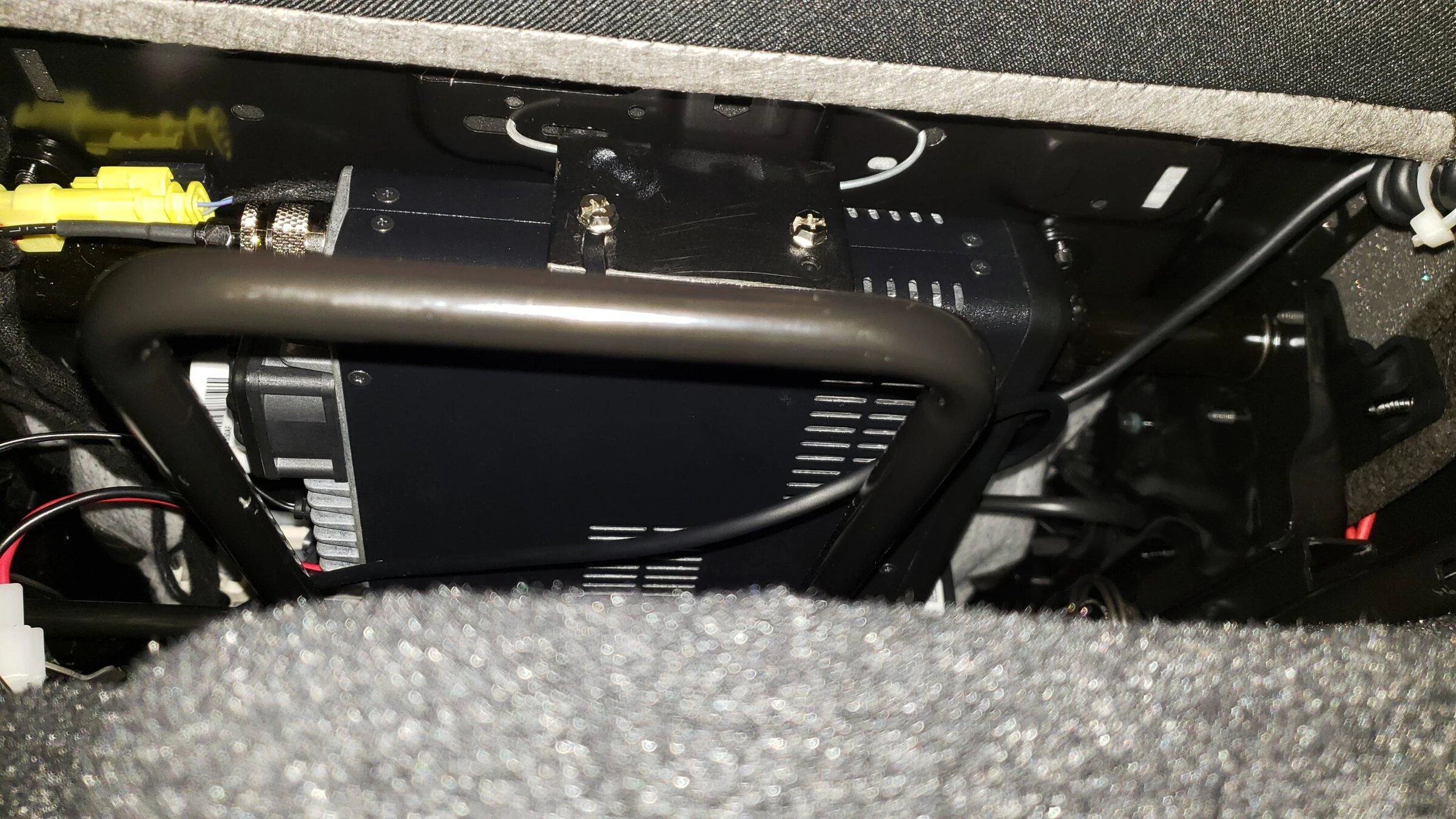

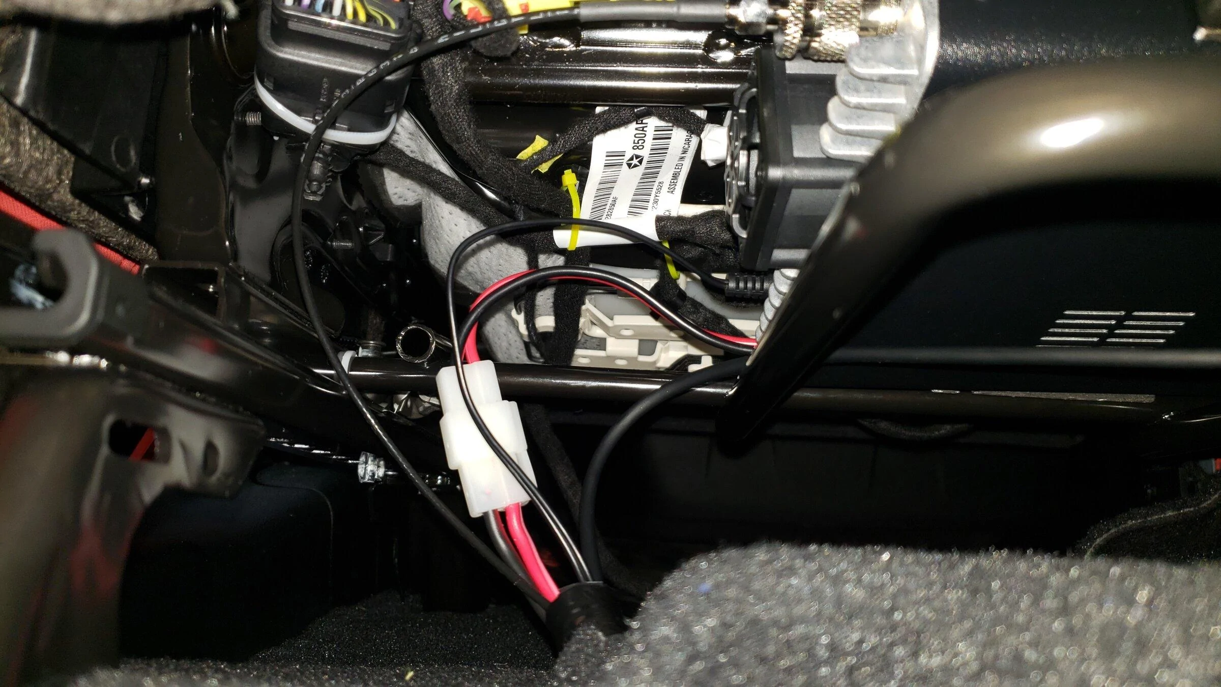

Mounted my Icom ID-5100A under the passenger front seat. The head unit is mounted to Vector Off-Road E-Dock using Ram mounts. I used metal ties to secure the main unit mounting bracket to the bottom of the seat above the seat adjuster lever. Fed cables under carpet to firewall. Ran an extension to the mic cable under center console over to the driver seat. Everything is tucked away. Very happy with result. It's off the floor which was my goal in case things get wet! Sorry for non-detailed pics... hard to get good angle.

nice. It looks like theres room for just one. Maybe the other could go under the drivers seat?

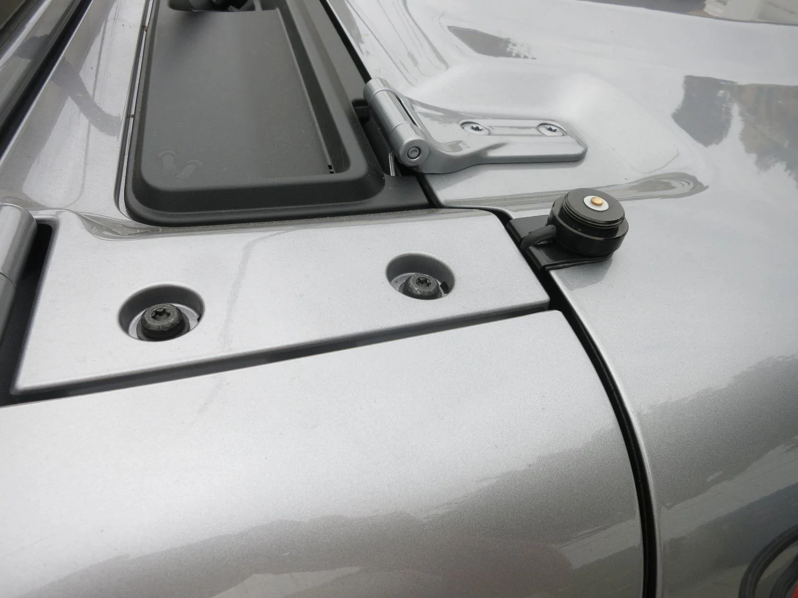

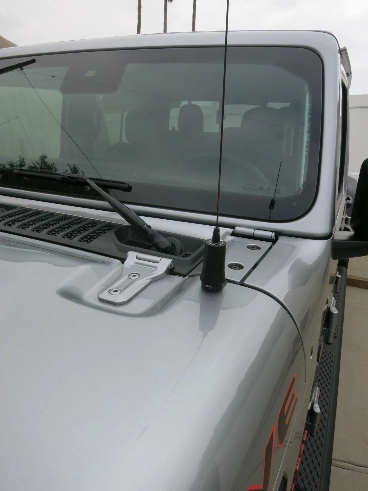

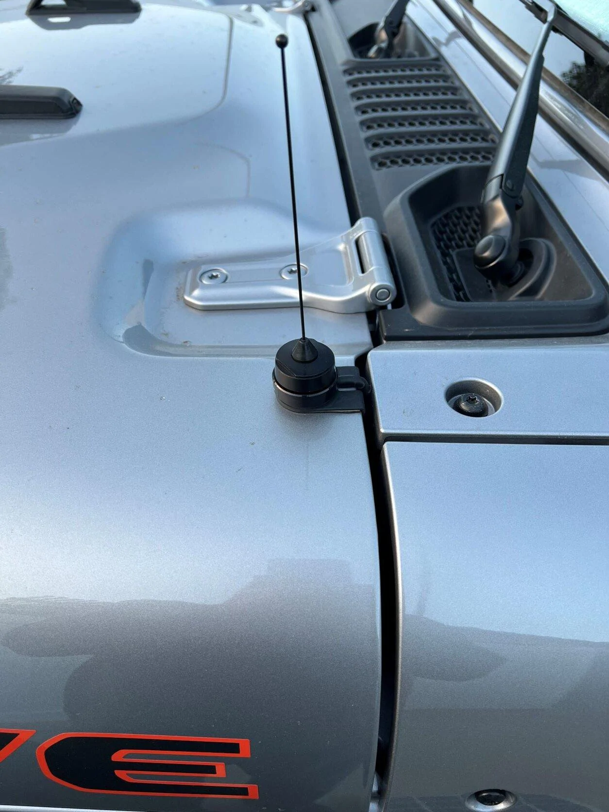

I have lots of other posts in ham radio threads here about antennas. The best performing and probably the easiest place I've found for VHF/UHF and CB antennas is an NMO trunk lip mount on the hood near the hood hinges. If you use the drivers side the cable drops down to an existing grommet that puts the cable into the cab very easy. This is a better spot compared to a bracket sticking out the side of the hood which puts the antenna about 6" below the hood. It also uses the hood as a ground plane which helps with distance and matching the antenna.
Here are a couple of pictures of antennas on my hood mounts and I have one on each side plus more in the back of the truck. Lots of companies make the mount with Laird, Larsen being premium brands and Tram/Browning being ok but less $$. You can sometimes find the better brands on eBay surplus for less than the cheaper brands.
