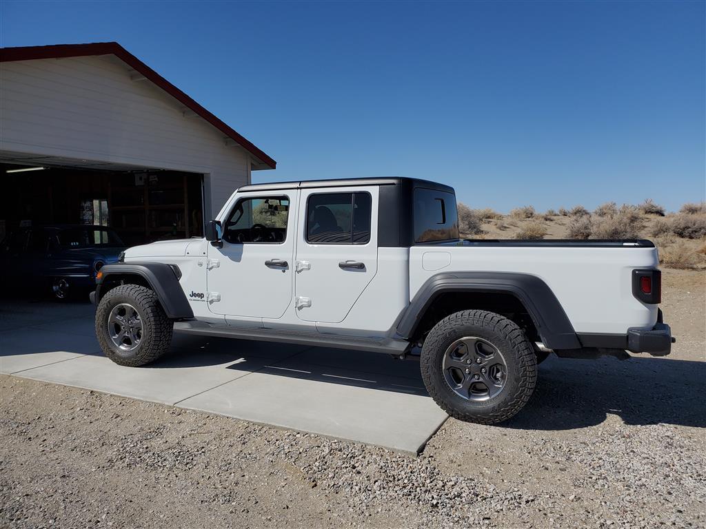

I put Rubicon take-offs on my Max Tow. They are 285/70r17 and are fine. I did program the computer for the slightly larger tires with J-scan.
I was going to buy tires and put them on the stock rims but I could literally buy complete Rubi take-offs for less than buying just the tires.
Here is a pic of the tires on my JT before I installed the Mopar lift.
