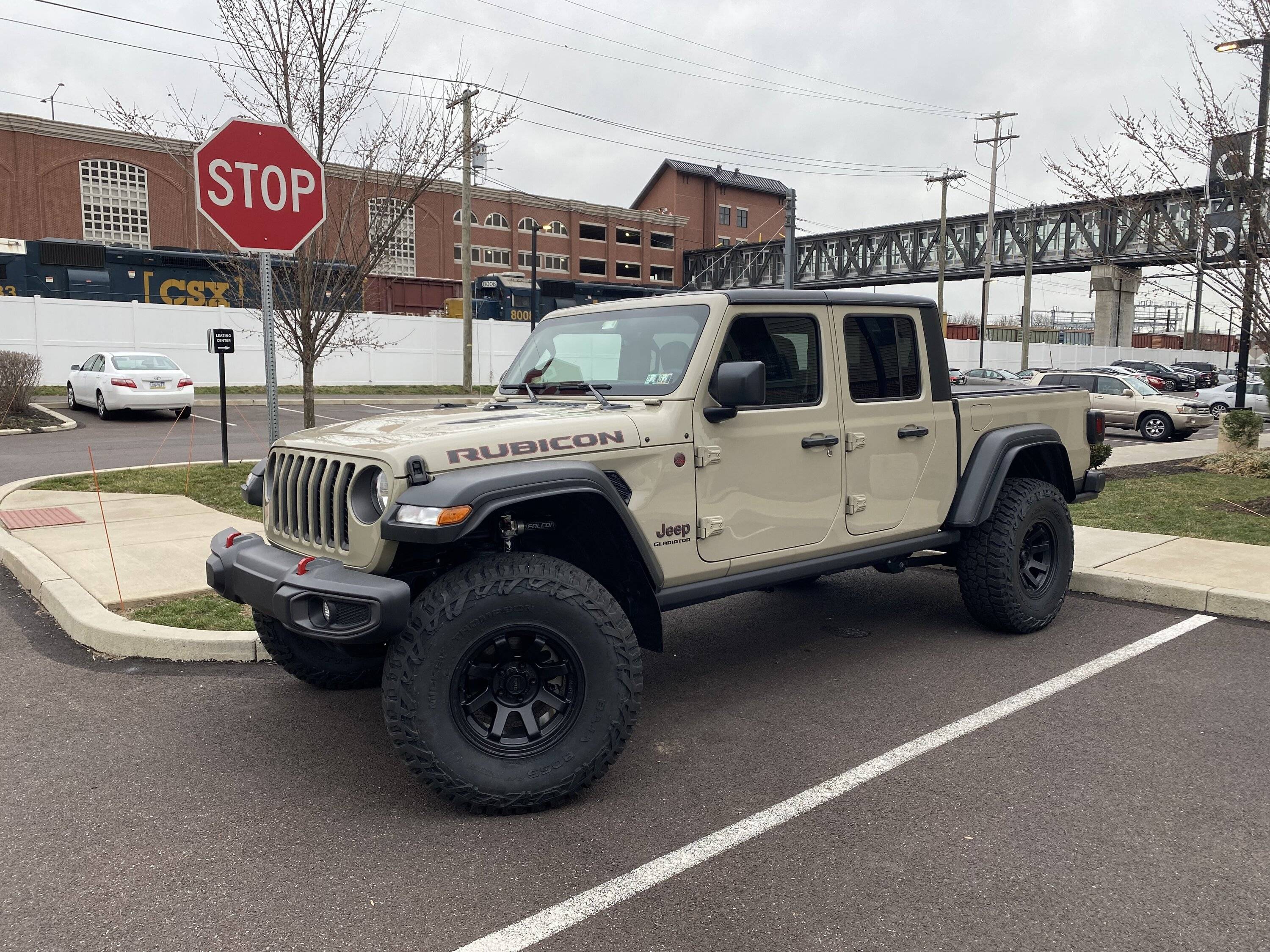

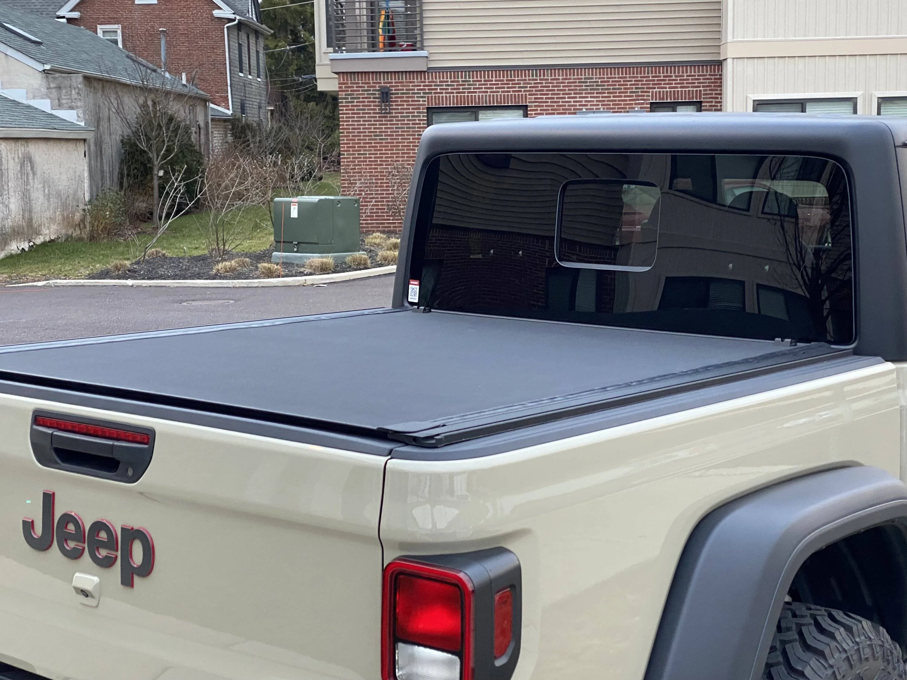

..... just to prove it happened ... here is a picture:

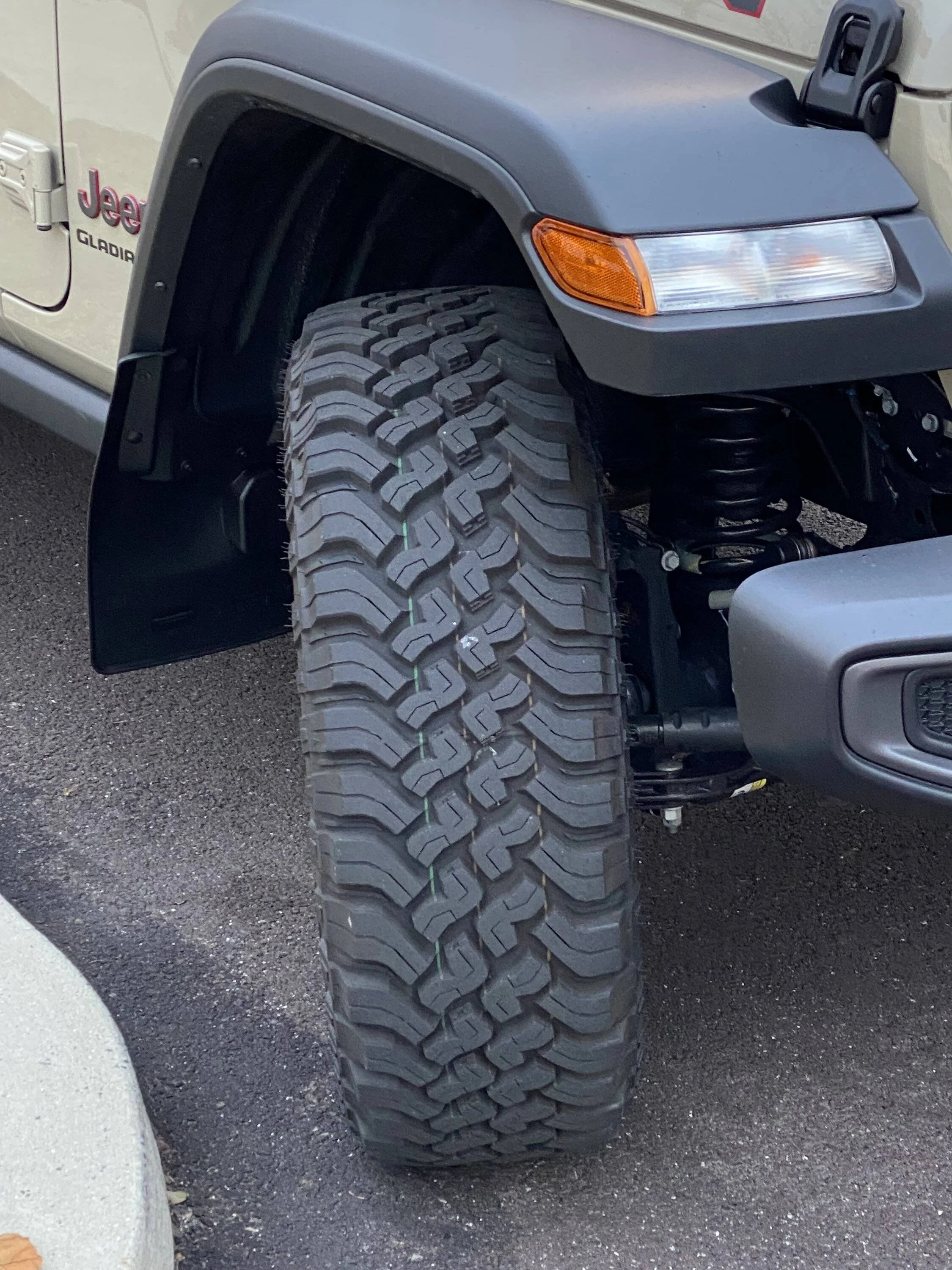

Round 1 - Some cosmetic goodies .....
  • uConnect 8.4 Screen Protector - bargain buy on Amazon. No pictures, 'cause you can't even tell it's there! I've ruined plenty of touch screens with barn yard grit, etc on my fingers.
  • Omix Sill Protectors because I could
  • Bakflip x4s
  • Weathertec Mud Flaps Front and Rear

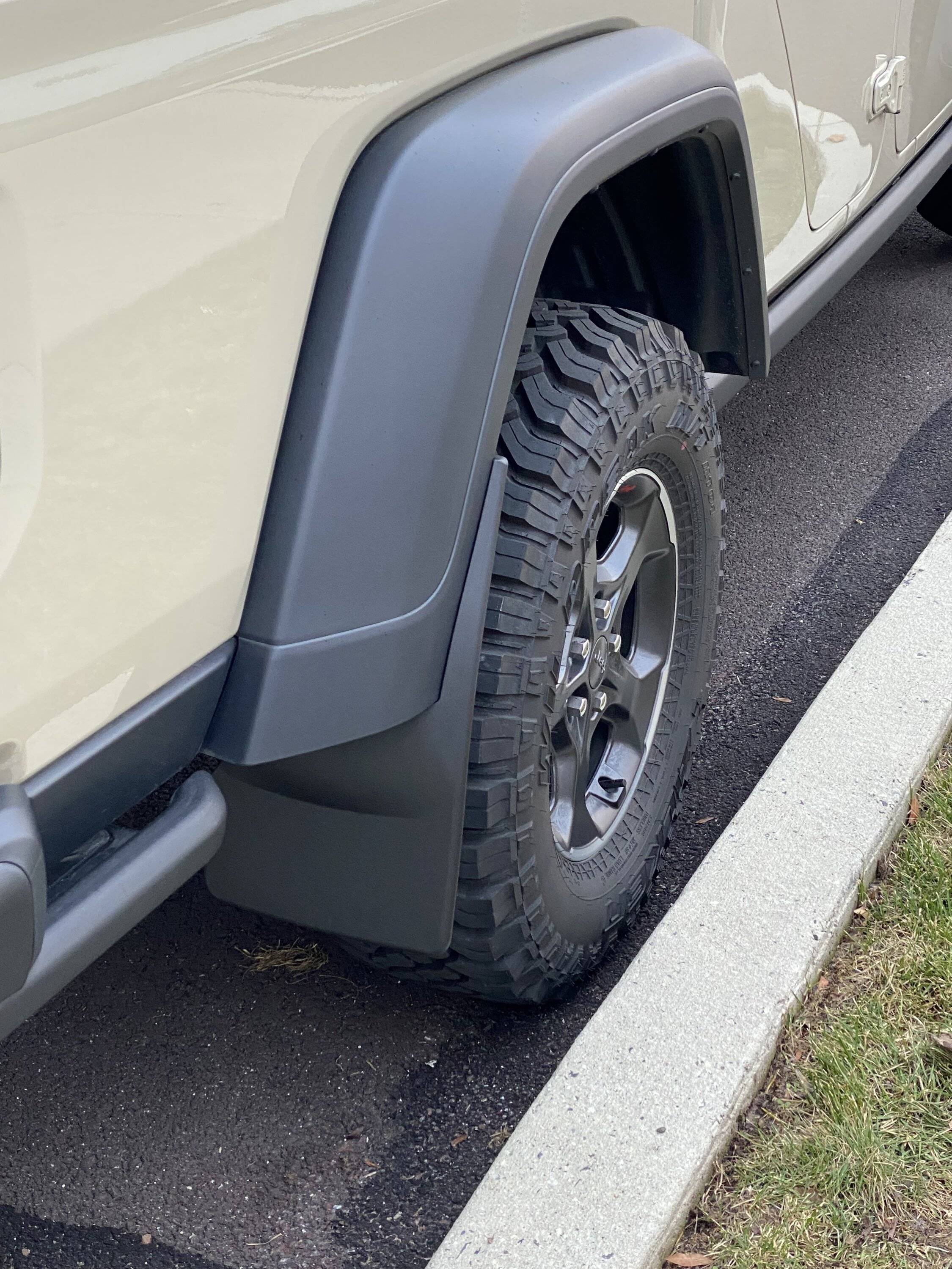

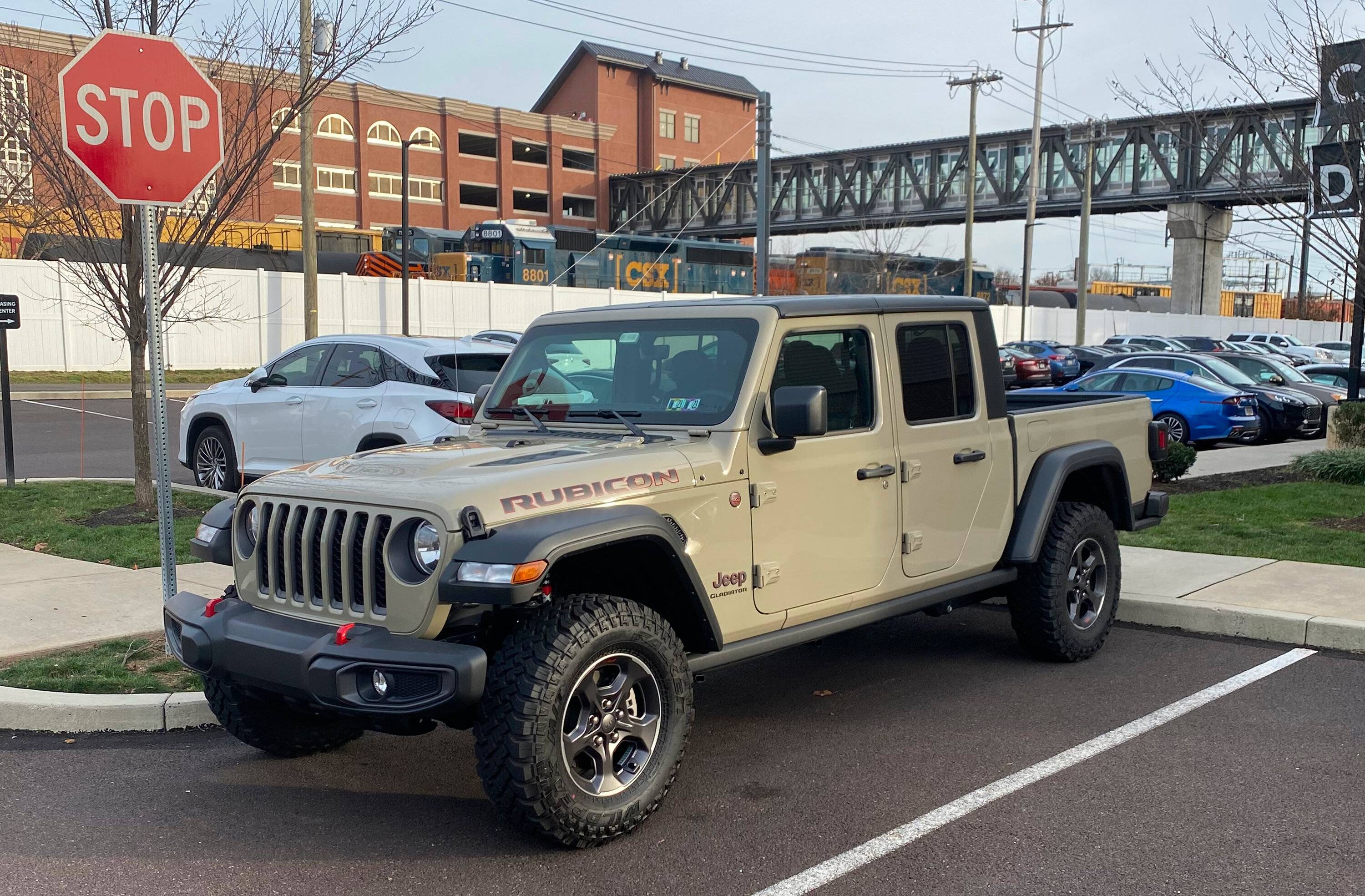

A few pictures with the updates ....

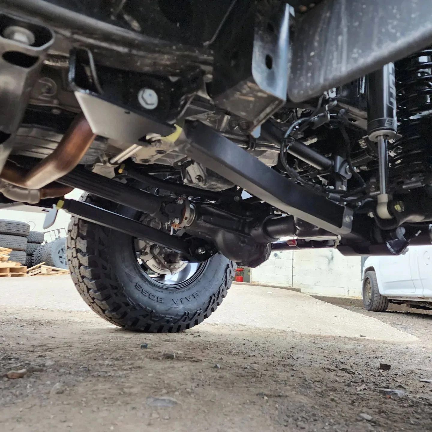

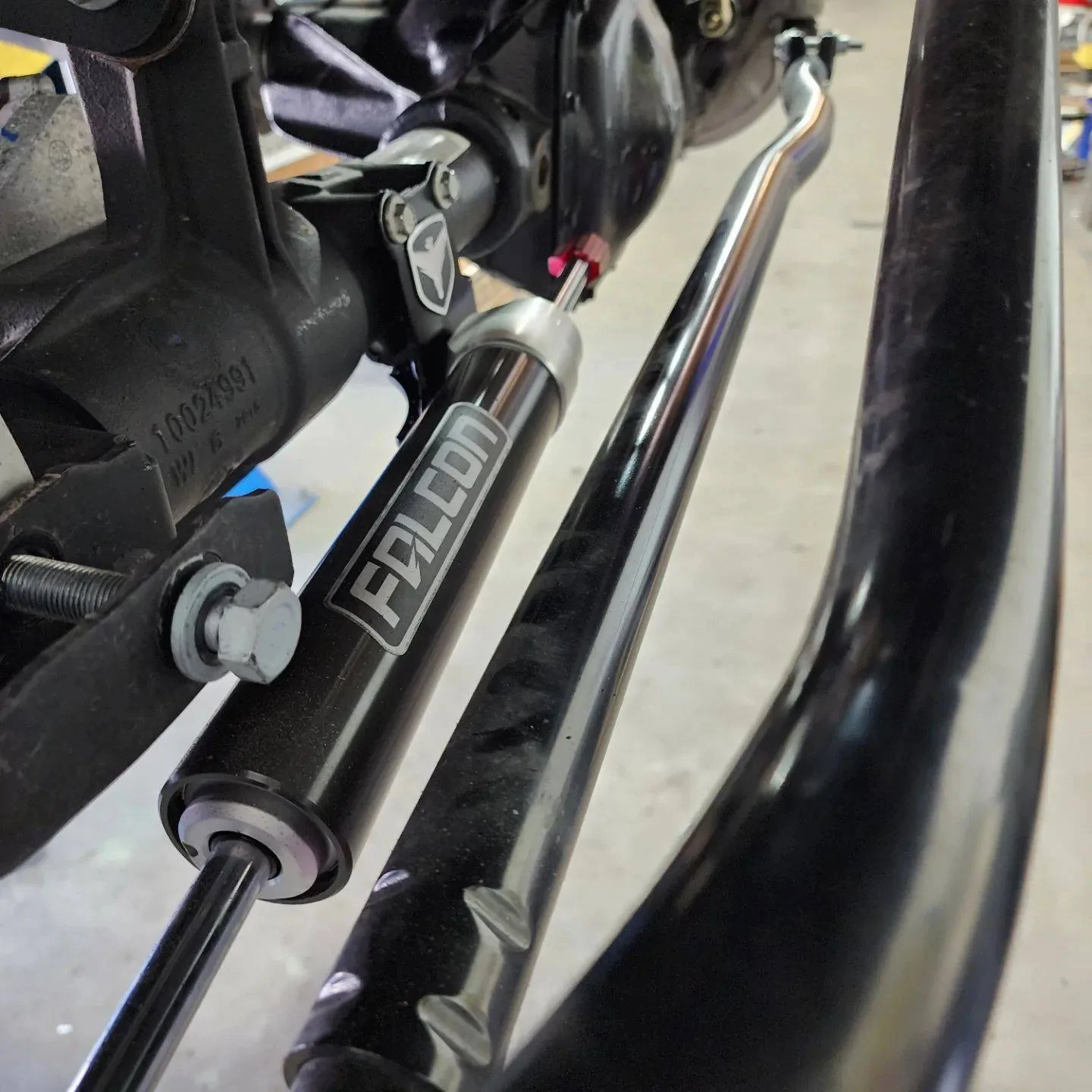

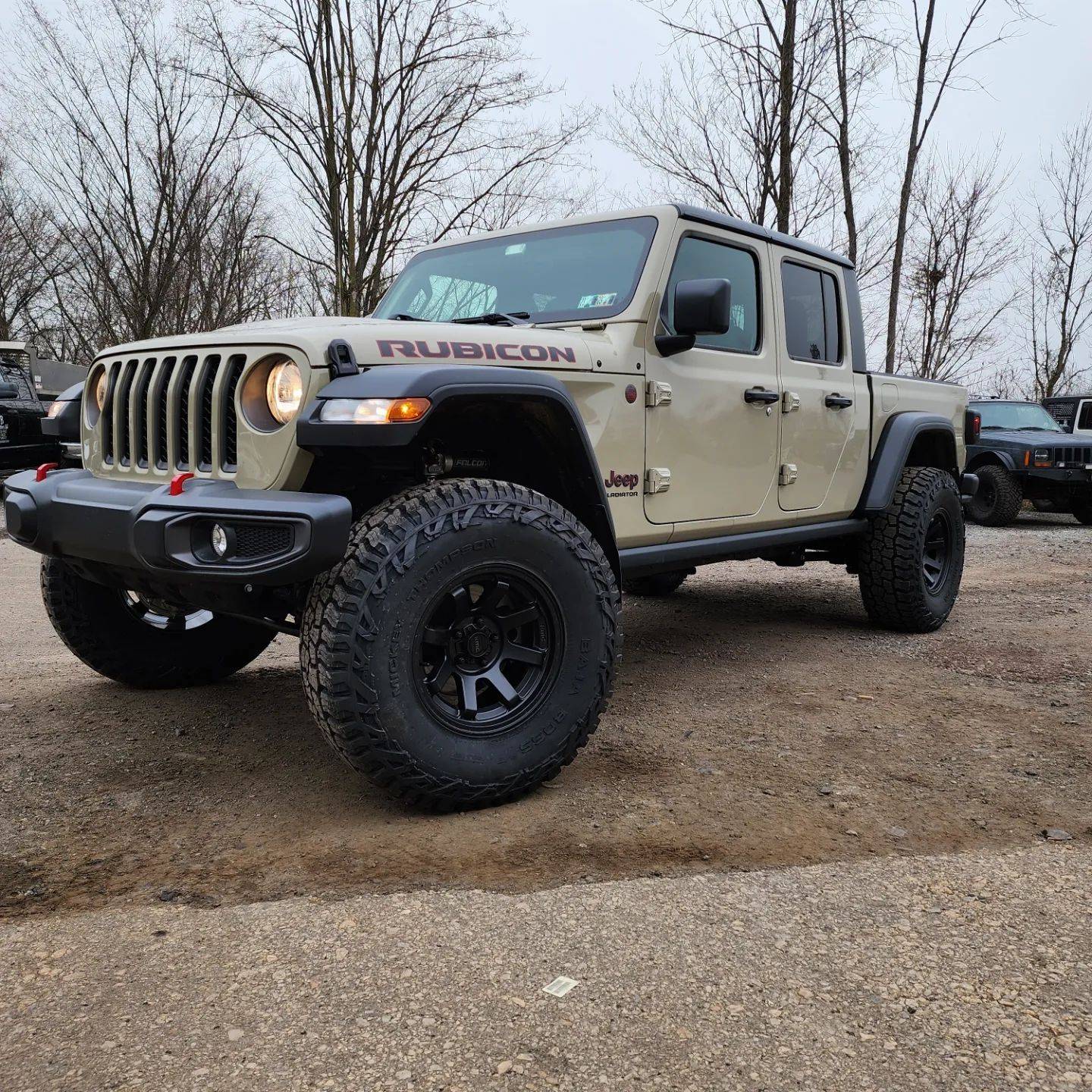

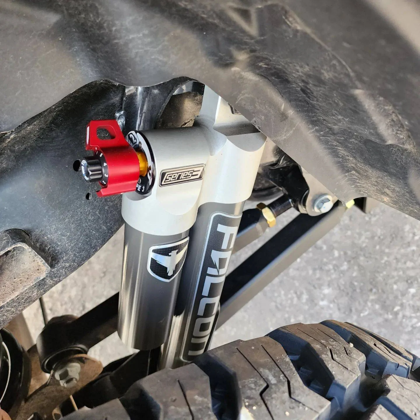

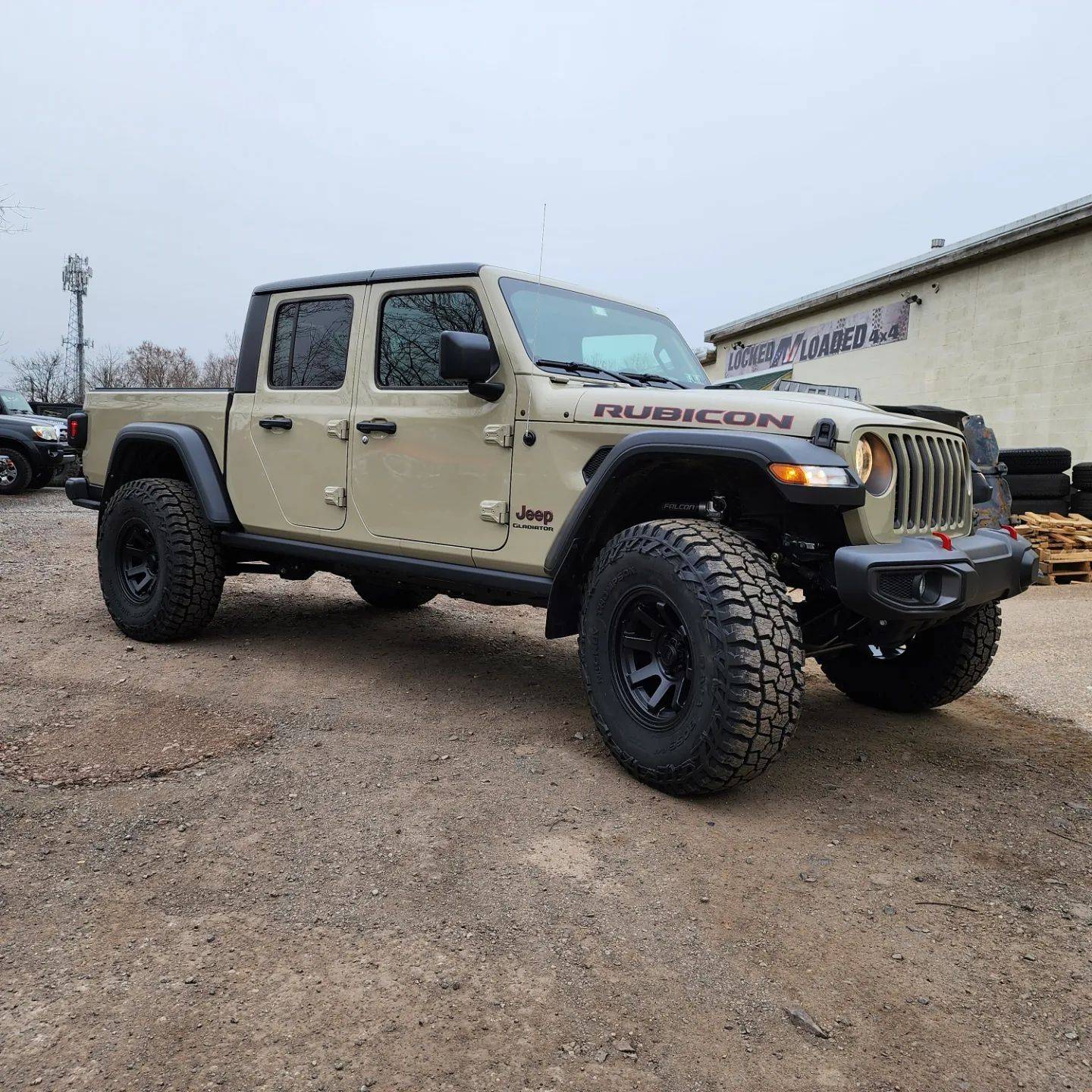

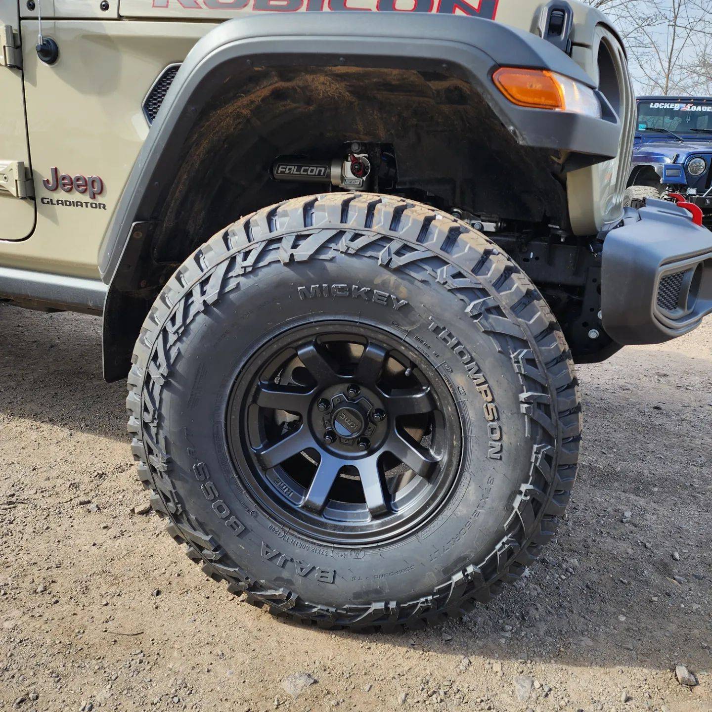

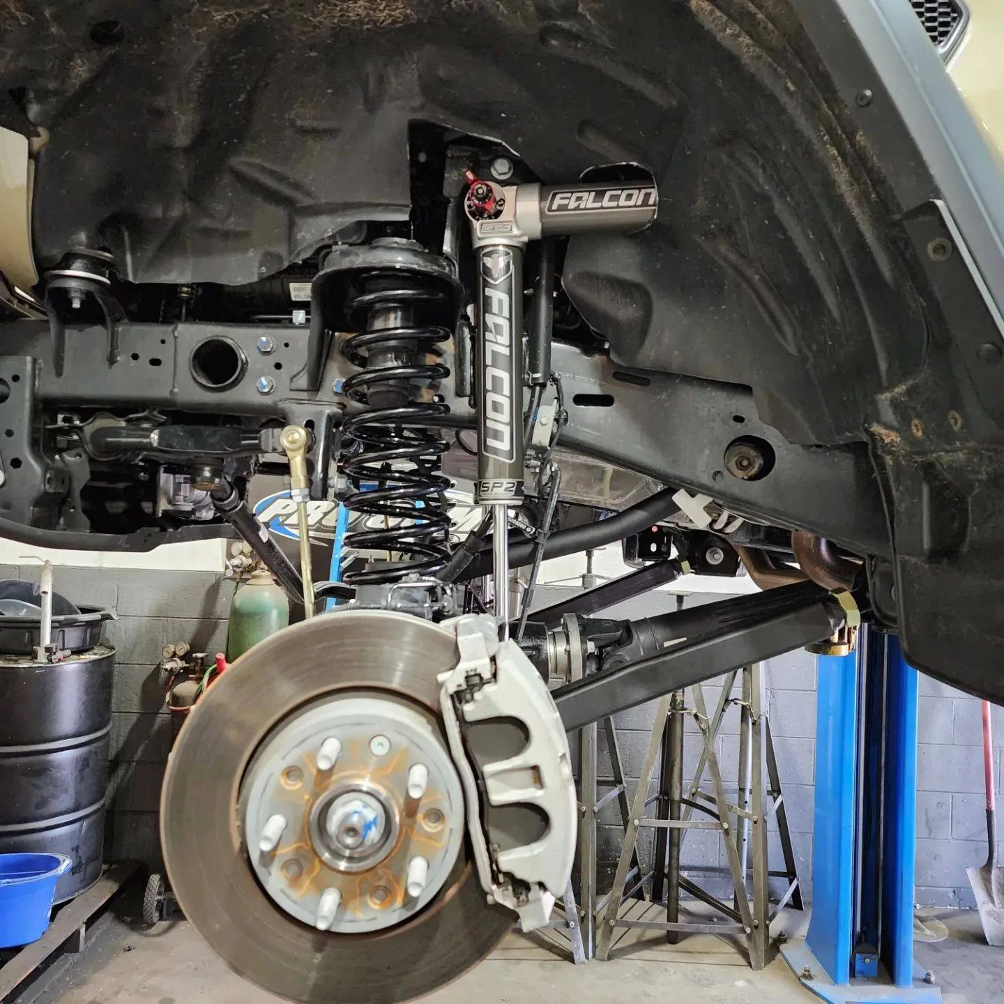

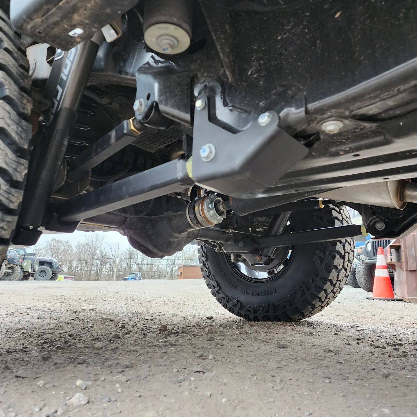

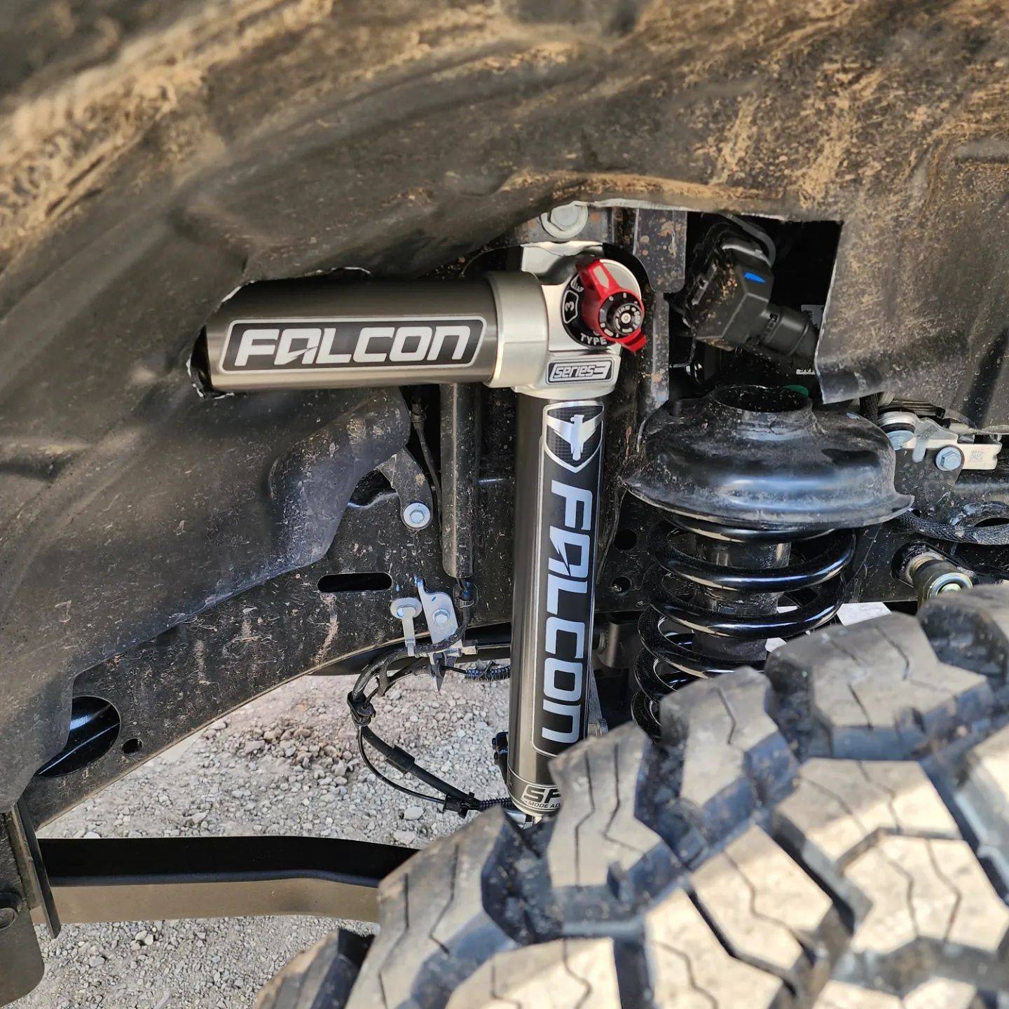

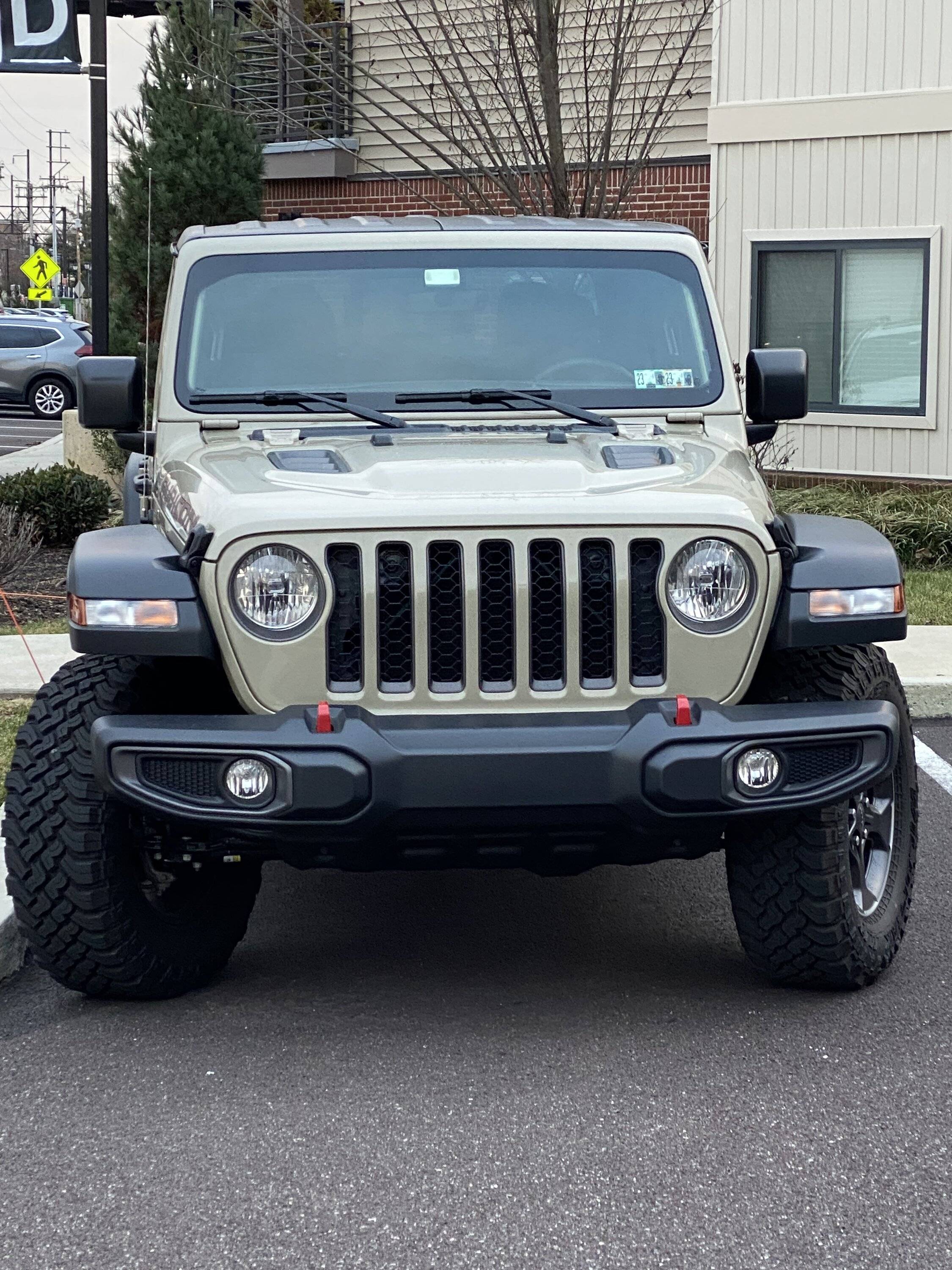

Finally had all of my parts show up and the shop I'm working with put things together today.... Clayton 2.5" Overland Plus kit, Falcon SPC 3.3 shocks and steering damper, RockHard axle side lower control arm skids front & rear plus frame side on the front, Rusty's frame side control arm skid in the rear, KMC Trail wheels and 37" Mickey Thompson Baja Boss A/Ts ... and as they say "pictures or it didn't happen!"

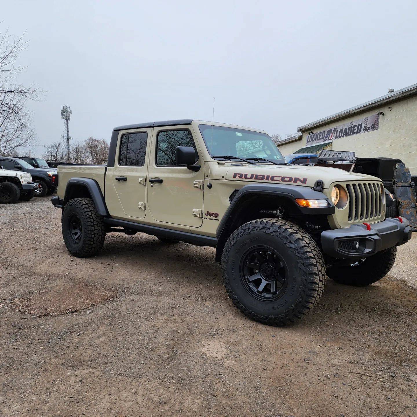

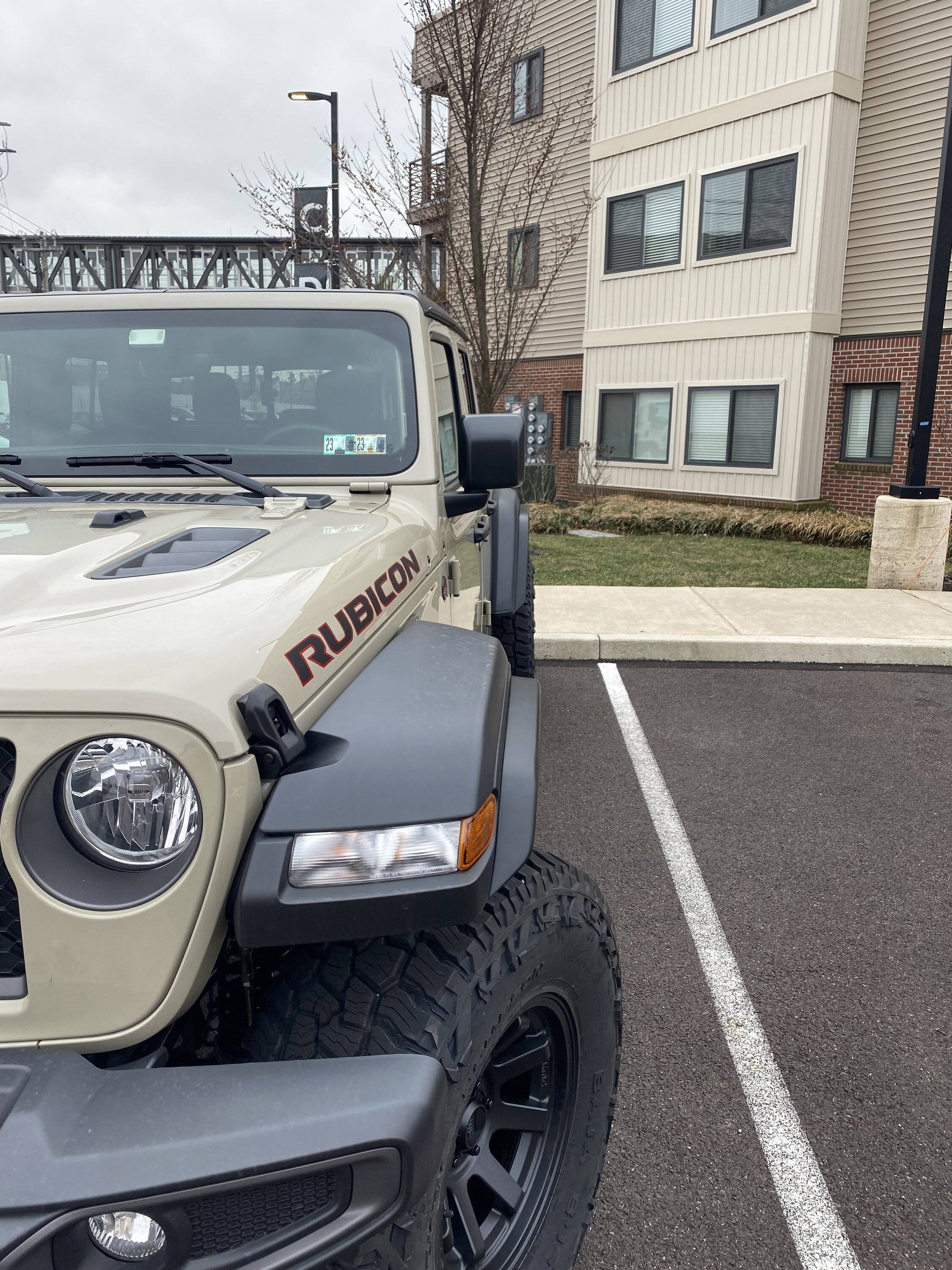

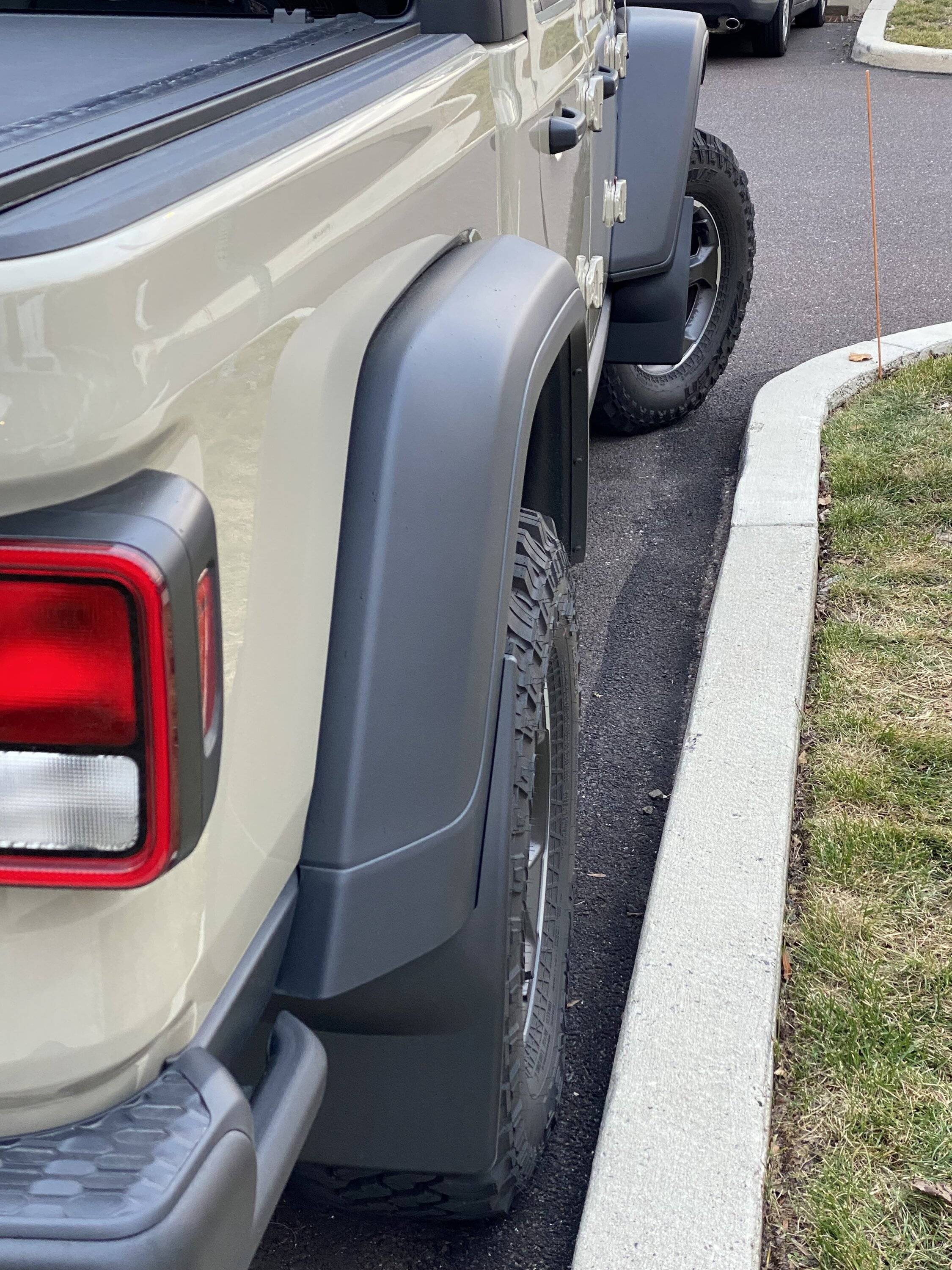

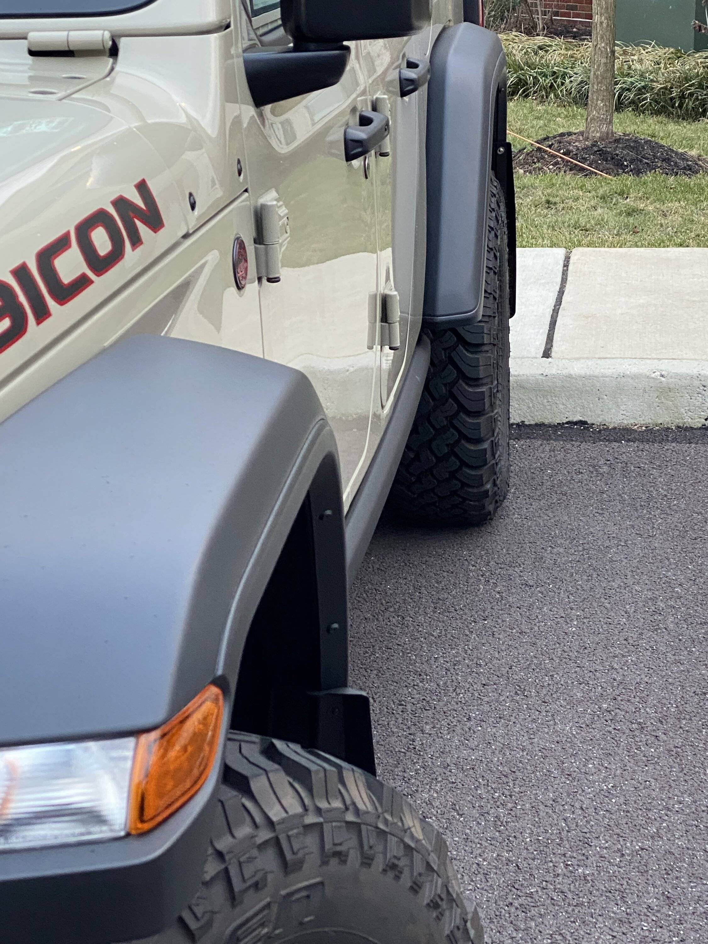

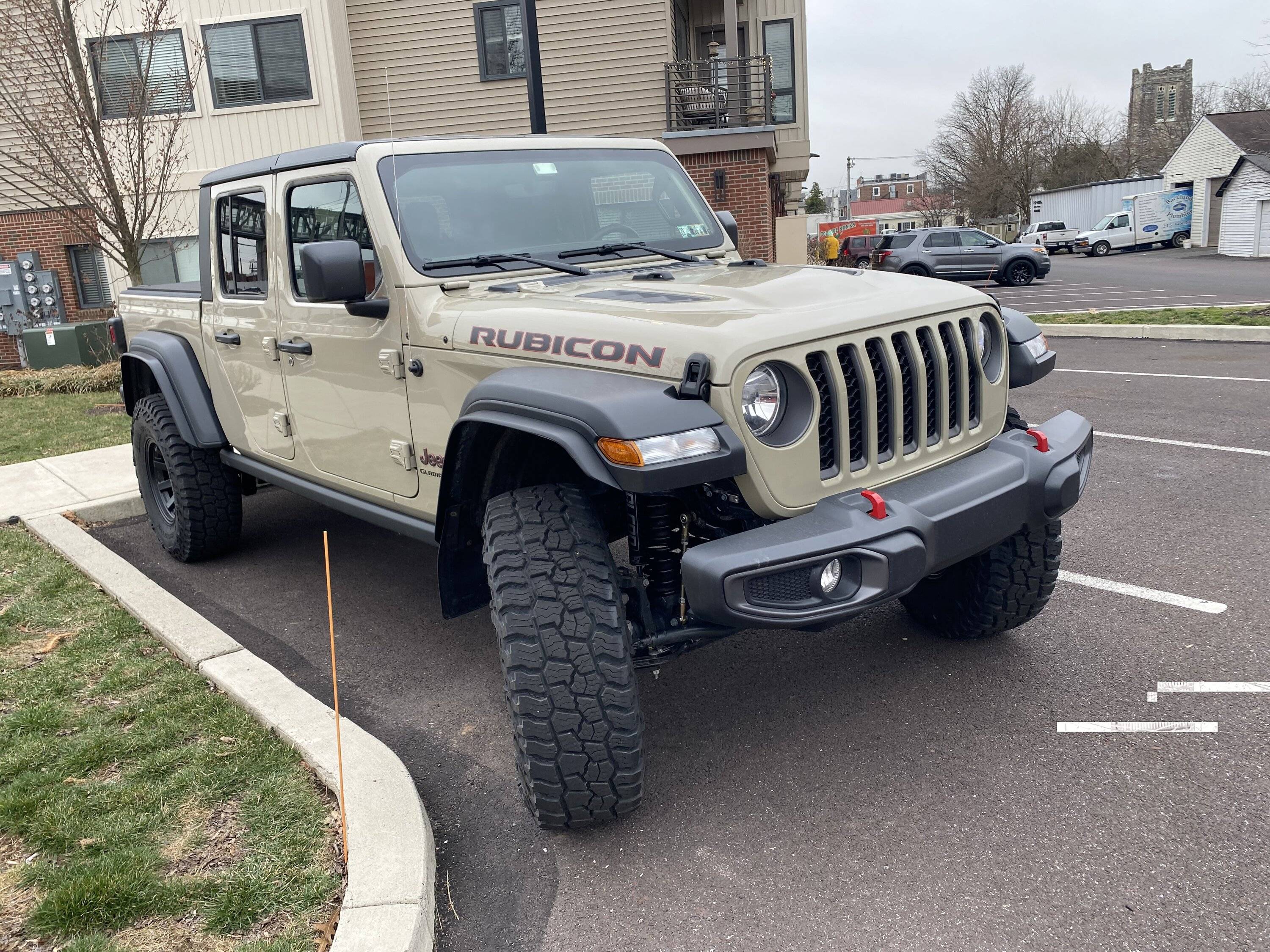

Another update .... knowing I'd see some noticeable tire poke with the new wheels and tires ... I ordered Double Black Off Road's fender extensions .... 2" more coverage to keep my local law enforcement happy......
Overall impressions with the fenders is that I think they are okay. I'll probably keep them on my rig as I do like the looks, but I don't think I'd buy them again. Here are my main thoughts on them:
I feel they are a bit too expensive for what you get.
The set of four extensions was on sale for $340, but it was another $260 for shipping from Australia. Grand total $600! - for four pieces of fiberglass with marginal quality finish.
The finish could have been much better.
The extensions arrived with a very glossy finish and needed some attention.
Outside Finish: The exterior side of the fender (what you see the most when the fenders are on the Jeep) came with a fairly uniform but very glossy finish. I spent a lot of time prepping the exterior of the fenders just to get to where I could spray some matte black bumper paint on the exterior. While I was hand sanding with 400 grit paper it was easy to pick up on a number of imperfections. There were about a half dozen surface defects where it looks like there may have been bubbles clinging to the mold causing inclusions in the surface resin. I didn't spent time filling them, as I wanted to get the fenders on, but I might pull them off this summer and give them more attention.
Inside Finish: Maybe I am being too picky complaining about the inside of the fender which you don't see that much when they are on the Jeep .... but this side of the fender was left pretty raw. The fiberglass layup layers and swirls of resin prevented me from being able to address this side with sandpaper.
Fit and Installation.
I have to give DBOR very high marks on this front. The extensions were pretty much a perfect fit to the factory Rubicon fenders. I had WeatherTech mud flaps installed front and rear and was able to keep the front ones on with the flares. The rear mud flaps wrap around the factory fender a bit more making it quite hard to line up with the extension installed, so I pulled off the rear flaps. Installation was as easy as drilling out the factory plastic rivets (5/32" bit was a perfect size for this), lining up the fender extension, then attaching the fender extension using the plastic rivets that DBOR supplied as part of the set.
Of course, the most important part ... pictures..... the last one gives you an idea how well these covered up the poke for me.

Any reason you didn’t go with the XR package flares the Jeep makes? They are way cheaper and basically the same thing as far as I can tell.

Looks great! I had my lift installed at the same shop, good people.
Well ... I was mostly looking to have extended flares to avoid any of Pennsylvania's LEOs telling me I wasn't up to par ... then I decided since I was getting extended flares I wanted something the followed the entire fender for full coverage. The XR flares cover about 60% of the wheel well ... after replacing my windshield on day 4 of ownership ... maybe I want too far on trying to get as much coverage as I could to protect from kicked up gravel?!?!
I do like the look of these as they follow the full line of the factory fenders. Really, if the shipping wasn't so expensive and the finish on them was just a little better I would have probably been 100% happy with them. ..... if rugged ridge ever copies these in some form of plastic similar to the existing fenders, I think they might have a hard time keeping them in stock.
Joe is a rare find. Someone who honestly wants to make a living by doing work he can take pride in. I wouldn't hesitate to recommend them and will go back to LockedNLoaded again in the future.
You are pretty close to me Greg, we should make some trips to RC or AOAA soon
