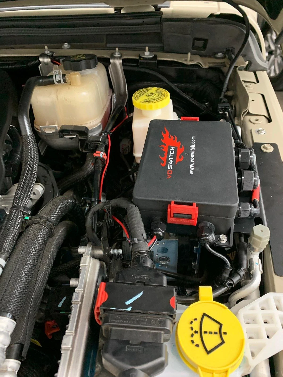

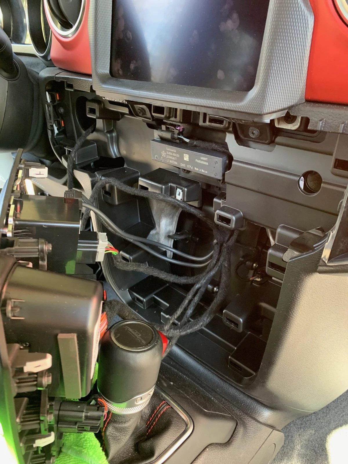

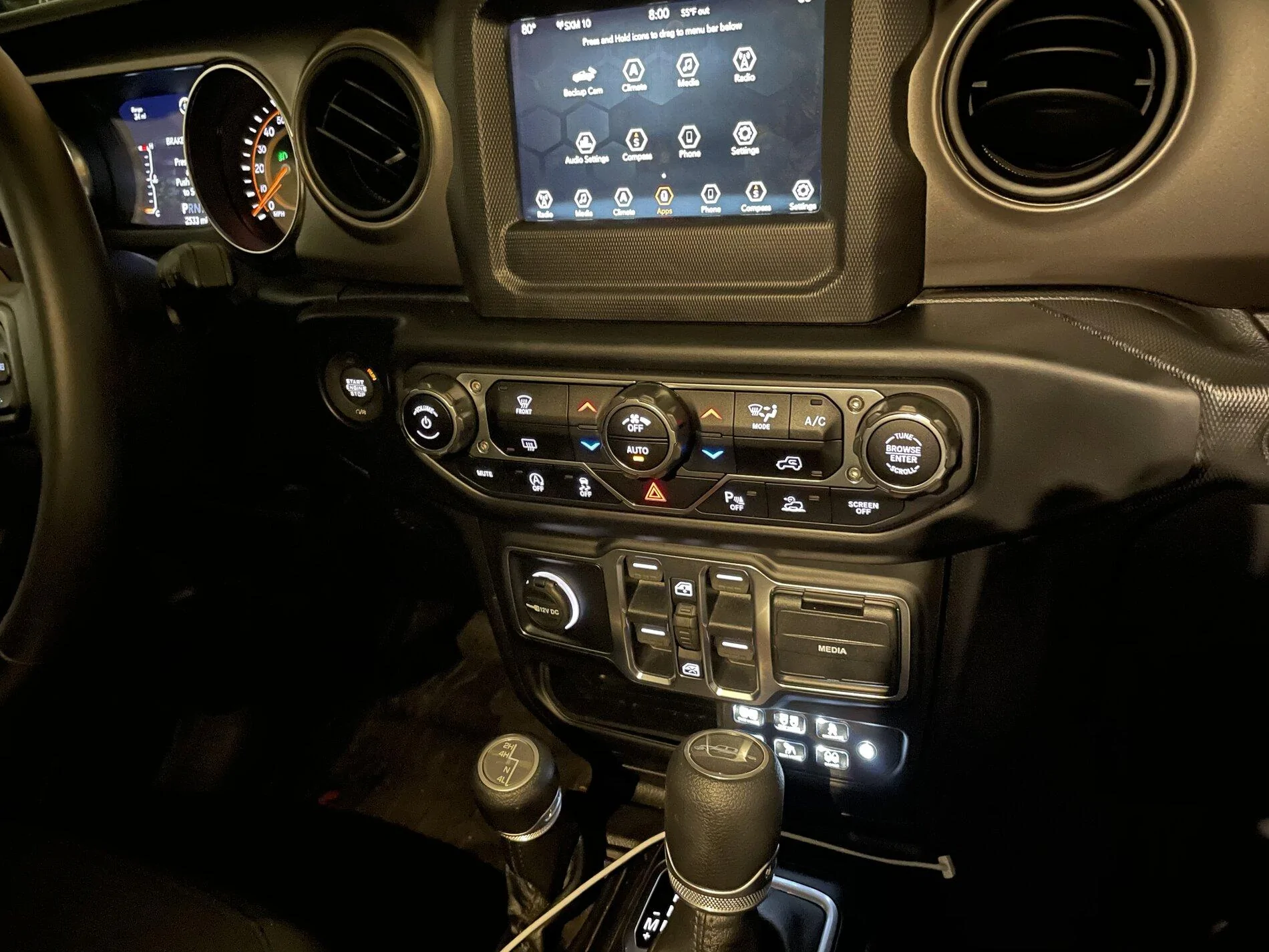

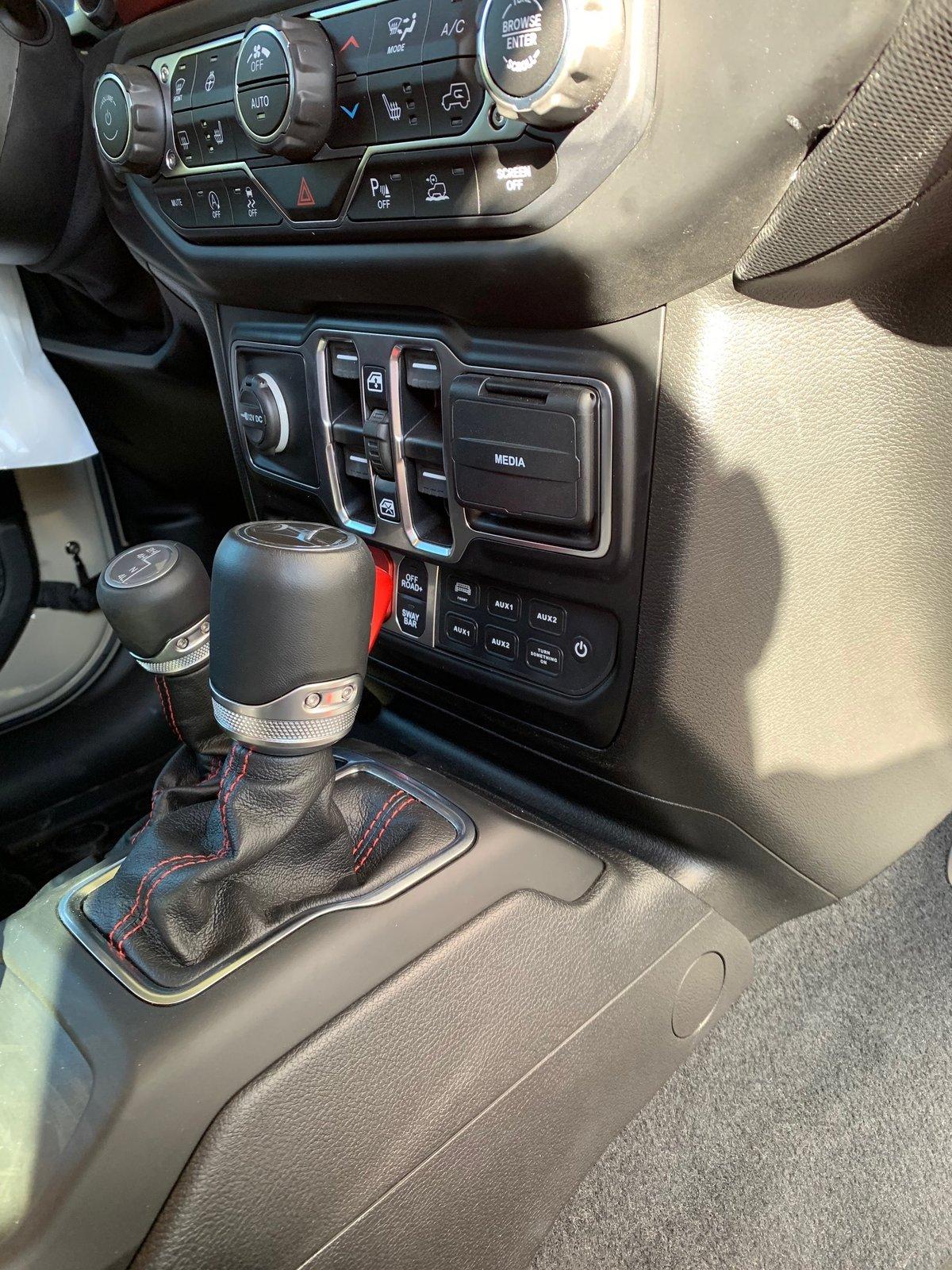

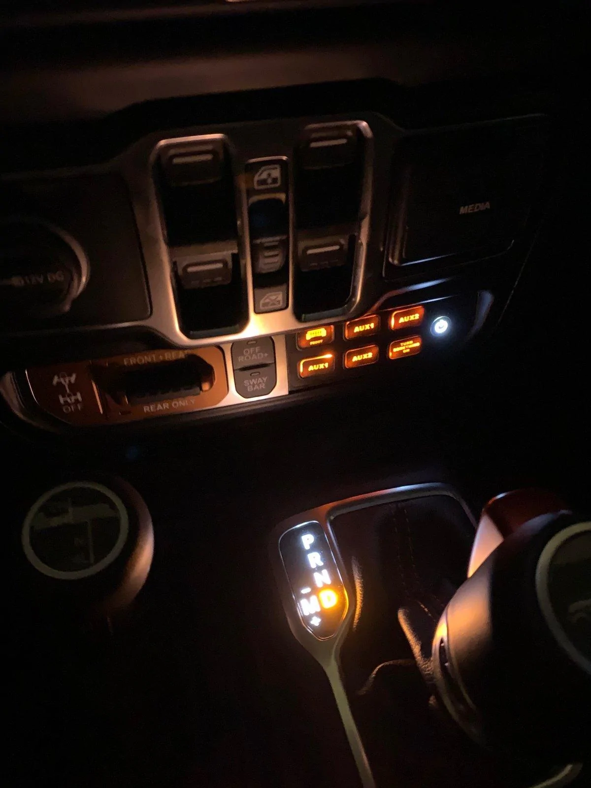

I just installed the Voswitch JL-300 switch control system to my Rubicon. There were a couple of options I wanted but didn’t get with my Gladiator. One was the optional Aux switches and the other is the front trail cam. This aftermarket switch system was real good quality, and had great directions, and overall pretty easy to install. I’m going to be adding lighting and other devices, so this has 6 switches. I also tied it into the fuse panel so it would only come on if it was in accessory or run mode. The trigger wire to do this came with it. It recommended using the number 52 fuse slot or cigar lighter, but I ended up using 50 because the 52 slot came on without pushing the ignition button. This isn’t bad but I was afraid I would leave it on, and drain the battery. Regards

Great good luck. Not sure why fuse 52 as suggested worked when everything was off, but slot 50 works like it should with the trigger wire. Regards

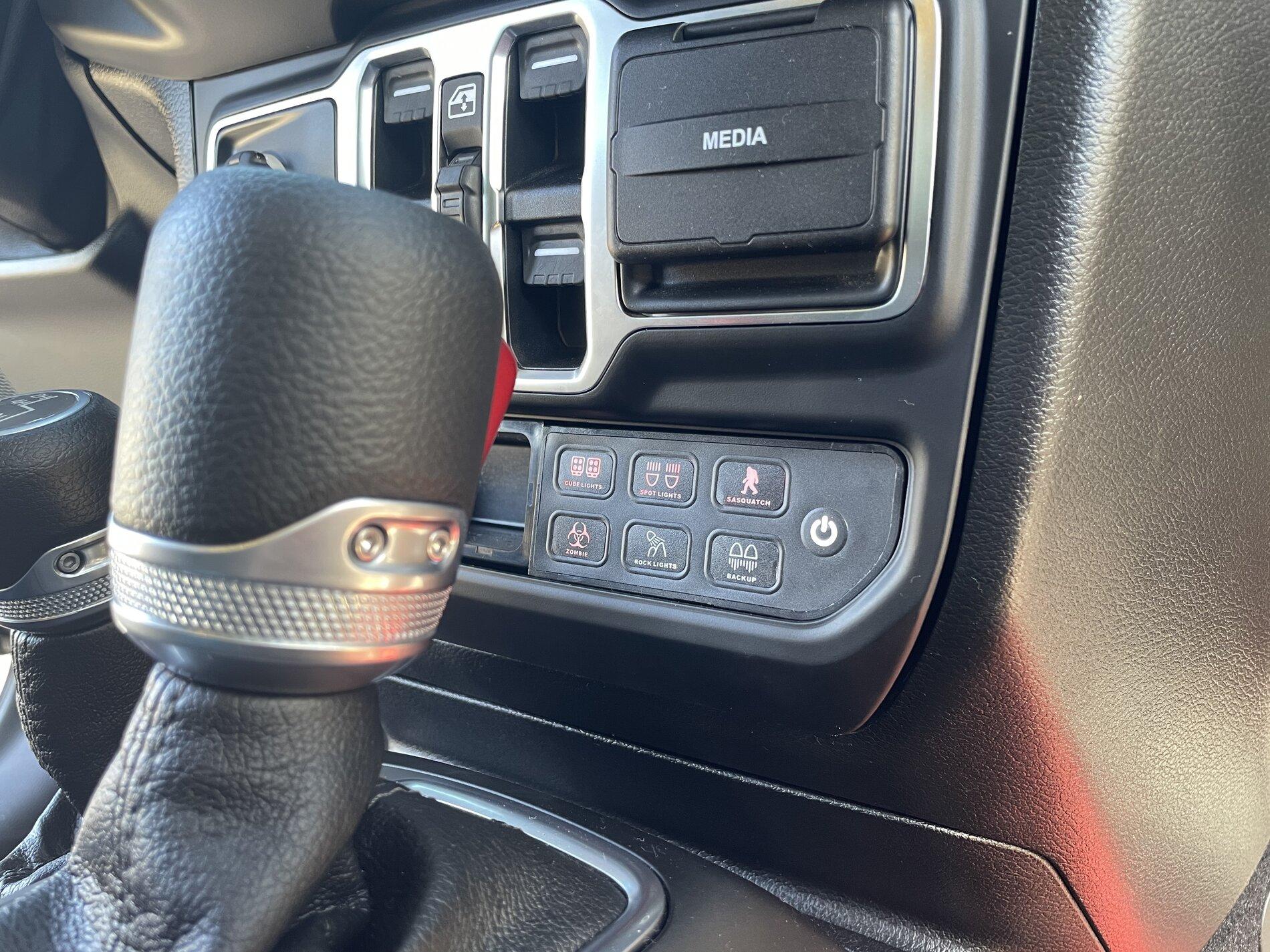

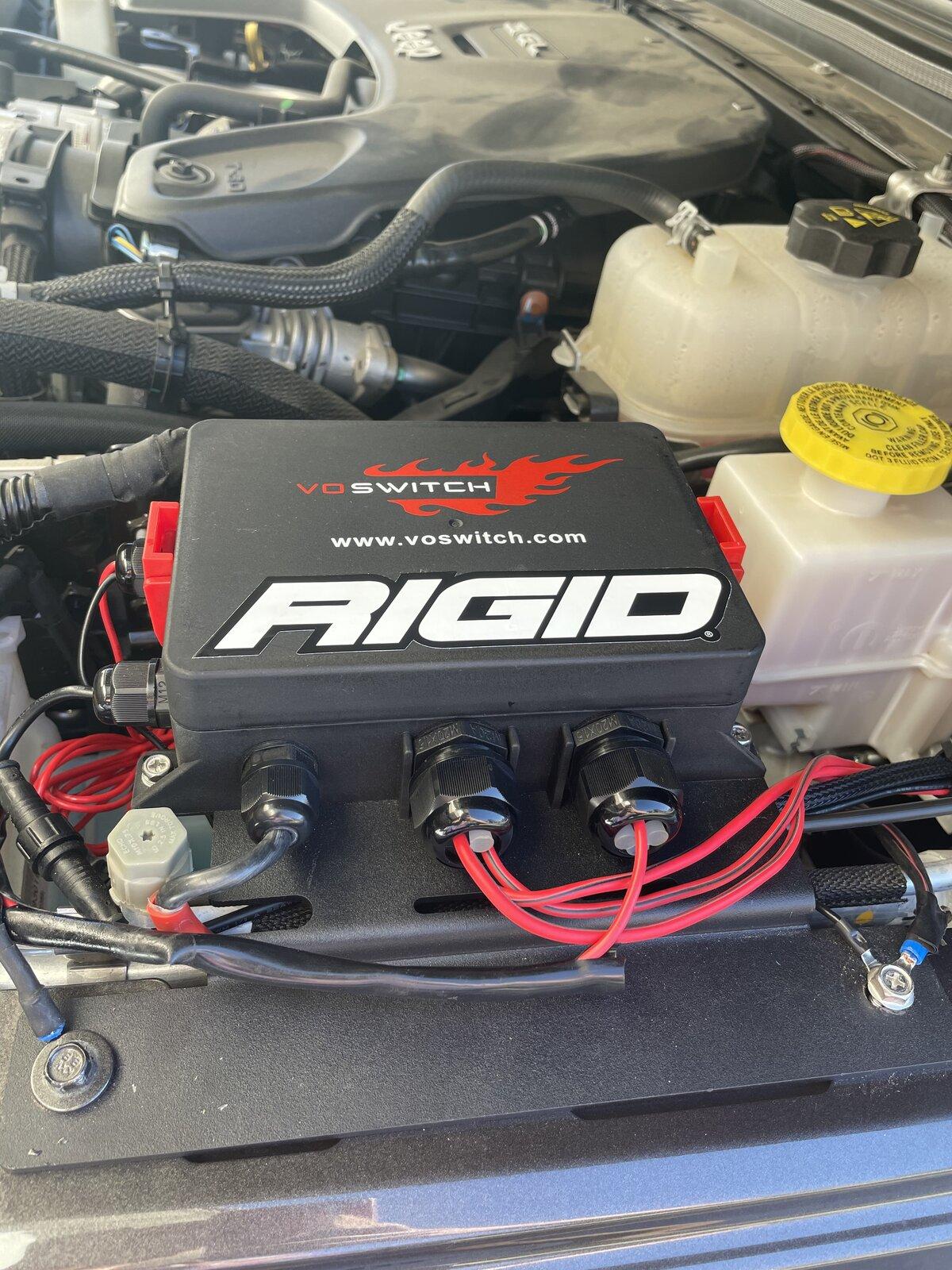

Installed mine and it’s pretty easy to install.
I have 4 lights wired up and the other two are still pending location depending on my end goal (8 LUX rock lights and 2 Rigid SRQ floods).
the only thing I dislike is that there is no dimmer option for this setup. The other models do. It does not distract though.

I like this setup. Why does it have a main power button though?

I was wondering about the power button too. Do you have to power on the unit before the switches are active, or does that power button only turn on the back lighting?

The power button turns the switch panel on and off. The buttons maintain the last setting.
