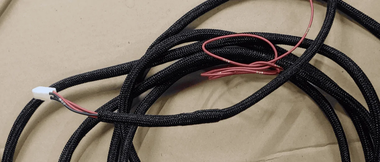

Where's a spot that's easy for an over-weight older guy who is out of shape to reach and run a plow control cable from the engine bay into the cab?
I also need to connect that red wire to an ACC feed, but when I extended the 12v outlet over to the glove box area I used a cable that has taps for power made into the cable - figured I'd never ever use that as I only wanted an extension when I bought that cable. Now, that acc power tap in the 12v outlet extension will come in very handy.
But without necessitating trips to the chiropractor for my back and forcing my ribs into my heart or something, where's an easy spot to feed that white connector and cable into the cab through the firewall?

How much cable do you have?
I’ve had good luck by going along the frame rails up through a drain hole, under the carpet and up to where I need it. At least I did it with the cabling for my compressor and then for my CB antenna.

Quite a bit of cable, but hope to keep it up in the firewall area - IF possible. It connects to the main power cables up near the battery and it appears to the headlight harness that I still don't have.
I'm not sure why, their instructions are not the best, and the invoice didn't list individual parts so I'm not sure of the part number of the harness I don't yet have.
Western's instructions and diagrams are made for professional plow installers and the engineers that created their harnesses.

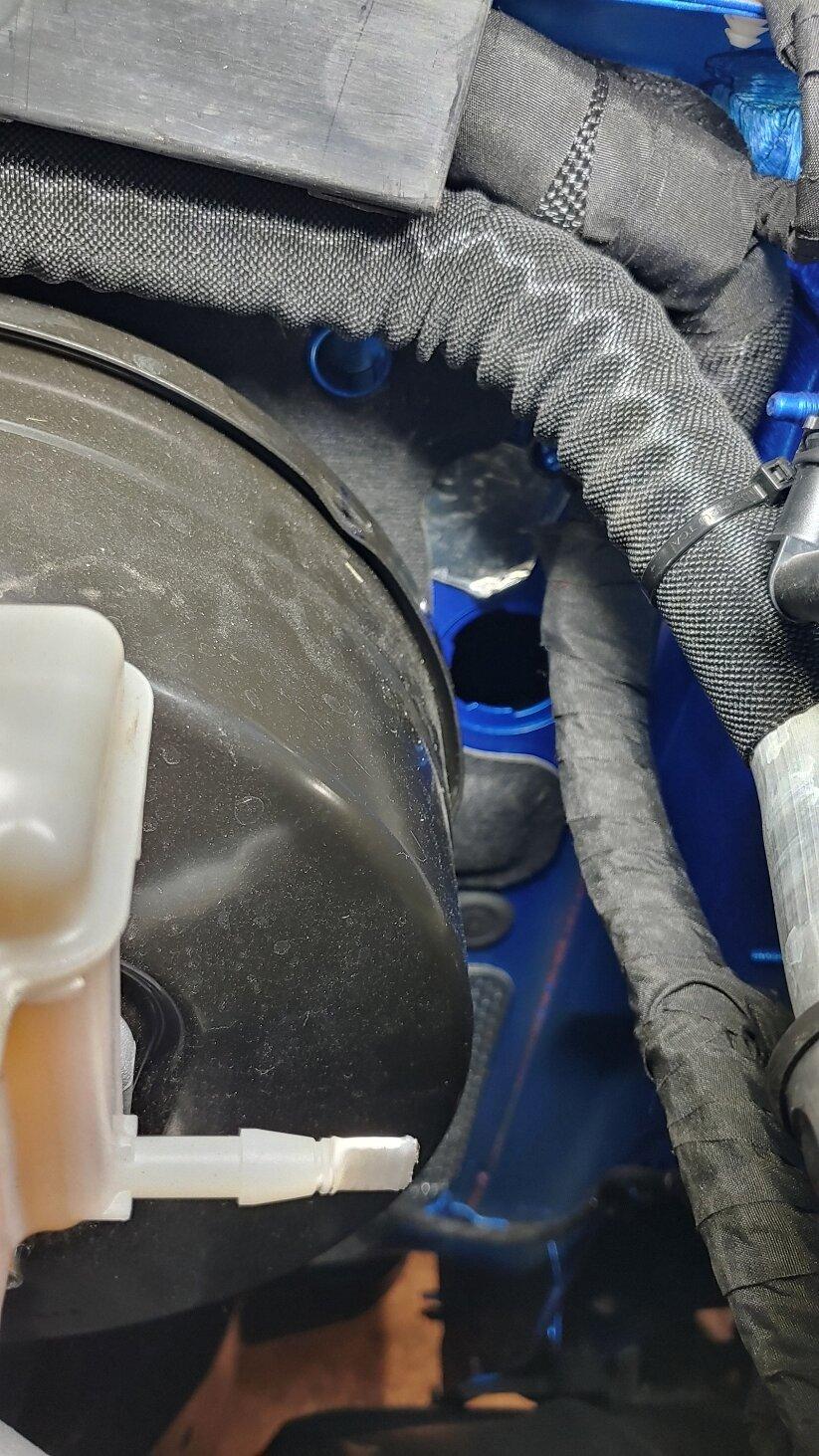

If you do the driver side. The hole where the clutch pedal rod would go through. Fairly easy to get to.

This was my next suggestion. It’s not the easiest to get to though, at least it wasn’t for me.
6,319
14,398
I had no problem with it. Put a straight piece of stiff wire through the hole from the inside to the engine compartment. Taped my wires to it and pulled it back through.

I'm sure you already figured this out but there is another way. I found while looking for ways to route coax for future antennas. The cowl's just front of the A pillar. They are held on by 4 bolts right. So there is hollow space under it. If you use a light, pull back a little the foam/rubber that seals off the hood, you will see open space going to the door hinge area. Now, open the door, and you will see open space going through the frame, and popping out right behind the dash. I will try and take some pics of it tomorrow if I can remember.
180
29,422
34,998

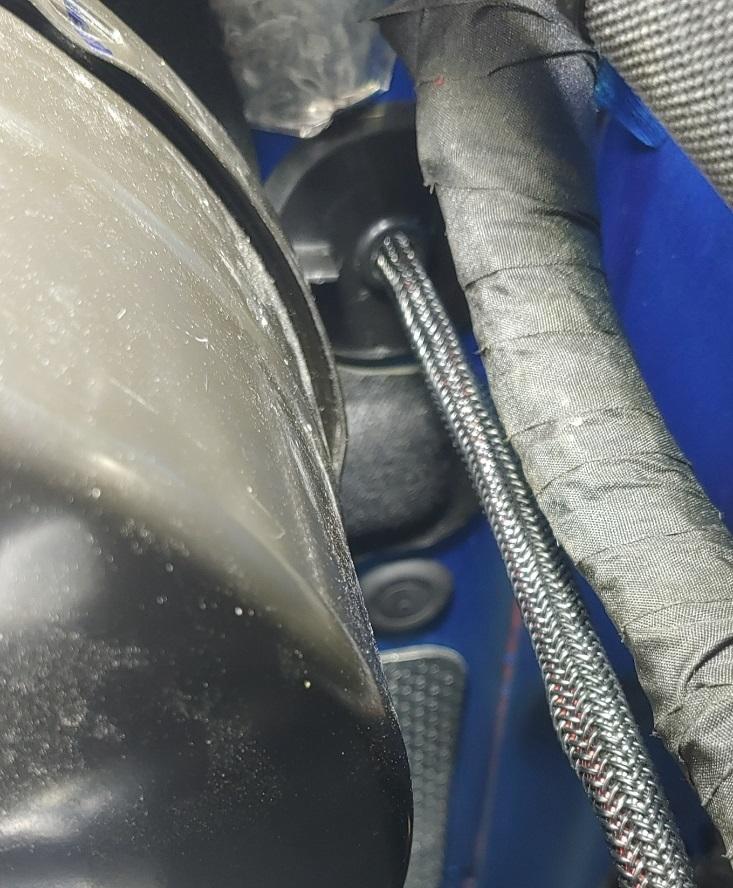

After removing the plastic plug I found this comes out into the cab right by the MOPAR trailer brake controller. A perfect spot!
Jeep Gladiator good place to route plow control cable into cabin? 20221007_141436_HDR
I drilled the center of the plastic plug with a brad point bit to make a perfectly clean, perfectly centered hole, fed the controller connector through, and put a grommet in place and pulled the cable through a bit more.
Ideal location I can strap the cable to the existing factory harnesses.
Jeep Gladiator good place to route plow control cable into cabin? 20221007_142052
From here the cable can go straight forward to connect to the headlight harnesses.
