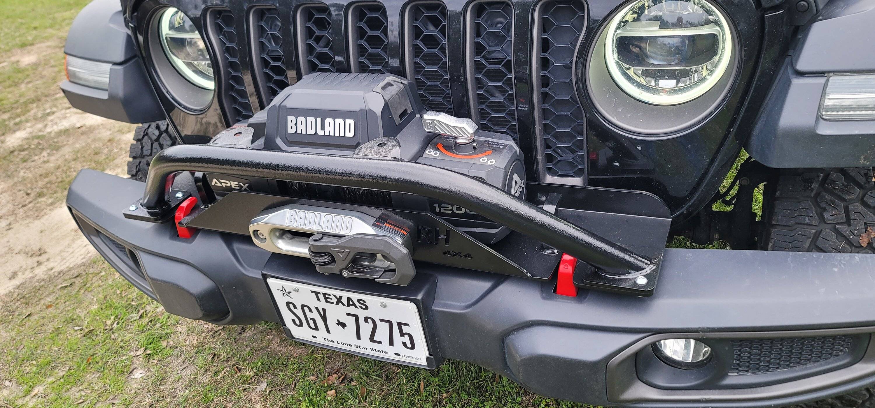

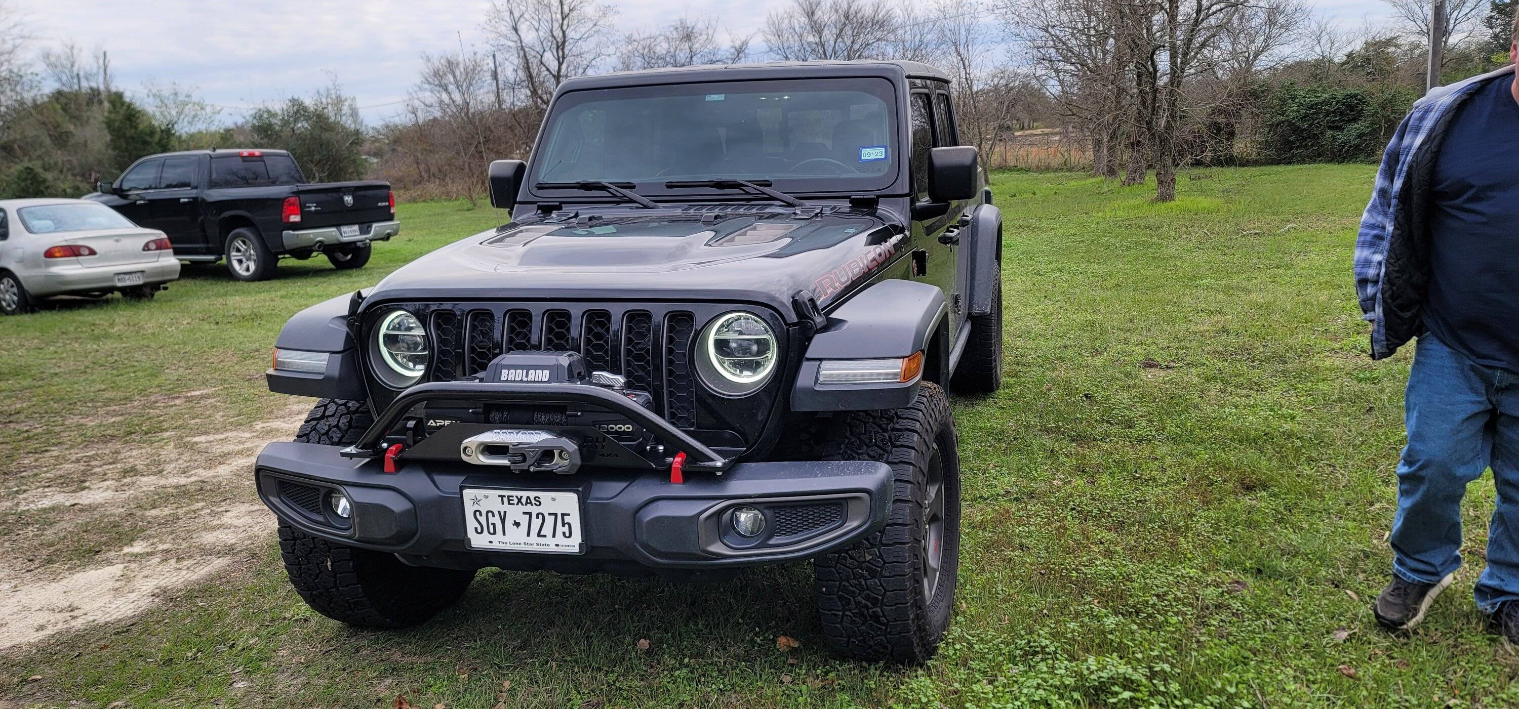

I was finally able to find a winch mount that let me keep the factory look so much that it let me keep the factory bumper. I only had to loosen it to do the install. So far I'm super pleased with the look. I was going to do some install pics but thier own video is simple and it shows all you need to know. The instal was simple and easy. I'm not sure you need instructions other then to show the orientation of the two back brackets. Now I can make a trip over to the national forest 20 minutes away with a bit more confidence of coming home.

Had to try it out on the old Hoople

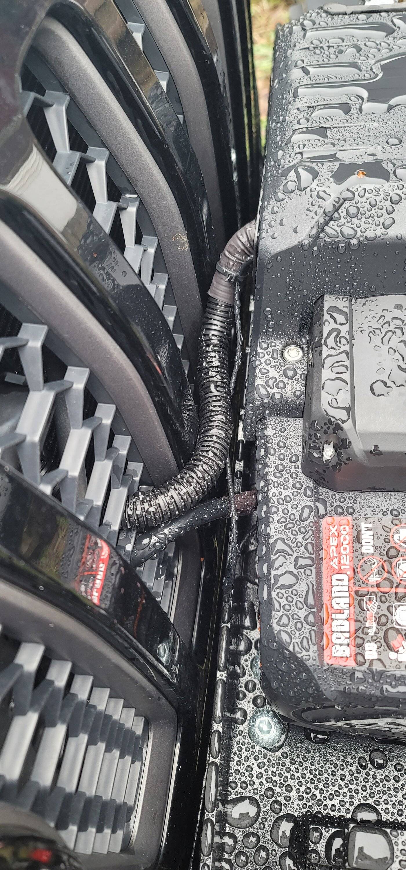

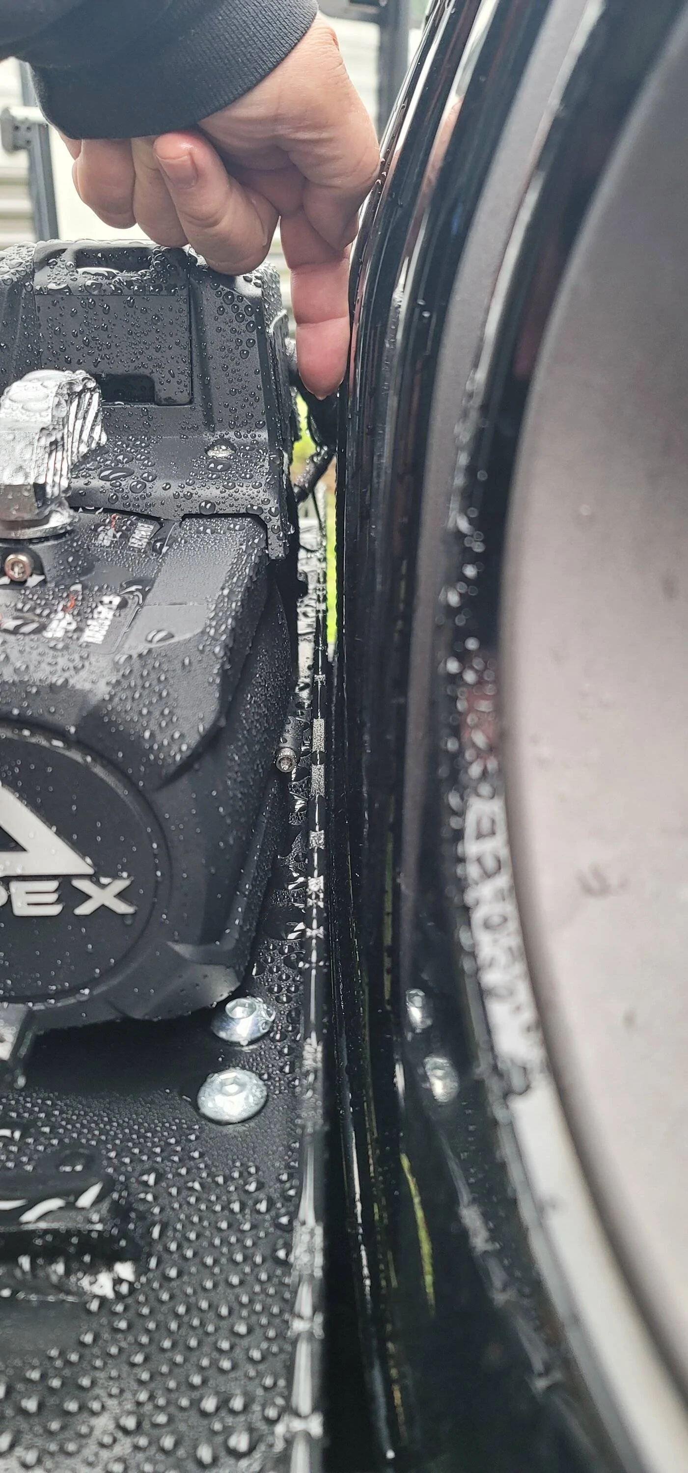

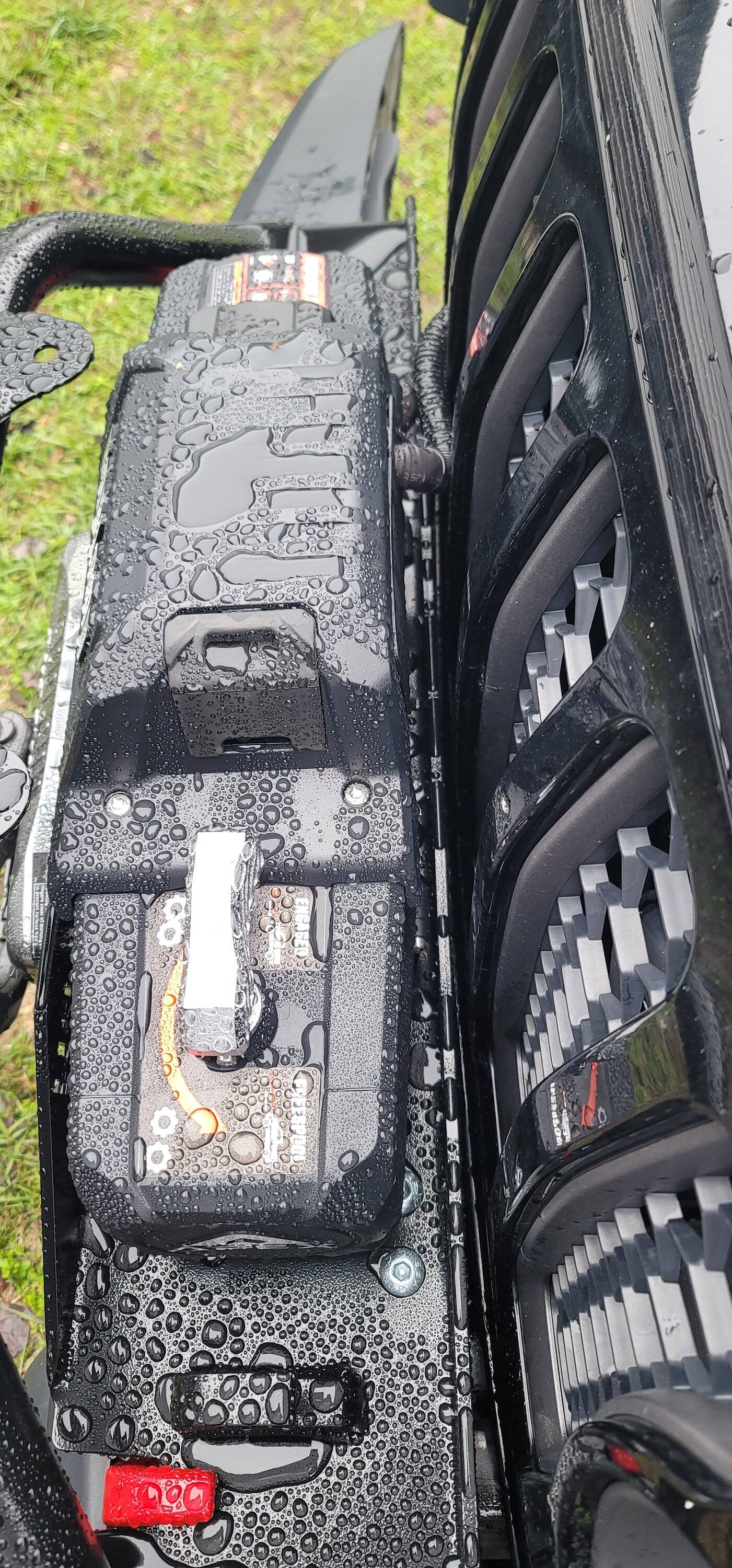

how much clearance is there between the winch and the grill?

Trying to show a reference with a finger. The winch itself there is plenty. With the first plate I tried the power cables were smashed against the grill and had I kept with that one I would have relocated the relay box. This one allows plenty of room and I simply fed the two large wires through a grill opening very easily
What was the first plate you tried? I was only aware of the one you have now.

I tried the Rugged Ridge 11543.16 Spartacus Winch Plate; there wasn't anything wrong with it and it fit. There is a thread showing someone using ?? plate and modifying the factory bumper by cutting it to go around it. With the winch I have the plate for that attempt to do the same mod didn't matter. With this winch jammed against the grill if I cut this bumper to go around it there wouldn't be anything left of it so it was get another bumper or a different mount type. This plate randomly popped up on a YouTube suggestion and I watched it several times and decided to send the other back and try this one. This one uses the factory hooks as part of its anchor or mount. I would have preferred to keep those usable but with everything I looked at there is always something not perfect. They include two new hooks on this plate so you still have your hooks. I'll be looking at painting the new hooks red eventually
