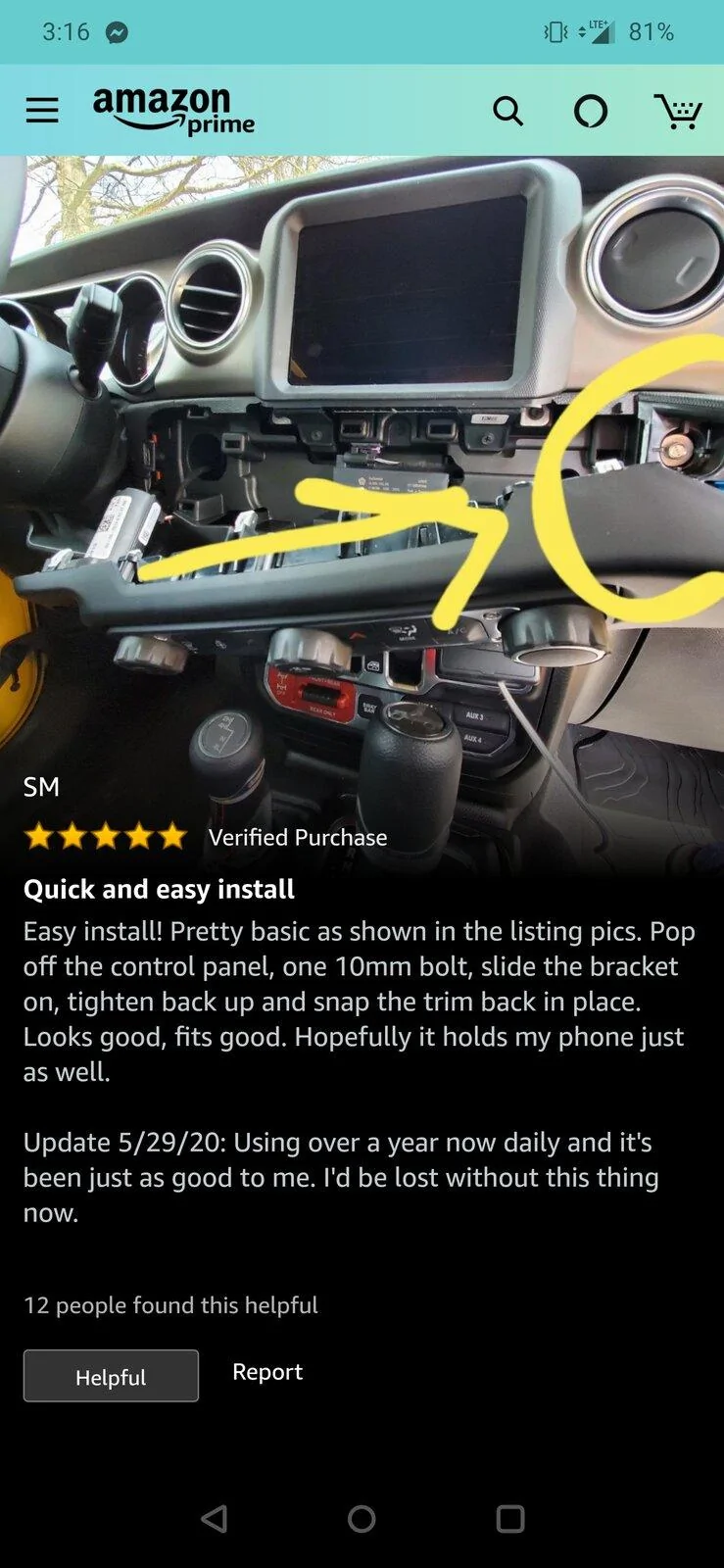

It says on the directions to use a 10mm. I had to take the trim bezel off to get to the bolt. The whole thing thing comes loose but bolt head is stuck to the trim. This screen shot isn't my JT but this is what I mean.

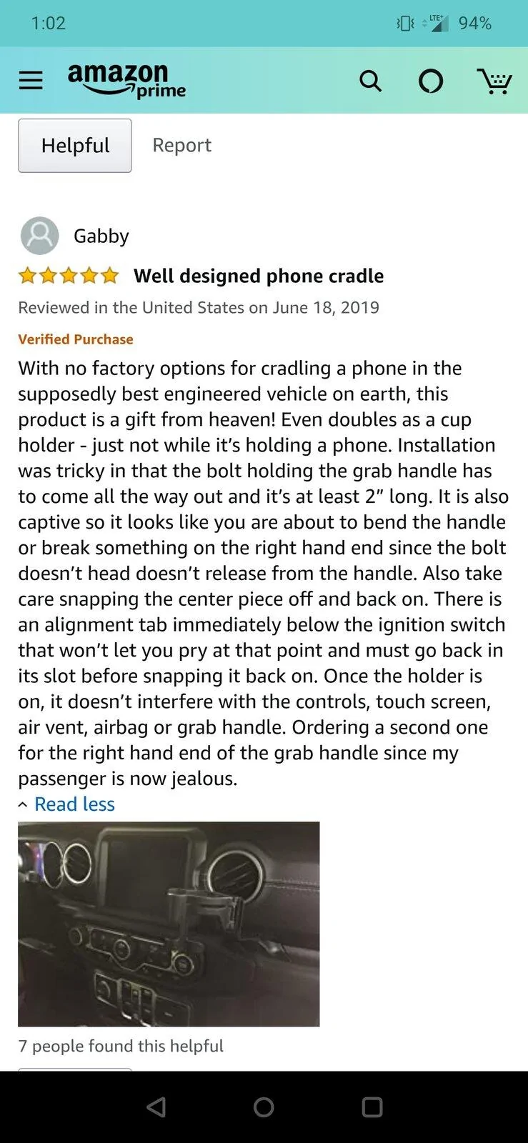

I just read someone that had a similar problem on the screen shot below. I might have to resort to this.

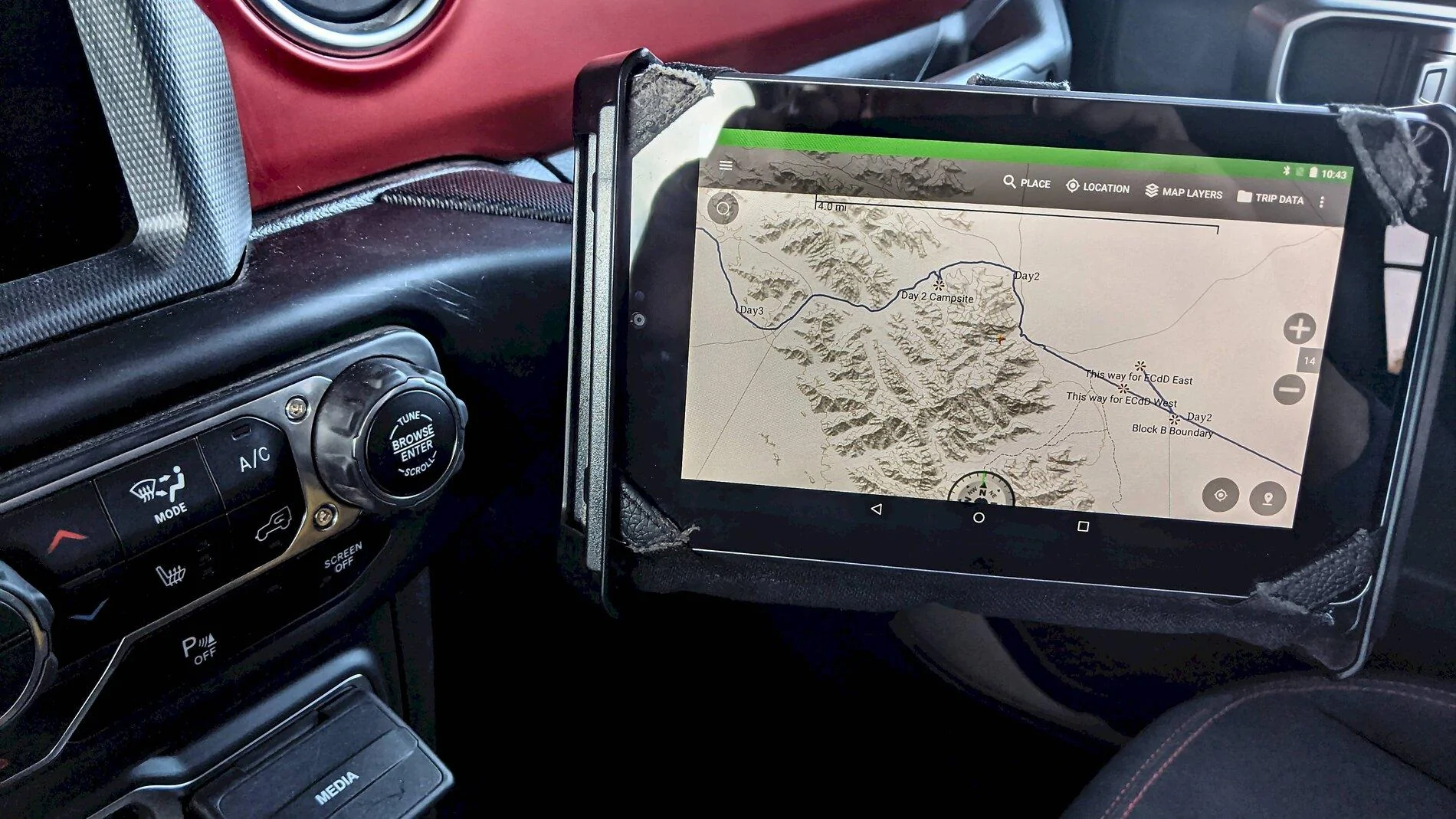

I was wondering why your install is so difficult while mine (for a tablet) was relatively easy. However, apparently this solution won't work on leather interior vehicles, which I presume yours is ...
https://cmmoffroad.com/collections/grab-bar/products/jl-grab-bar-ball-mount

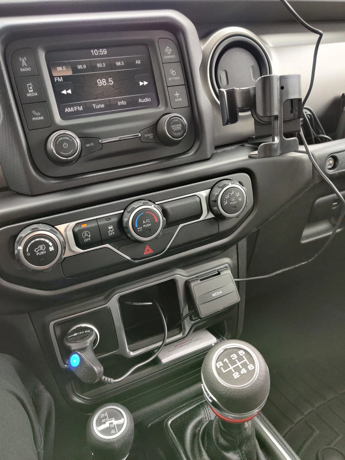

That's not where the mount to my holder goes. You have to take off the AC trim bezel off to get to it. look at the above pics I sent and you can see. I finally got it on last night when I got off work. I had to slightly pull back the other arm of the grab handle to get the long bolt in back of the bracket. PIA but works pretty good with my phone.

Ive had this same holder since I bought the JT. Had zero issues with install (or any time I've removed it for stereo related things)
I'm not understanding the exact issue you're having. But maybe I can help, with a little clarification
PM me if you want
