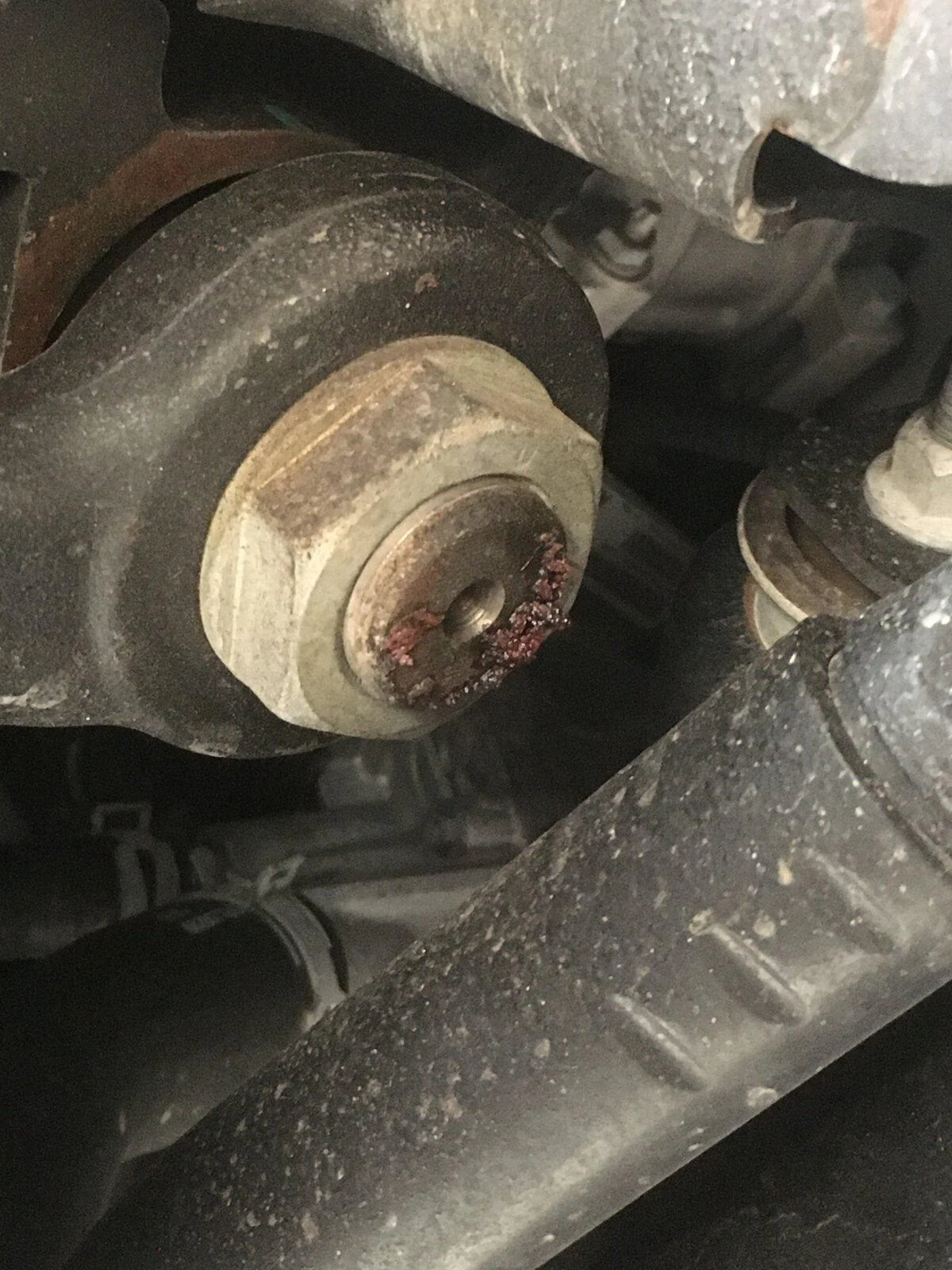

It made me think about it as I was rolling around under the truck retorquing all the “loose from factory” suspension nuts and bolts, front and back, and I noticed a smear of red grease on the bottom side of the large pitman arm nut at the base of the steering gear box. Odd place for grease to hang out. ??
Jeep Gladiator Grease Zirks E45E581A-DAEE-4464-8A29-A8A6DE1B17B9
sure its not red loctite?
