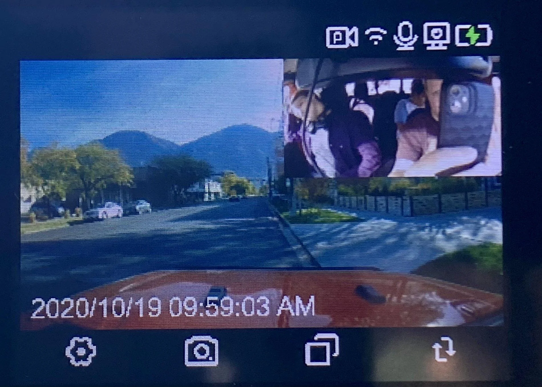

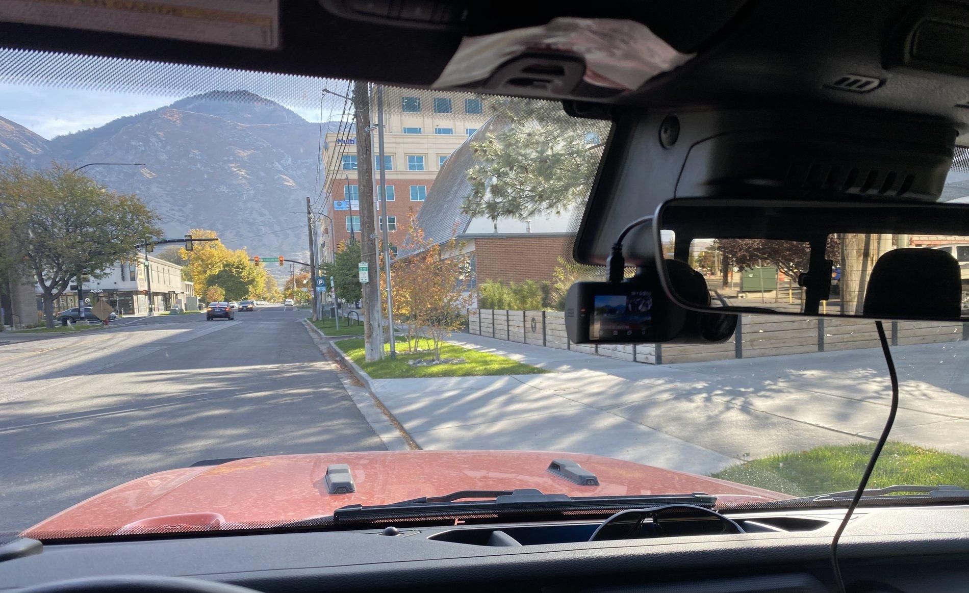

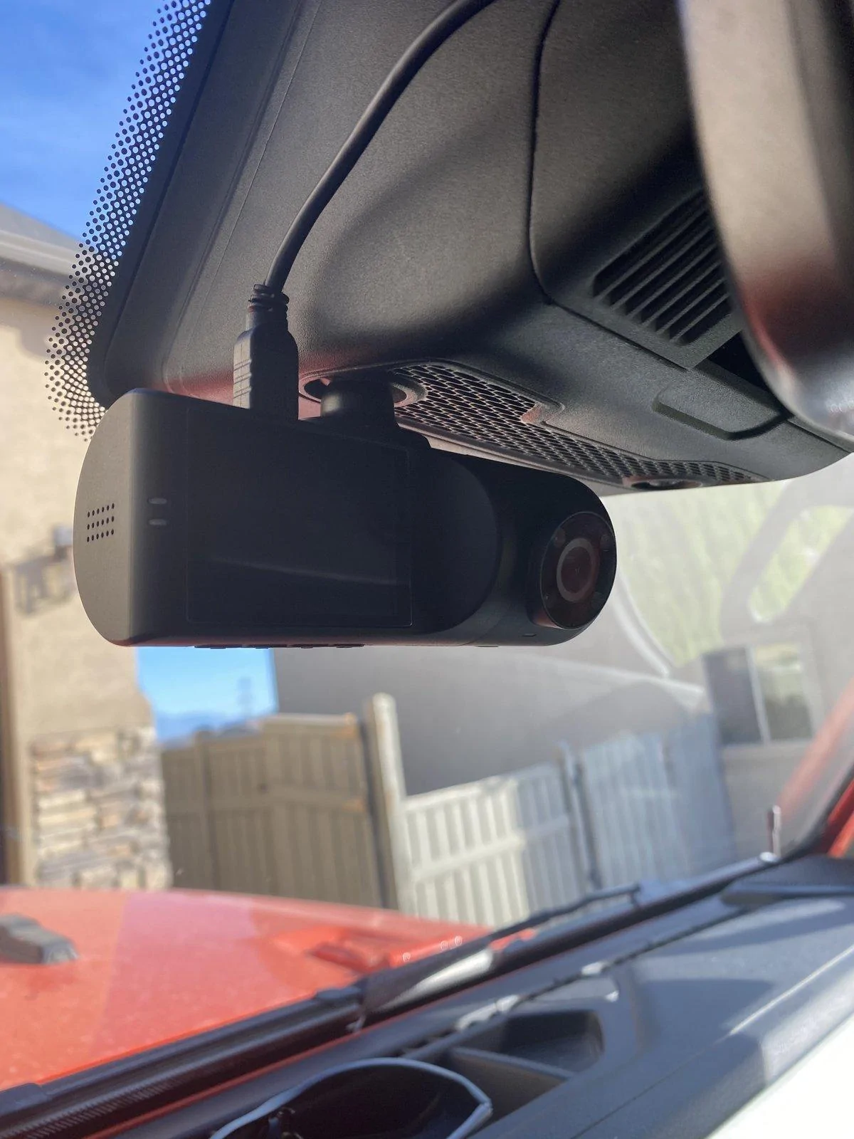

I like that - can you show pics of front and rear camera view? As well as how it looks to you from the drives seat, how much it is visible behind the mirror. Also, can you provide detail on what you did to the mount to fit it to the housing. Thx!

Here are some more pics. I removed the metal plate from the mount (4 tiny screws), then removed the ball joint (one screw). That left just the part you see mounted. I found a screw that had a head big enough to not come out the hole and a thread diameter big enough to grip the expanding part of the fastener in the box. After screwing the mount on, I put the metal plate and four screws back on.
I still havenā€™t run the wiring, but Iā€™m planning on adding a socket behind the dash for the adapter.
