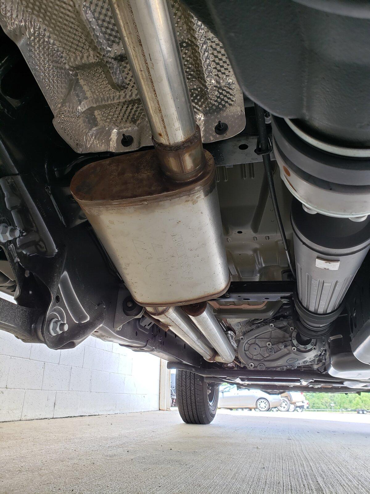

So I cut out the front resonator and the suitcase muffler and the sound was great. But, had a drone around 2100 rpm. Added a 32 inch j pipe and the drone is gone. The exhaust is now exactly what I wanted. Nice tone cruising (actually you don’t really hear the exhaust) and a nice sound when you get on it.
Had help from another member on here who went through the same process and he likes his exhaust mod also.
So, for $200 approximately, you can have a really great sounding exhaust. I had a local shop do all the work.

Front resonator and suitcase muffler removed. 32 inch jpipe on mine. Still liking the sound and don’t see any reason to change anything. My jpipe probably looks more like a u, but shape is not critical. Only the length is critical.
Make sure when they install the jpipe the blanked off end is a little higher than the end attached to the exhaust. Keeps any moisture from collecting in the jpipe.

I actually removed the front resonator and muffler and put a single Magnaflow it it's place. It's not as loud as replacing with a straight pipe but definitely louder than stock. I recently took it from TX to FL and was glad it wasn't any louder.

If you are trying to go a little quieter and a little cheaper, try just removing the suitcase muffler and leave the two resonators. This might not drone and give you some sound.
