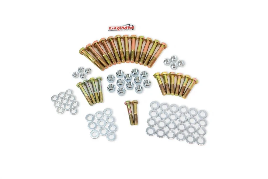

The new Grimm Offroad 10.9 Bolt kits for the JT suspension are in stock and ready to ship:
https://www.northridge4x4.com/part/hardware/10049-grimm-offroad-hardware-upgrade-kit
Jeep Gladiator Grimm Offroad Grade 8 Suspension Bolt Kits are Now Available! gor10049
Installation instructions are here: https://support.grimmoffroad.com/Guide/JT+Hardware+Upgrade+Kit+Part+Number+10049/10

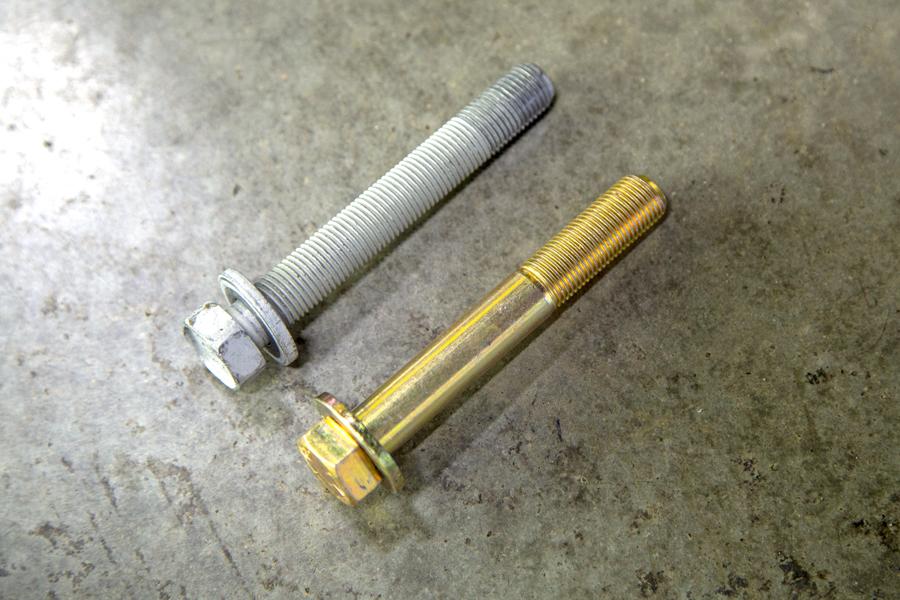

These bolts are slightly larger in diameter, which will help tighten up the oversized factory holes in the frame. They also feature a large non-thread shank instead of a fully threaded shank which will help keep tooth galling and chatter to a minimum.
Jeep Gladiator Grimm Offroad Grade 8 Suspension Bolt Kits are Now Available! Grade-8-Comparison
OE bolt on the top left, Grimm 10.9 bolt on the bottom right.
As hardware starts to loosen up over time, the threaded portion of the OE bolt will wear both the OD of the threads and the ID of the suspension bushing, making the joint sloppy over time.

OMG! Alright...you got me! It's an early April 1st prank right? I'm so glad that a "kit" comprised of some grade 8 bolts (24 to be exact) WITH washers and nuts are back in stock because the countless JT owners out there were SOOOOO excited to part with $160!!!!!!

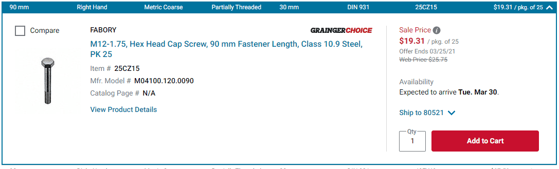

This is a little closer...

The bolts are all metric 10.9 and yes, you can go online and source all these bolts yourself.
Grimm just made it easy by putting them all in one package.
