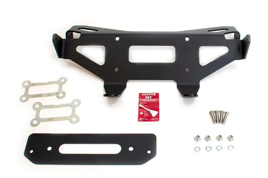

The much-anticipated release of the Grimm Offroad winch plate is here and we think you, the Jeeping community, need to know!
Grimm OffRoad’s Jeep JL Wrangler and Jeep JT Gladiator winch plate is designed to mount a winch into the stock Rubicon steel bumper. Laser cut and CNC formed from 1/4 inch high strength low alloy (HSLA) steel, there is no stronger winch plate on the market.
  • Winch plate for mounting a winch into the stock steel Jeep Rubicon front bumper
  • Laser cut and CNC formed from 1/4 inch high strength low alloy (HSLA) steel plate
  • Cad Designed and FEA tested to withstand up to 14,000 lb. pulls with minimal deflection and no deformation
  • Integrated fairlead backing plate and includes fairlead faceplate
  • Installs with simple hand tools with no vehicle modifications required
  • Allows mounting of winch plate on vehicle before installing winch
  • Accepts most center mounted winches with standard 10 x 4.5” bolt pattern
  • Black 2-stage powder coat perfectly matches the stock Rubicon bumper for a factory look and offers superior corrosion and wear resistance
  • Made in the USA
  • Limited Lifetime Warranty

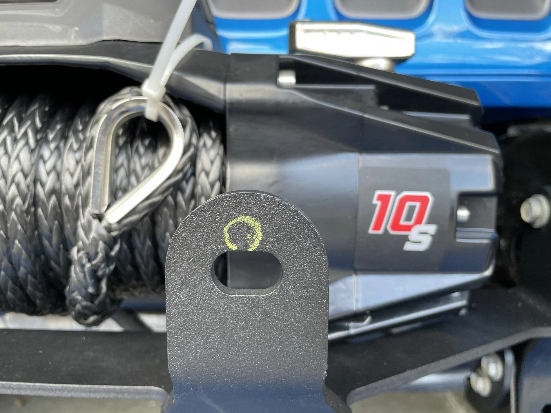

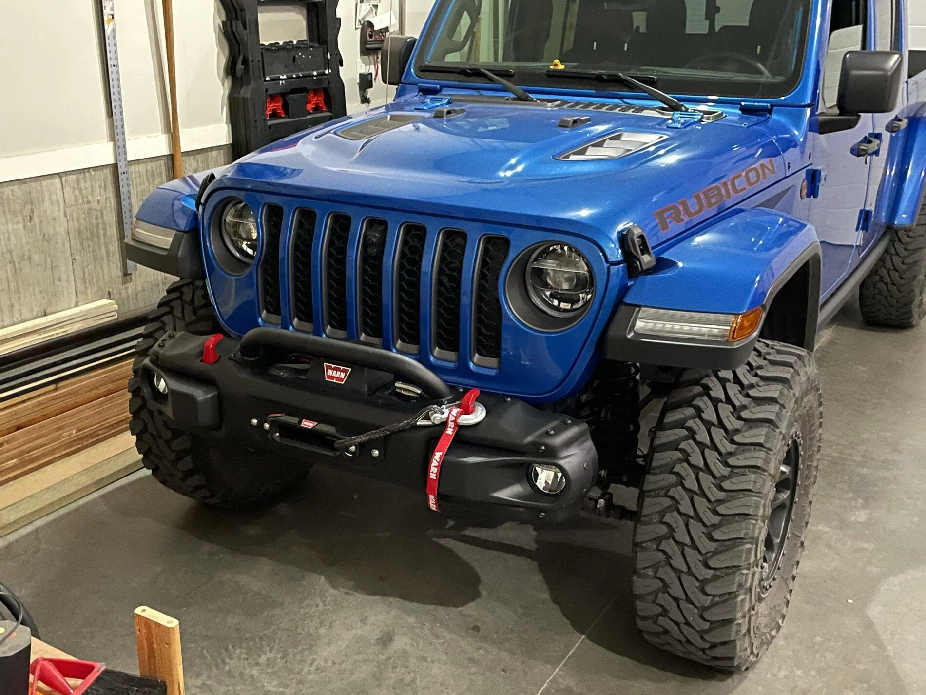

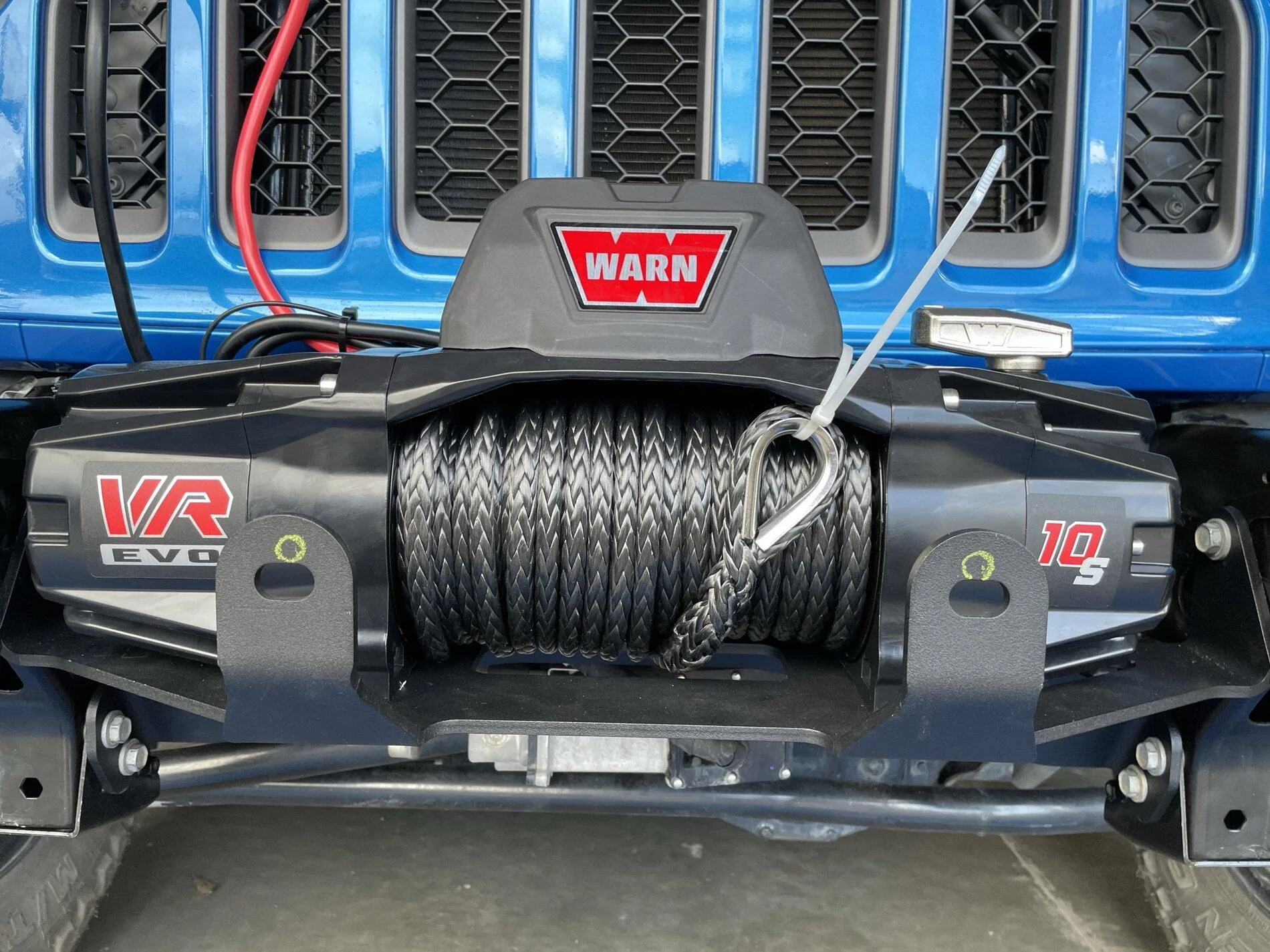

Ok I did the install and I’ll give the product an 8/10.
Pros:
Very light weight compared to the Warn or Mopar winch plates. This thin couldn’t be more than 10-15lbs at best.
Love the fact that it is a one pc design.
Cons:
The holes to mount the fairlead did not line up at all. Luckily in my previous lifetime I was a machinist and had the proper tools and know how to deal with it.
Also I followed the Northridge install video fo the wiring and removing the fender cost me six broken tabs. If your going to do it this way either take the time to remove the fender liner so that you can pinch the backside of the tabs or make sure you have plenty of replacements on hand.
