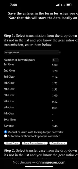

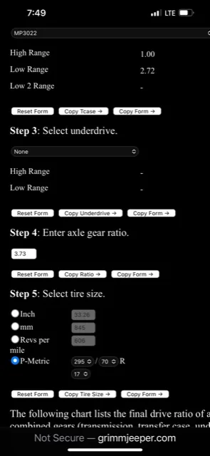

I'm I doing this right? I'm trying to decide which tires to pick for my '21 JTW with 3.73 gears. Stock 255/75r27 are 32.1 inches. I'm looking at moving up to a 295/70r17 which is around 33.3 inches. I selected the Dodge 850RE tranmission and the Select Trac MP3022. Are this the correct choices for the 8 speed?
When I enter the new tire size 295s the engine would be revving only 63 RPM less than running the 255s with the stock 32s. To me that seems negligible so I'm wondering if I'm doing something wrong with my inputs.

The Dodge 850RE has different ratios. Your 850RE is a 0.67 overdrive.
But your RPM difference is accurate.
You can calculate another way:
255/75/17 (32.06" tall) to 295/70/17 (33.26" tall) is a 1.2" change or 3.74%.​
1,688 RPM x 1.0374 = 1,751 RPM​
1,751 RPM - 1,688 RPM = 63 RPM difference​
