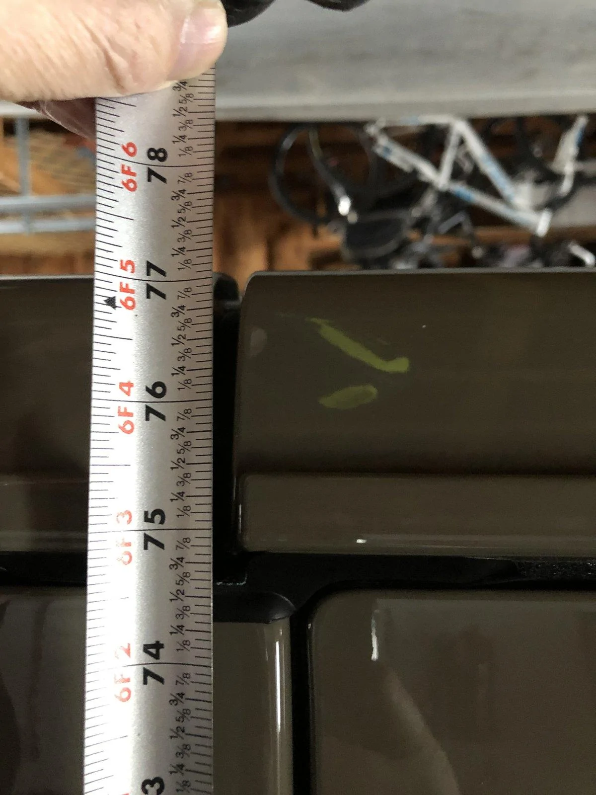

I have 2" Mopar lift with 1.5" Daystar leveling kit on the front only (I expect to drop 1/2 to 3/4's after I add front bumper and winch) Running Nitto Ridge Grappler 37x11.50R18LT D 127Q tires on Fuel 18x9 wheels. Total height is roughly 77.5". You can see the top of the drip rail is roughly 75.5" between the front and back doors.

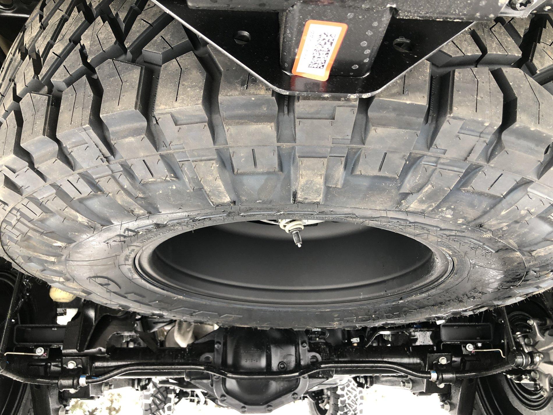

Matching spare fit below the bed fully aired up.
