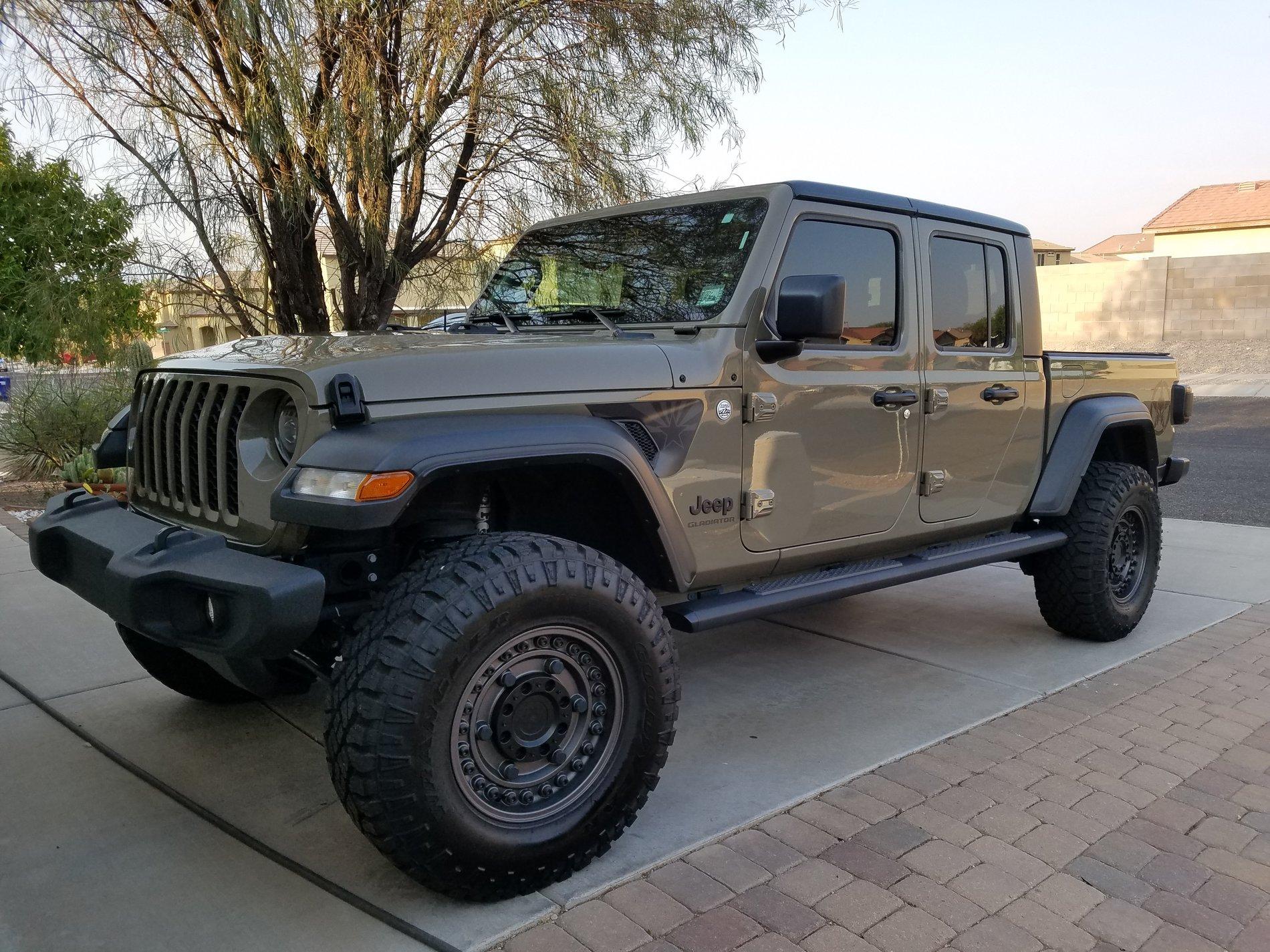

Oh, and I couldn't pass up an opportunity to post a pic of my rig.
Jeep Gladiator Had my Uconnect acting weird today. 20200821_174033

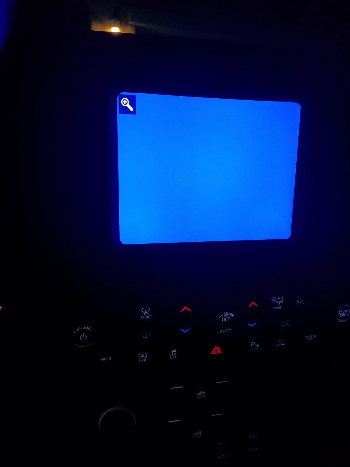

I wanted to update this thread in case anyone else is having similar issues. The bottom line is that it's not fixed!
Okay, Iā€™m now 3-week on from my new radio installation and Iā€™m having issues. I just returned from my local jeep service department and here are the issues and what they said about them.
  • I no longer have a Userā€™s Guide app available. I click on the app and it just tells me it is unavailable and I should check back later.
    • The service department says it is a Uconnect issue and I should continue to wait and it will be available soon.
  • The original issue that started all of this happened again yesterday morning as I was heading for work. My screen was totally blue instead of getting the backup camera and when I put the transmission in drive, the music turned off and on in a 3-second cycle.
    • The service department says this is also a Uconnect issue and per a memo dated early September, ā€œthe engineersā€ are working on a software fix.
  • Now, all of a sudden a few days ago my Sirius Radio quit working.
    • I contacted the folks at Sirius and they verified that my trial membership is valid until February and sent a ā€œrefresh codeā€ to get it working again. I had the code sent several times and nothing changed.
    • I contacted the folks at Uconnect and they say they are working on it.
The bottom line is that I am now being told that replacing the radio was a waste of time! Iā€™m being told that it has now been diagnosed as a software issue. I have been working with a case manager at Uconnect and hope to have something worked out soon.
It happened again this morning: As I put it into reverse, the screen was totally blue (no backup camera) and when the music came on is cycled off and on.
Here's a video of the issue
(it sounds like I'm moving but I'm sitting in reverse with the top and doors off in the wind - lol)

I don't think anyone is following this thread, except for the Jeep cares people (thank you btw) but I figure I'd post an update in case there is anyone that has this issue and finds this thread while searching.
Even after the radio swap and supposed software upgrade, the issue still remains. On Oct 20th, I backed out of my driveway and it happened again. I pulled back up the drive and started filming just so I'd have a record. I contacted the Uconnect folks who got their "Stat Team" as they call them as well as the dealer service department and took my rig in last week. I picked it up yesterday and they said they swapped out the back-up camera and harness. They found a kink in the harness so they are now "sure" they have found the problem.
