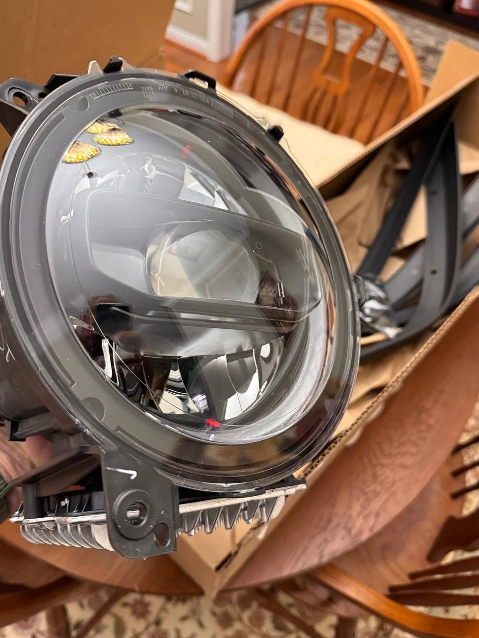

I recently went with the blackened lights. Here are the part numbers, including the jumper harness. I have a 23 Rubicon and did not need the jumper harness. I ordered because there is no rhyme or reason as to if you will have it or not. The headlight will work with just the 3 wires but the 4th is for the Halo ring.
https://www.allmoparparts.com/sku/68596461aa.html
https://www.allmoparparts.com/sku/68596460aa.html
https://www.allmoparparts.com/sku/68414409ab.html
I used the Tazer and it is an easy change.
https://www.zautomotive.com/product/z_tzr_jlm/#camera-kit
I'm glad you posted pics of the blacked out headlights - that's what I'm going with.
I'll order the harness as well, just in case.
Thanks!
