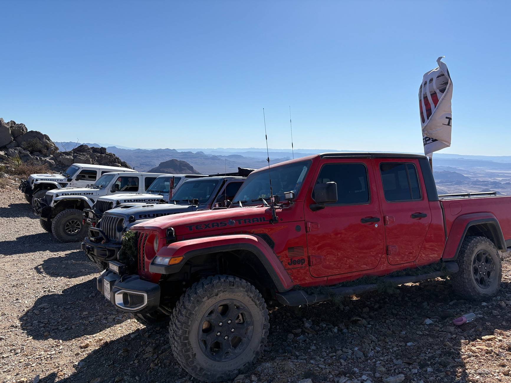

I'm in Dallas and had a HAM license for over 10 years. I have been on and off with 2m & 440 activity. I've got several HT's of FRS and Bofwrong radios.
But, I just took the bullet this Last Black Friday and got a Yaesu FTM-500. I love it!!! It's a hugh upgrade from my Kenwood TM-D700.
I love the SD card option to program the radio (or backup) without buying additional programing cables, however I did buy the RT Systems software to enter in all the frequency's that I want to use.
I love the 20 channel scanning ability on the 2nd band, while maintaining a main frequency.
I also like the GPS receiver in the headunit so I can hide the radio body out of sight. My head unit is Velcro mounted to my dash.
I did pair the FTM-500 with Comet CA-2x4SR Vertical antenna, I went NMO with a side lip mount on the hood.
I recommend the FTM-500 for your ride!! you can't go wrong with it, IMO.
