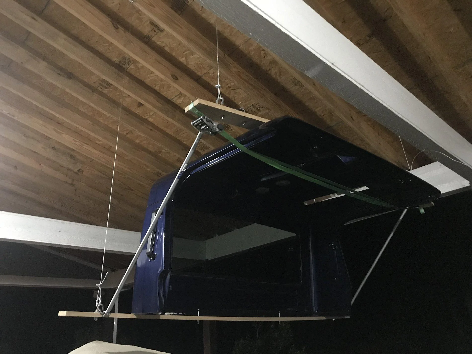

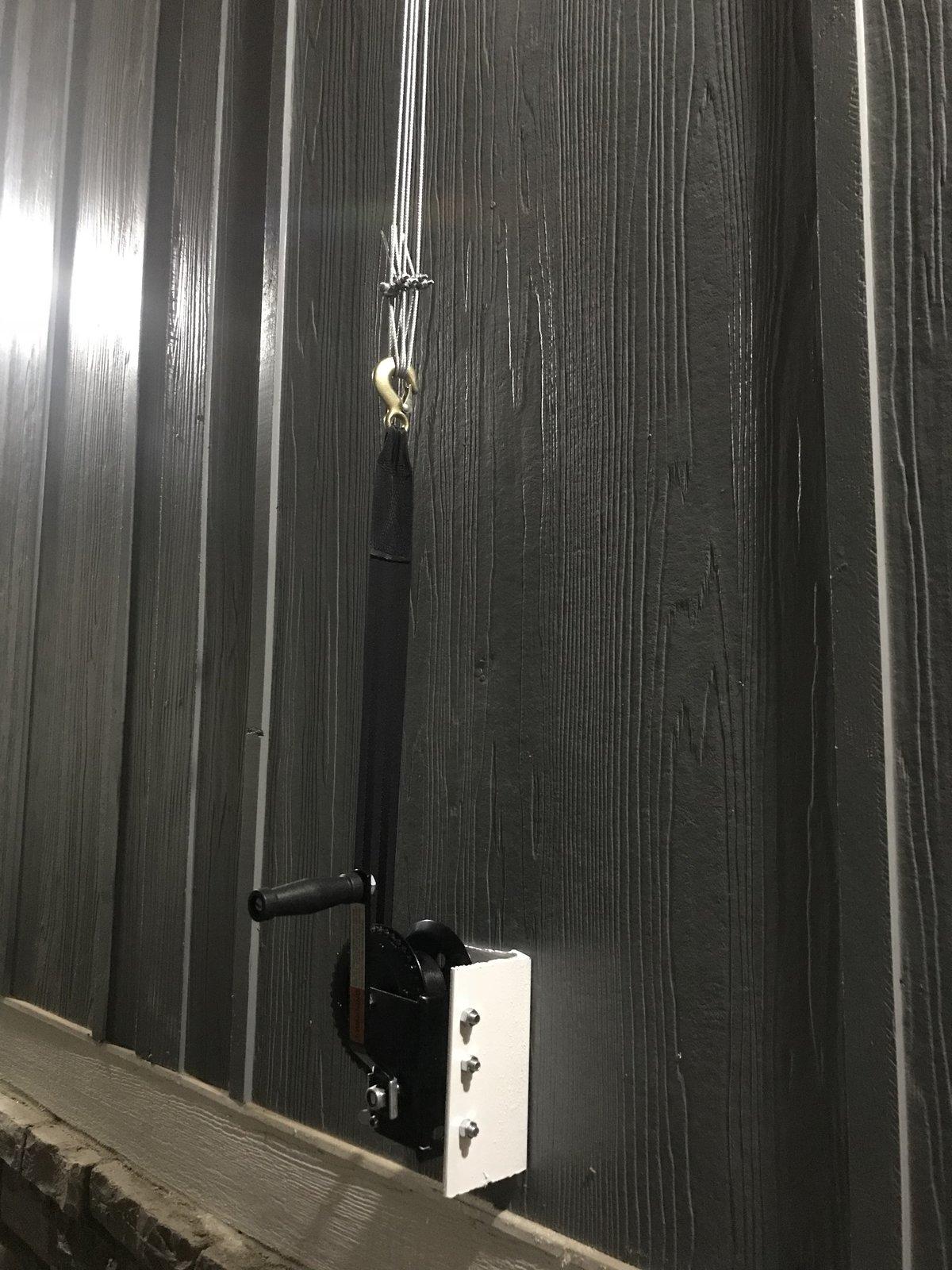

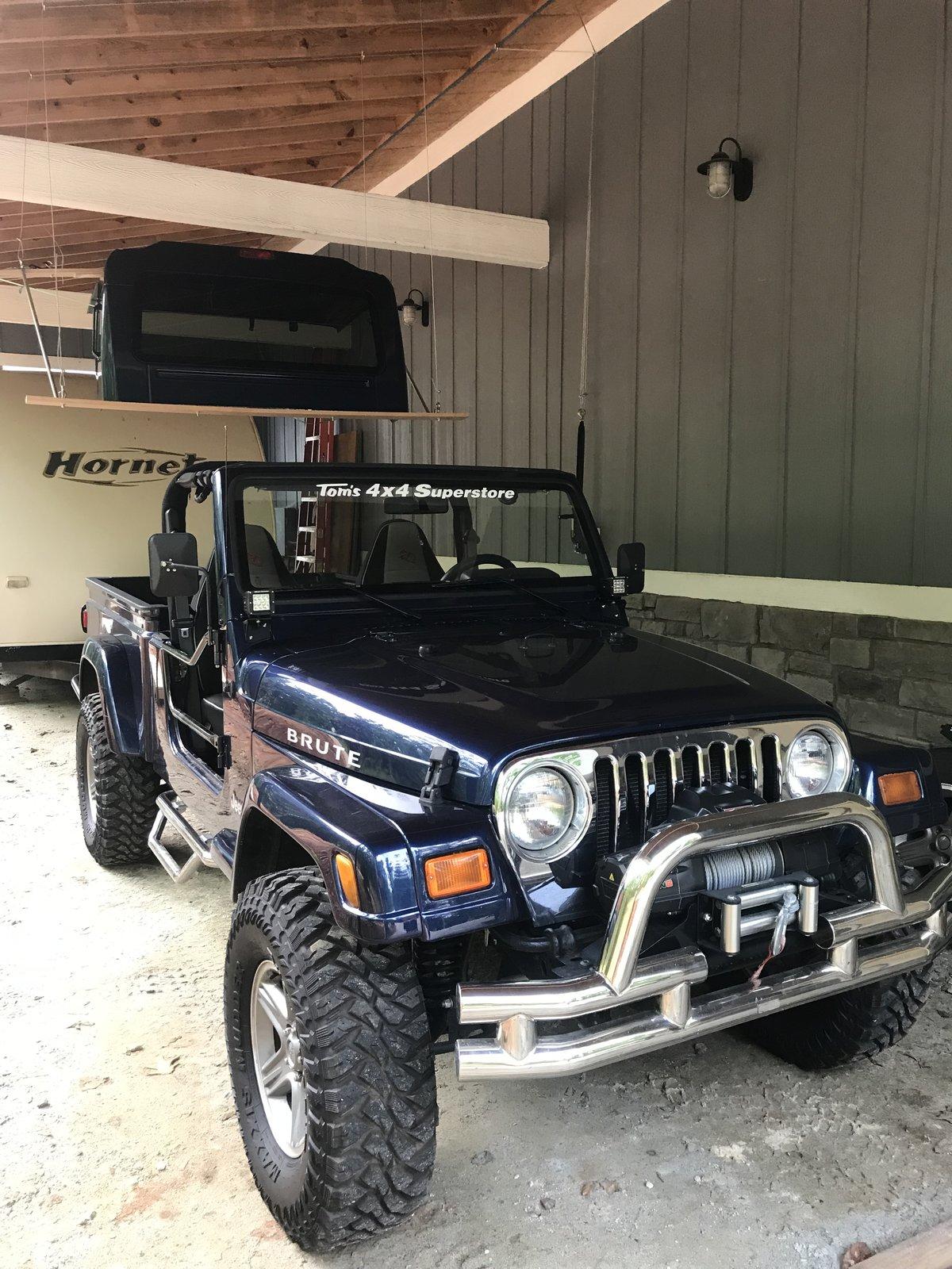

I spent a bit of time last year figuring out how to get the top off of a 97 TJ (converted to an AEV Brute). The lifts available wont work with this top because they’re designed to hoist a top that has back glass that lifts up.
I bought a boat-trailer winch & several eye-hooks, installed them and ran pieces of string to figure out how long my cables needed to be. I bought 1/8” cable and ran it through the eyes. I bought an oak 1x4 and installed an eye on each end to use to lift the back and I bought another and installed eyes to lift the front.
I put it all together and it works like a champ. All for less than $50.
Just in case anyone wants to do a DIY hoist.

I did a similar thing for my Yakama roof rack so I can easily take it off when I am not using it. I just don't have all the pully stuff and drop it on my car myself. It has saved me alot of pain, lot easier just lifting or dropping 4 inches instead of from the ground to the roof of my SUV.

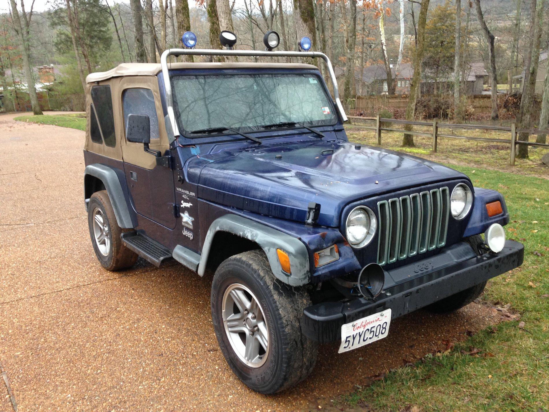

Pre-conversion, just after it came back from CA.
