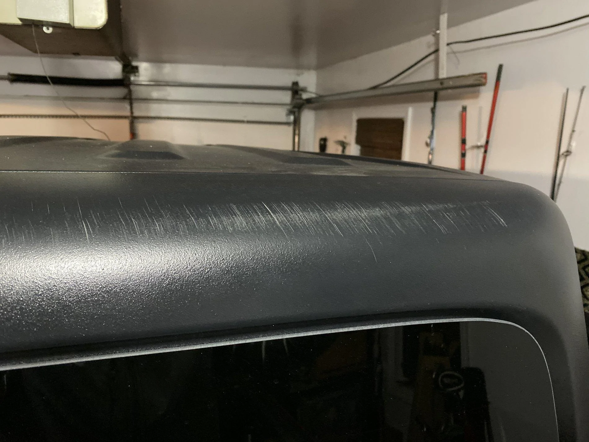

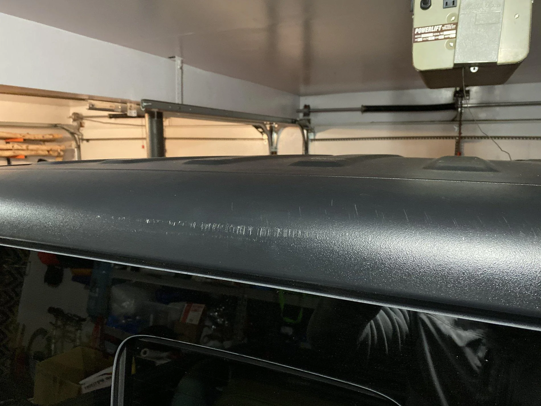

I backed into what I thought was an open garage ... one of the pulleys came loose and the door was a few inches down. Here’s the damage. Any ideas on how to repair?
I know there’s a touch up pen available for these tops but these are more scuffs than scratches down to fiberglass.
TIA

Sorry that happened to you. If I’m seeing in the pic correctly, the colour is not impregnated into the fibreglass shell.
I was going to say maybe 3000 or 2000
grit sandpaper. If that is white glass there that’s no help. There are a few brands out there of spray bombs with a pebble/grainy effect, Satin finish. Or...
There’s always a good body shop to stop by
and pick their brains. Good luck

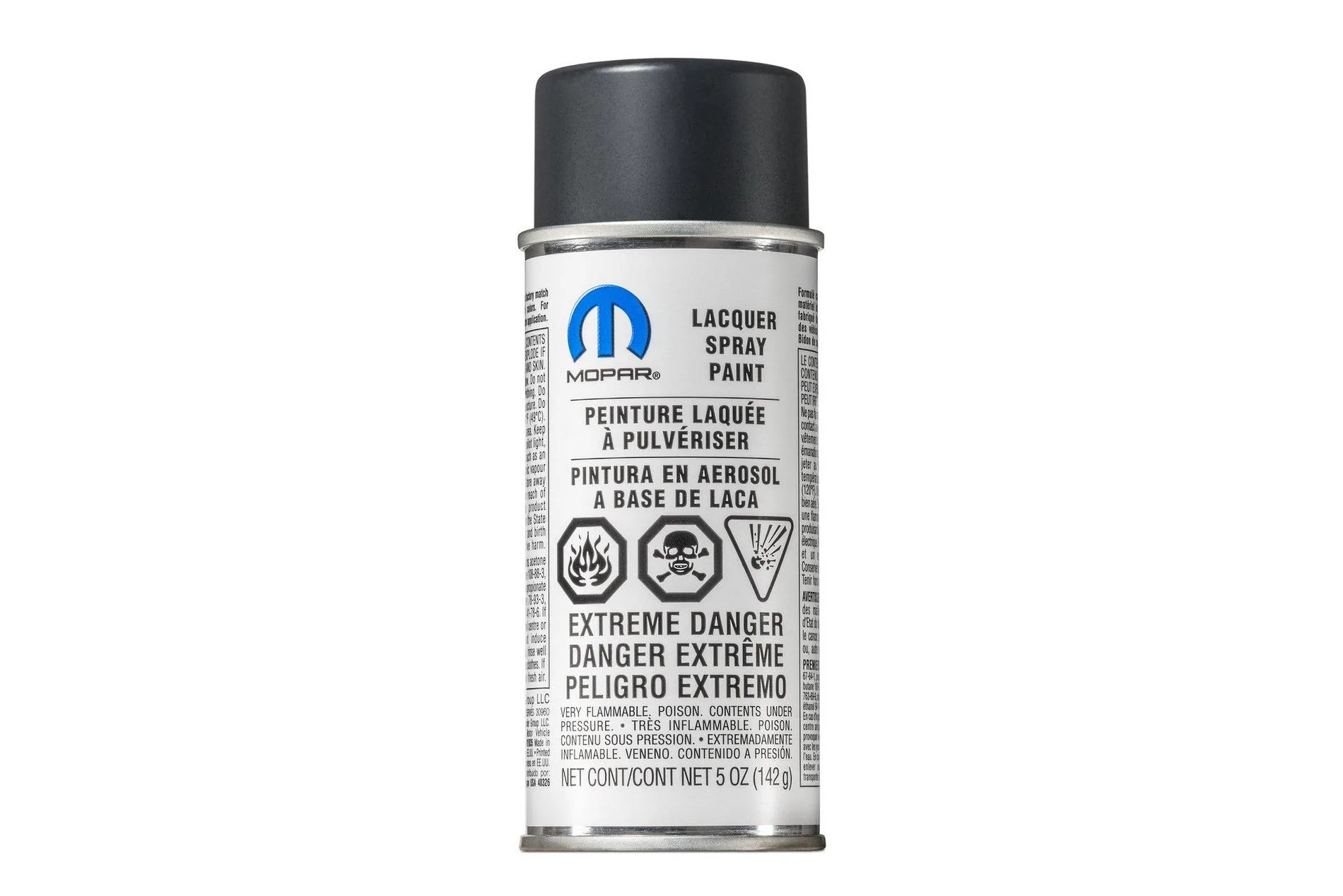

Thanks! i saw that. Any videos out there of someone using this?? Afraid it will leave the canned spray marks...
Mask well and use light but long strokes to blend. Don't lay it on too thick or it will be blotchy and/or run.

Magic Eraser might work
