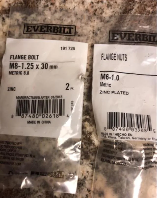

What hardware is needed to install the rubicon rock rails? I ordered some off ebay and it doesnt seem like they come with any hardware.

Someone else sent me this photo when I was looking. I believe you need 8 of the bolts and 16 of the nuts. I added washers for each as some of the holes are a little larger.

Wait a minute, why are the nuts a different size from the bolts?
The nuts go on bolts swedged to the rock rail that go through holes in the pinch weld. The bolts go up into threaded holes in the body of the Gladiator.

Got it, that makes sense now. Thanks!

Thank you, I got the wrong bolts from Quadratec. They sent M10 1.5’s. I saw this post, went to my local big box hardware store and got the M8 1.25’s which worked perfectly. Thanks again!
