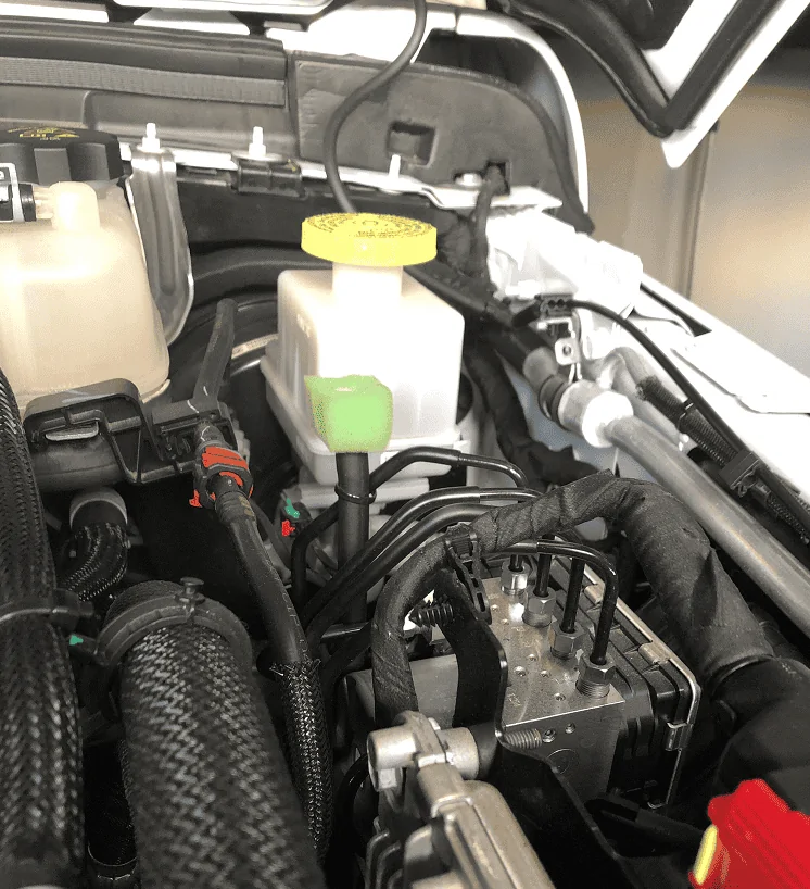

The front axle vent is in a rally bad spot (IMO), and the vent doesn't have any type of filtration to it. Even though I don't do any real off-roading with my JT, I extended the vent and added a piece of small engine air filter to it.

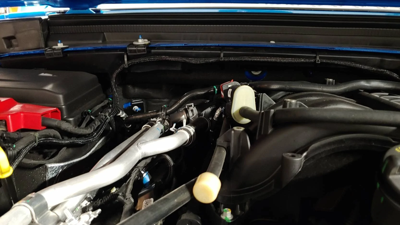

The ARB kit had plenty of hose/line in the kit.
On the front diff I just slide the ARB line into the OEM vent hose to run it up to the breather on the firewall........as I did with the rear diff.
I need to post up the pics before I get it stupid nasty next weekend
