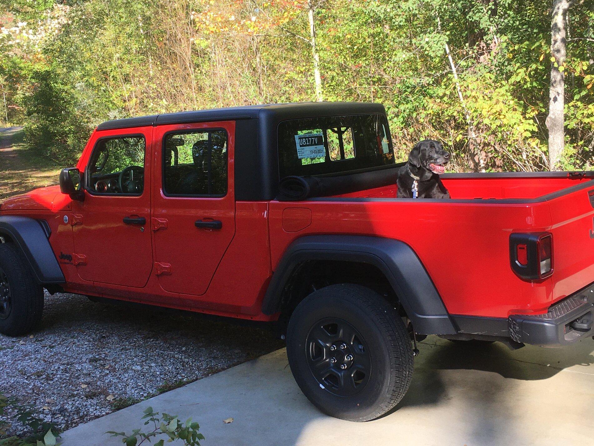

Ordered a manual Sport. Had it for a couple of months and like it. No plans to regear.
Of course, I bought Vlad (the Glad) primarily for snow and very mild off-roading (logging roads e.g.).
