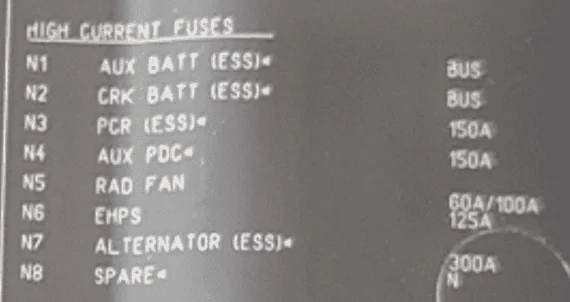

If you got sparks from the positive cable, there's almost no way you didn't blow the N3 fuse. If that's the case, it will run for a while until the aux battery runs down and then your stranded. Here's a link that explains it. https://www.jlwranglerforums.com/fo...on-and-ess-n3-fuse-warning.66247/post-1401203
Well I learned something new.
I had no idea that the N terminals all have fuses under them.
Side note, I swear I've heard that guy telling a story about a boat ride.
180
29,415
34,990
I think he was referring to the negative terminal cable sparking. It will spark!
>> I unbolted all the cables on the negative, they touched and sparked. <<
Yes, when the negative cables touch the negative post, it will definitely spark. That isn't a problem.
180
29,415
34,990
Not all do. N1 and N2 do not - they go straight to the bus, unfused.
N4 is empty - nothing connected to it. There's a fuse but the terminal is empty, it's an auxiliary connection if you need extra power from the PDC, fused at 150.
N8 is connected directly to alternator output, unfused.
