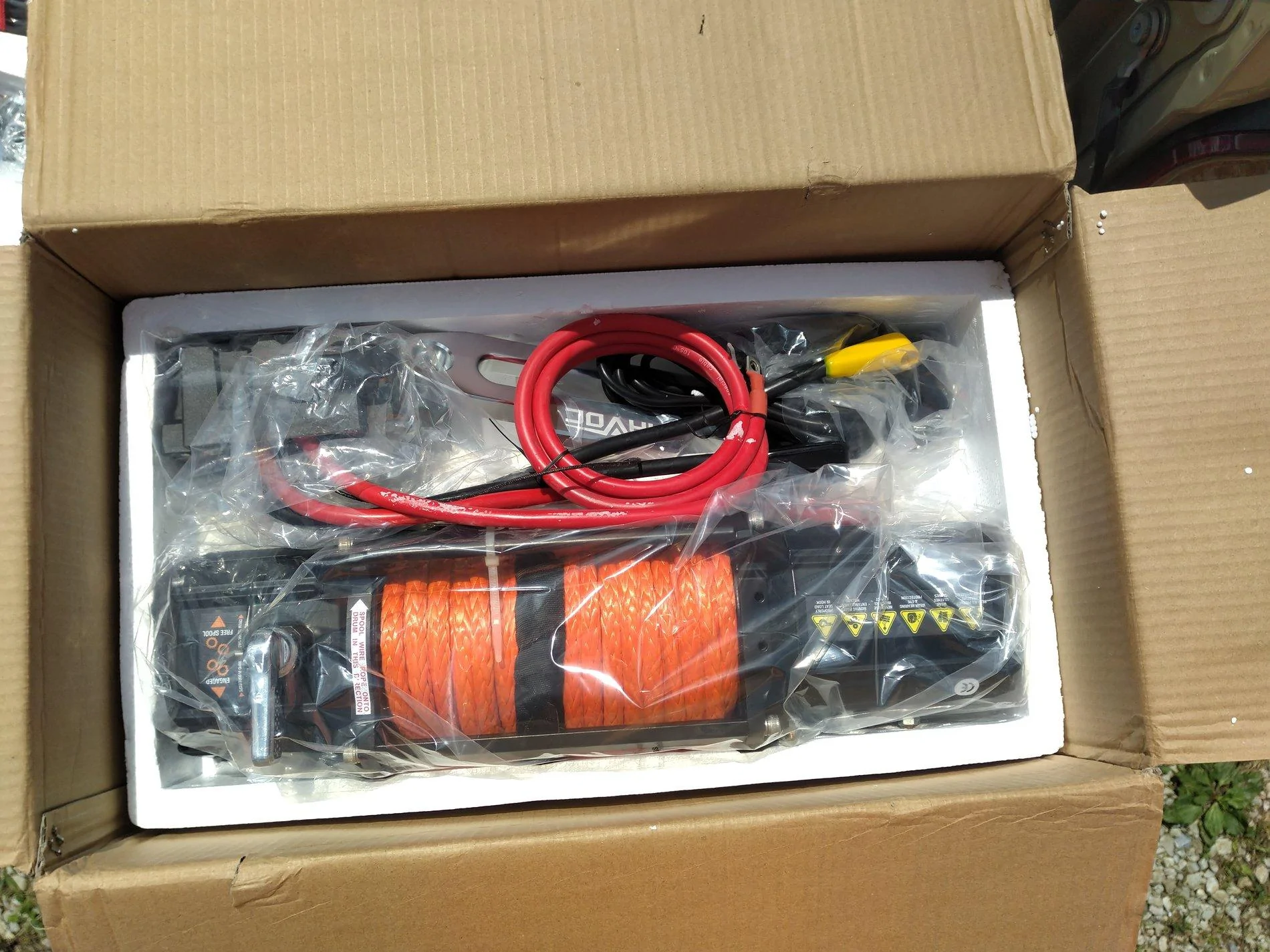

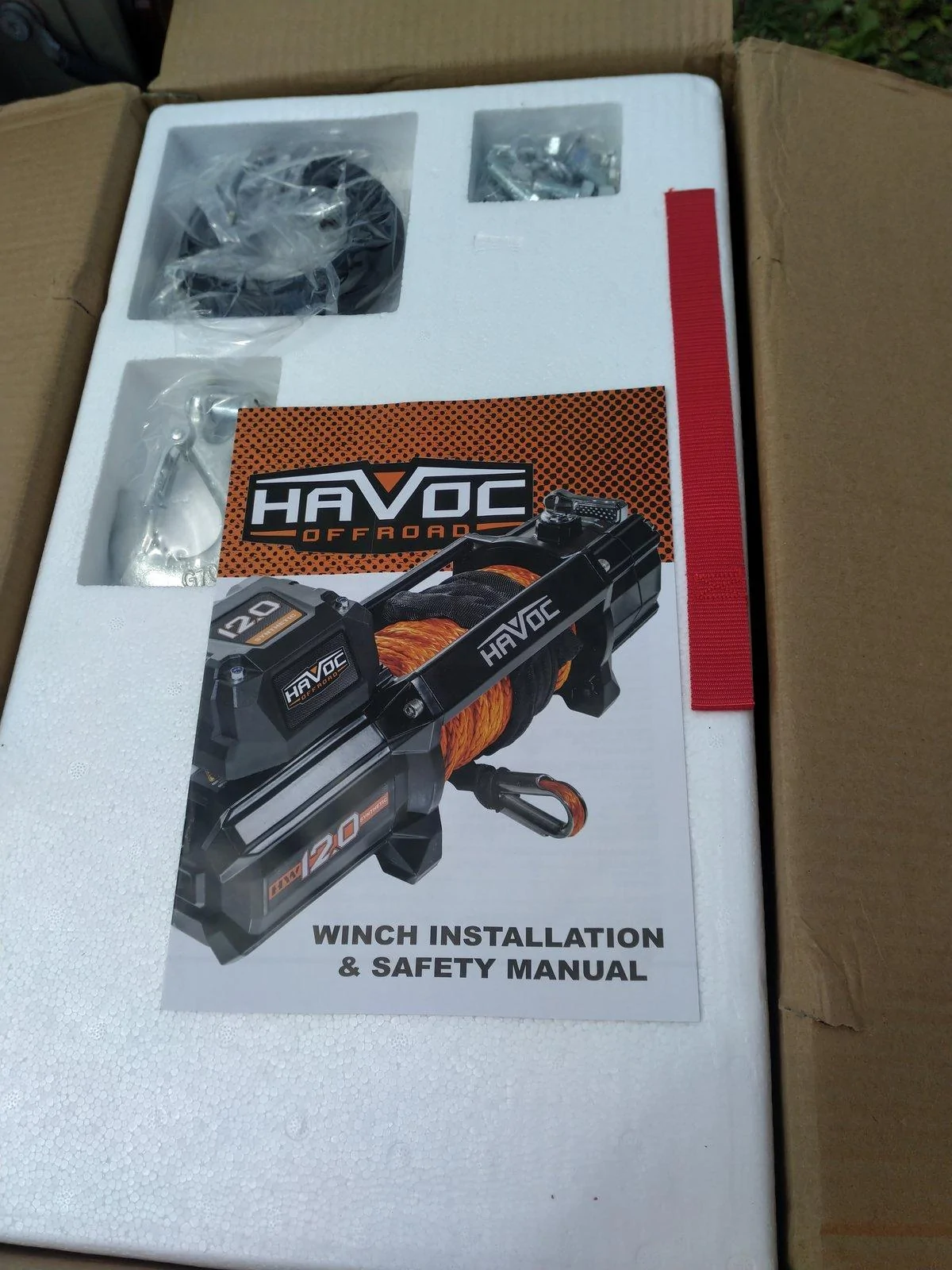

Delivered today but I have to go to work. So a quick inspection and check out.
Blade1668
Blade1668
Darrell
Jan 7, 2020
2,352
2,129
N. AL.

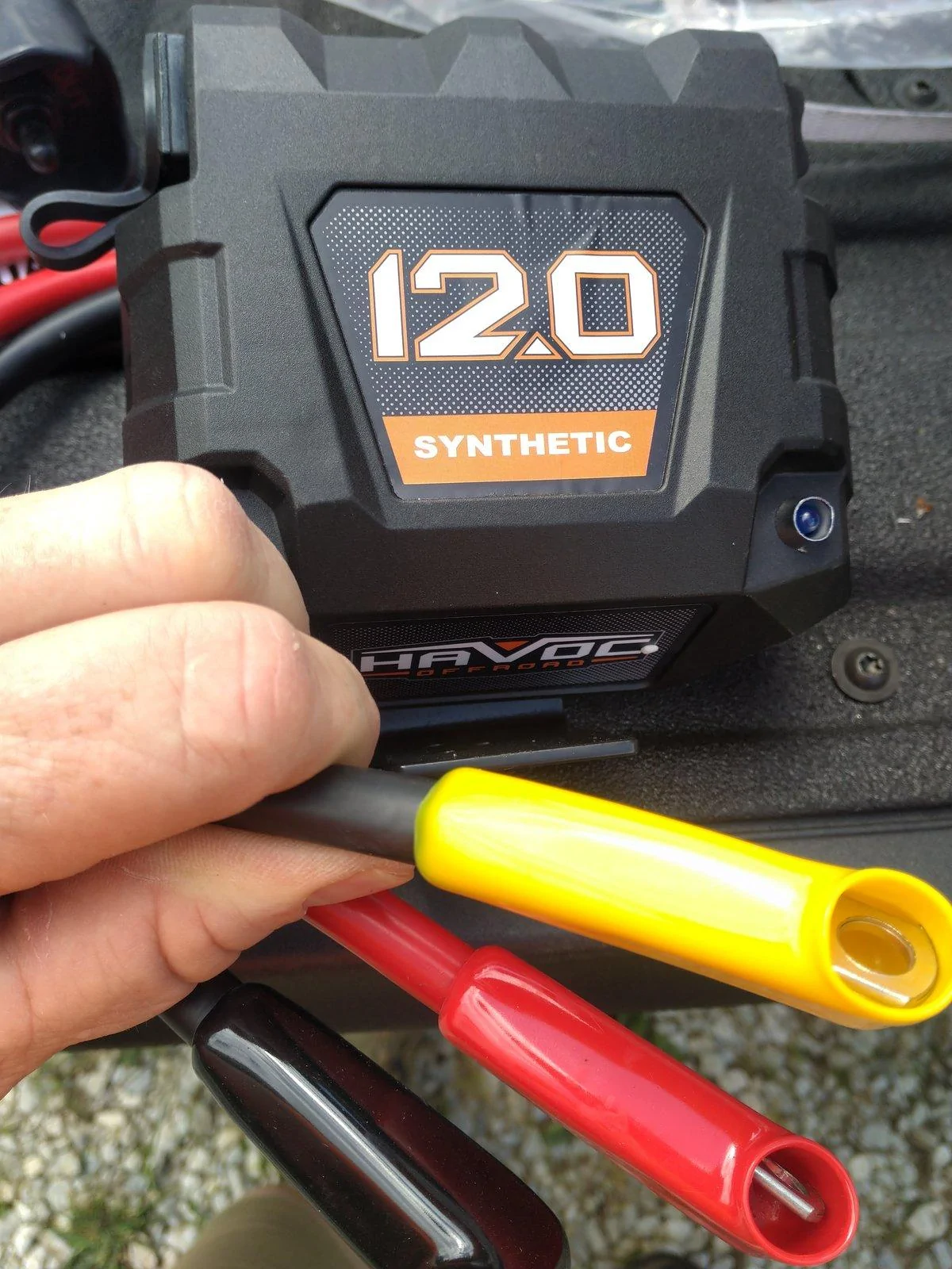

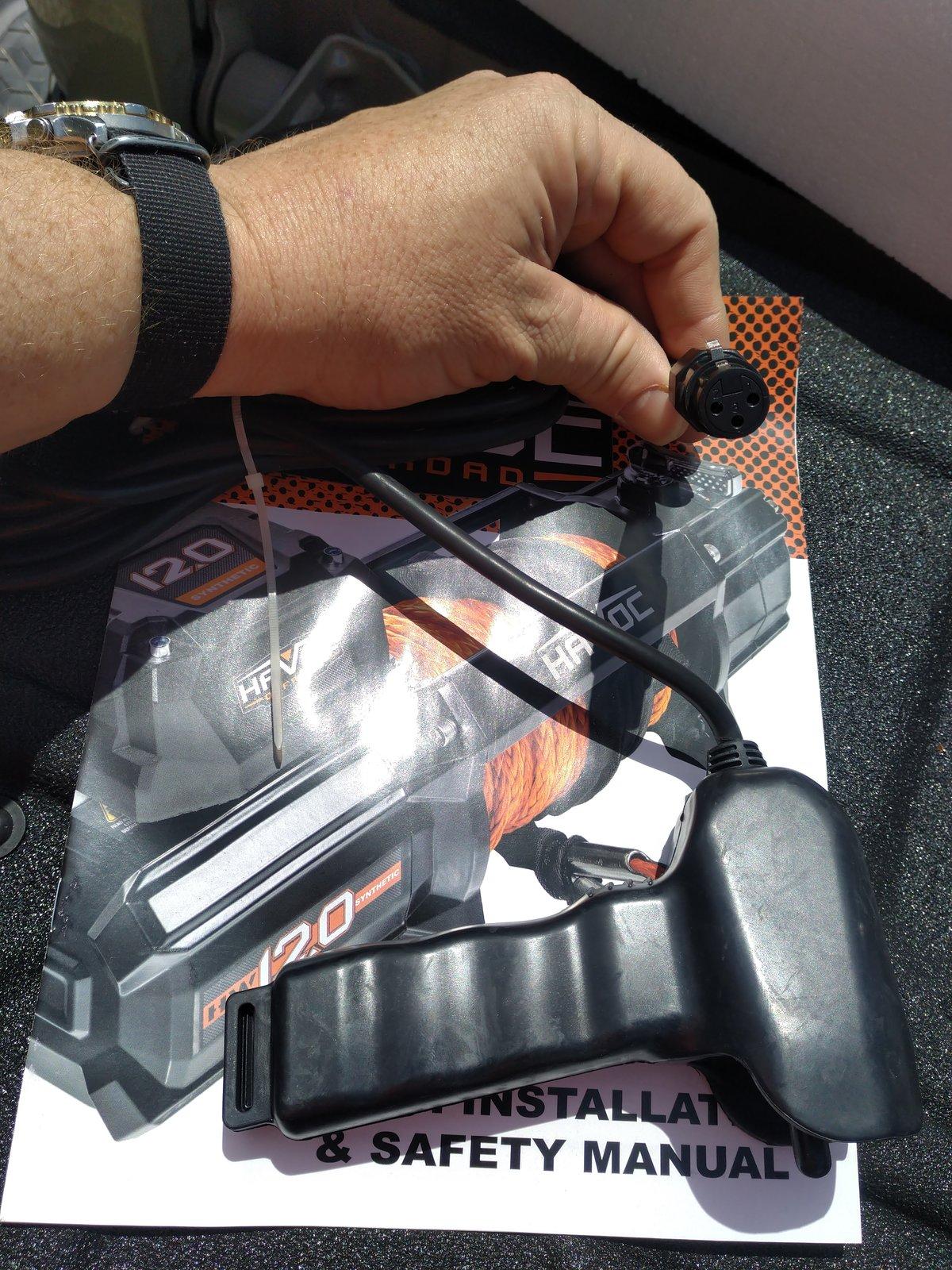

Controller look ok, better than some not bad. Cables ok powder coated bracket ok. Looks to be a good budget winch..... So far.

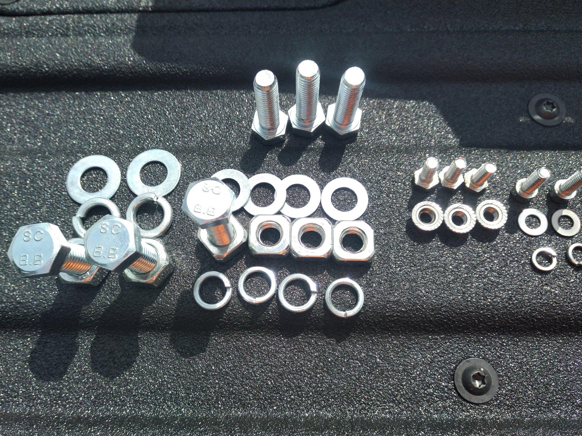

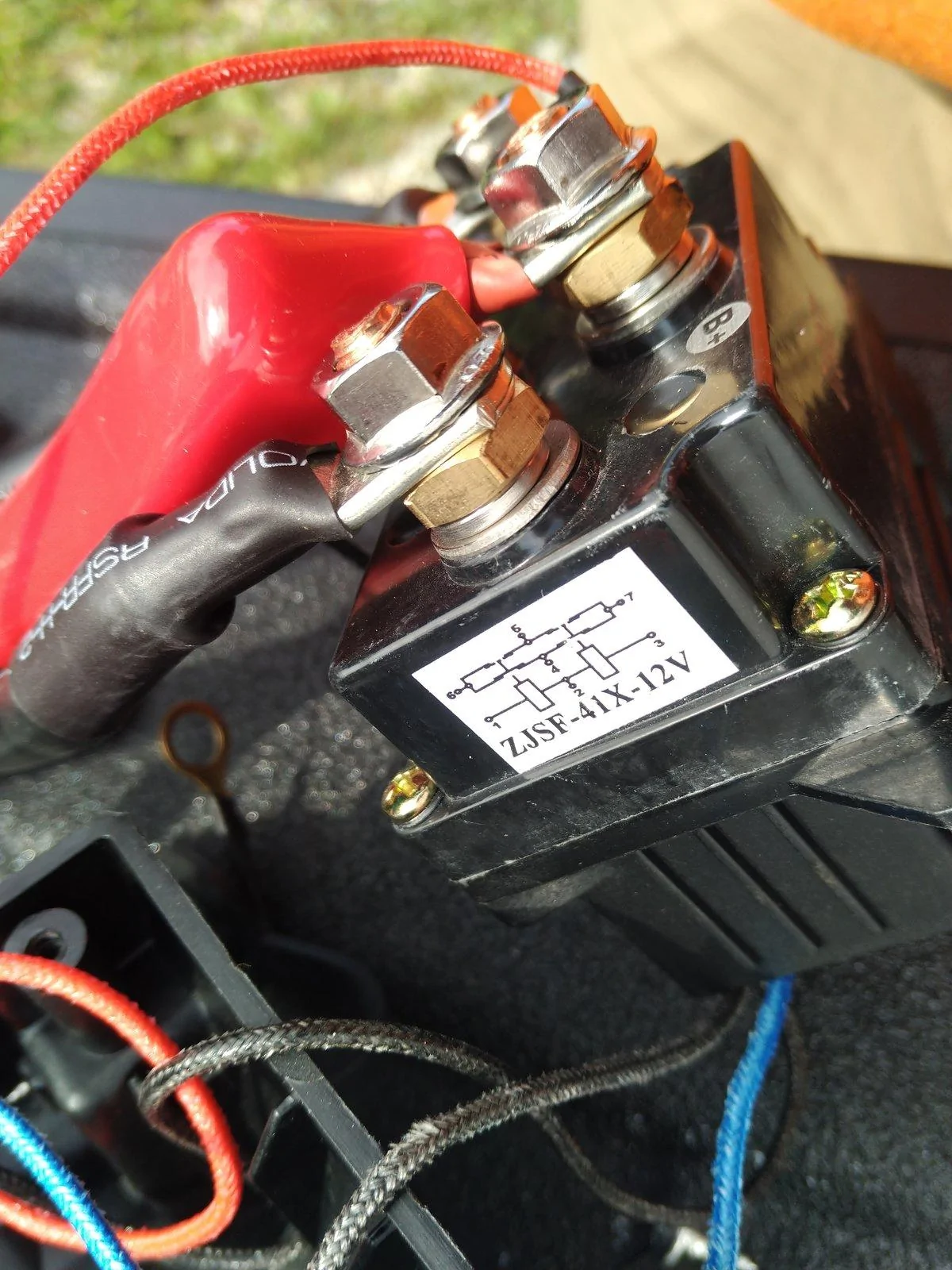

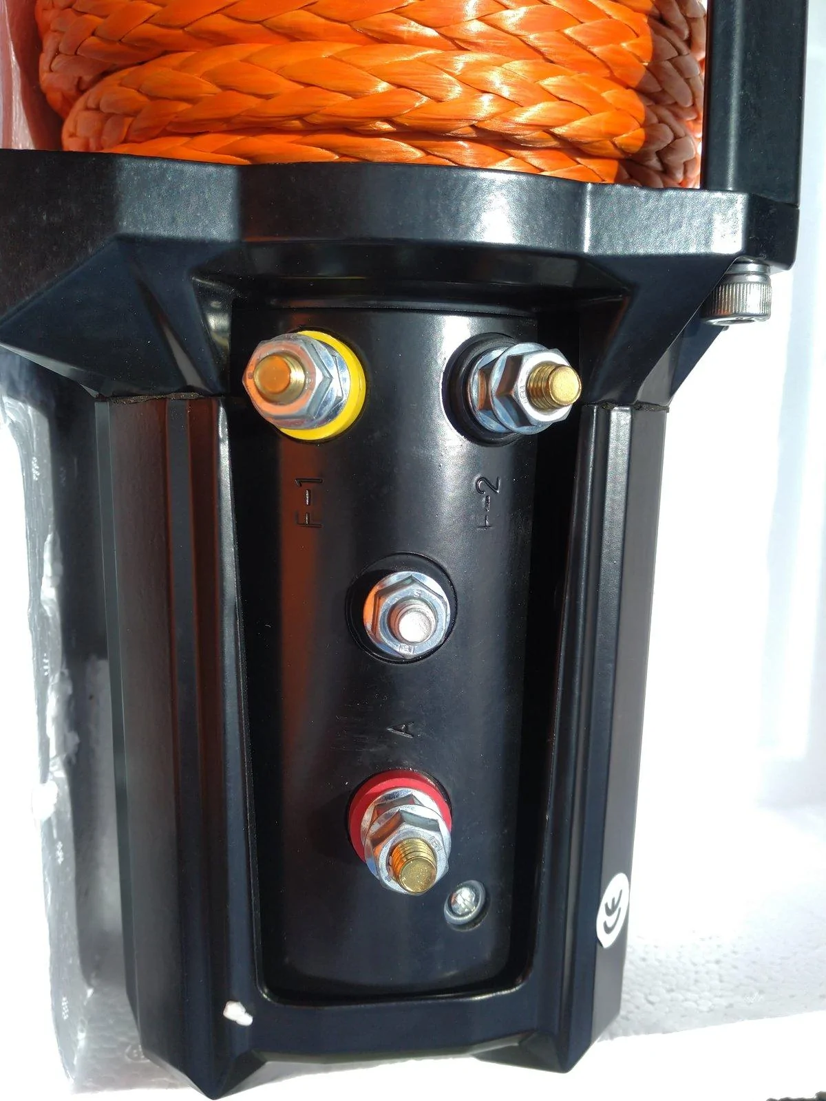

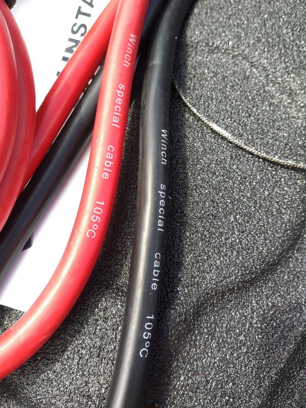

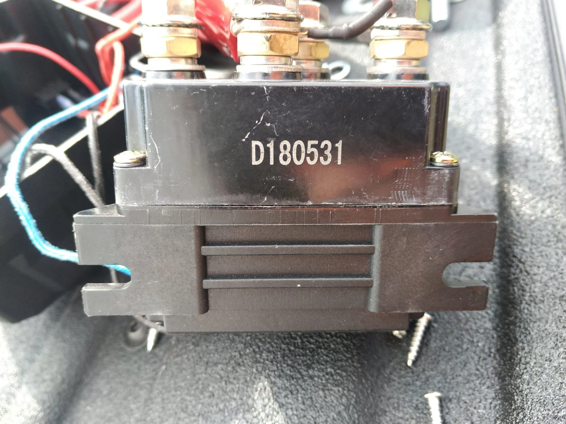

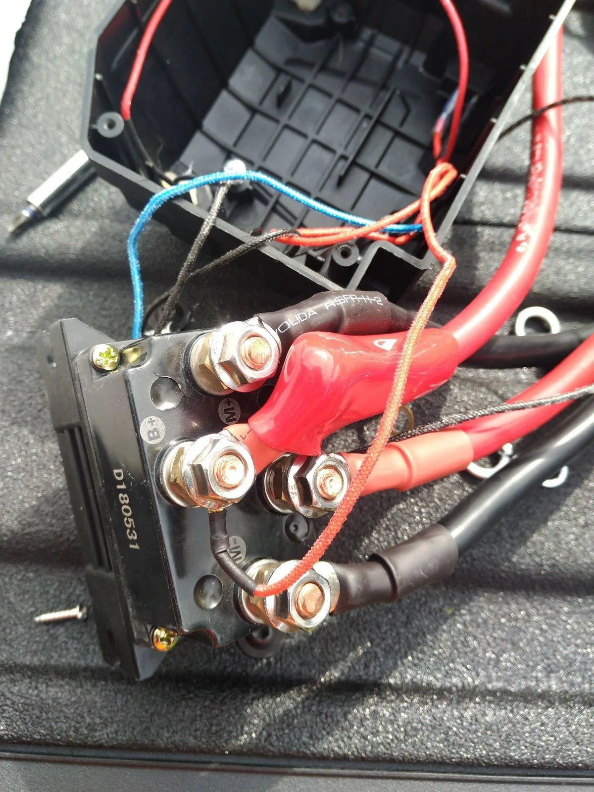

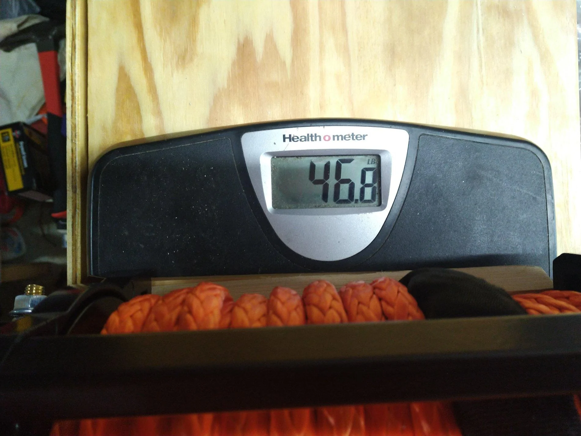

winch with line no control box 47 lbs. 49 lbs about total install weight. Supplied power and ground wire might be about a 1 ft slack after installing. Control box no water proofing, but if installed right should not be a big deal unless you spend time with it under water. 2 blue LEDs have hot glue locking them in place. Winch control box switch is low end but easy to replace when needed to. A few copper washers could be handy to have for install. I would recommend using some blue Loctite on control box mounting bolts for bracket (s)

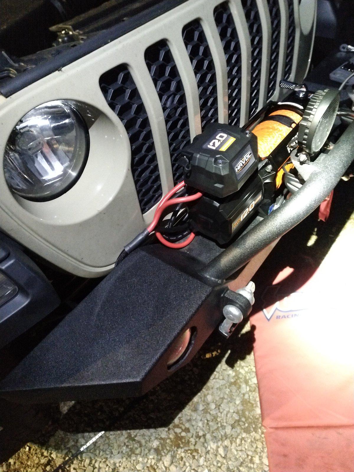

Winch controle connector is low cost pins was discolored already might be a problem later. Connection is like a 1970s audio connector. Hand controller part is a copy of Warn's older model, handy for thumb use.

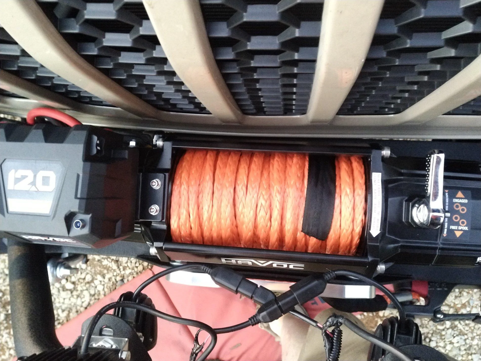

Install went with out problems, I ran power and ground wires in wire loom and heat shrink the ends (double layer).
When installing winch decide where you want the control box mounted center or side attach wires to winch with that in mind before bolting it down. I'm not quite sure that I won't go back and drill a few holes for power and ground wire to go through bumper. To make a cleaner install. I was going to install control box on corner of bumper ( for less blocking radiator).

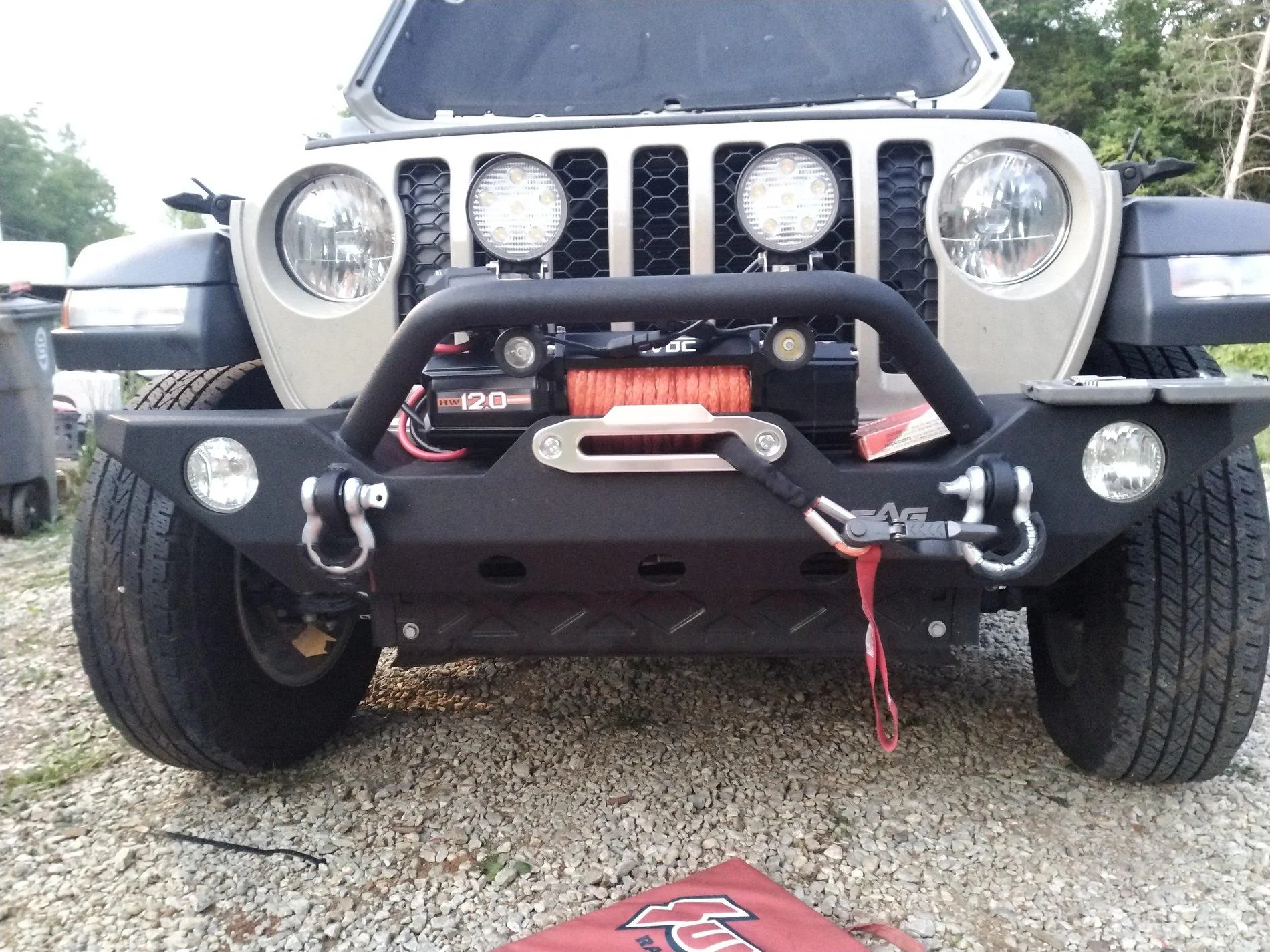

I planned on mounting control box above the right side fog light shown in last photo. I might still do that.
Winch is fast spooling in with out a load. Now I need to spool in line under a load.
