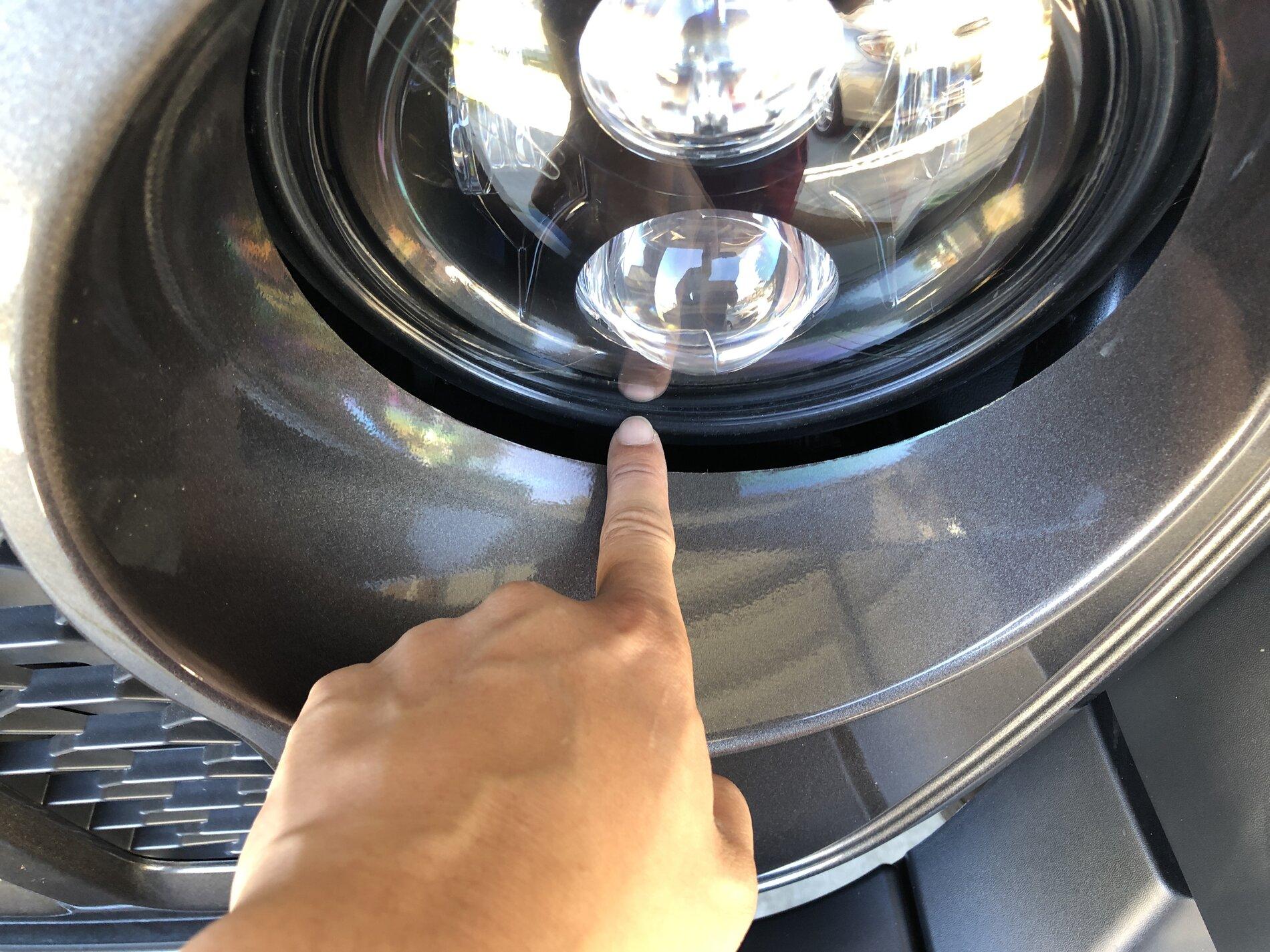

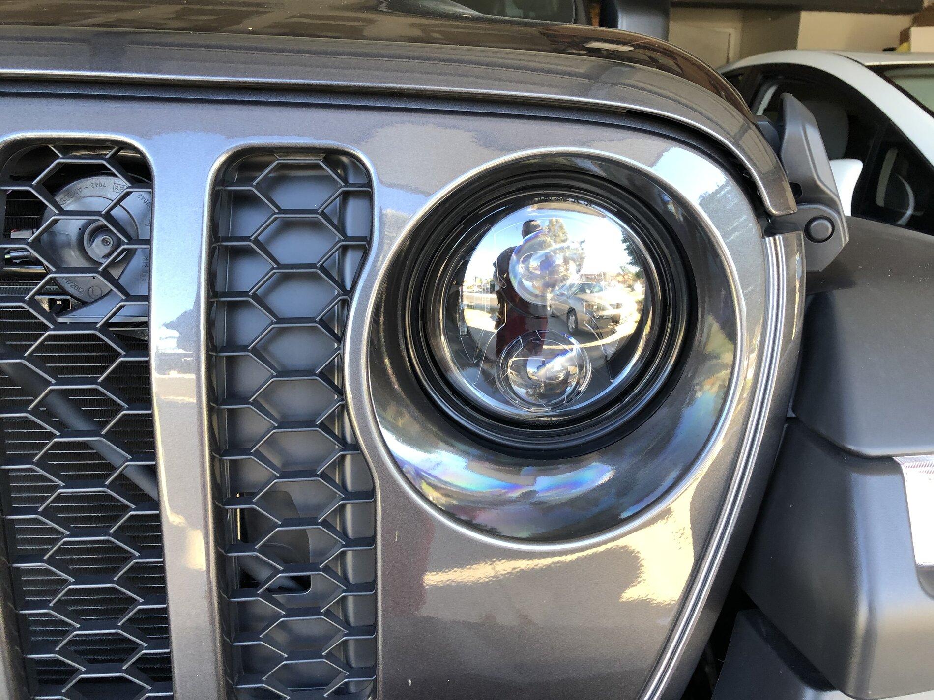

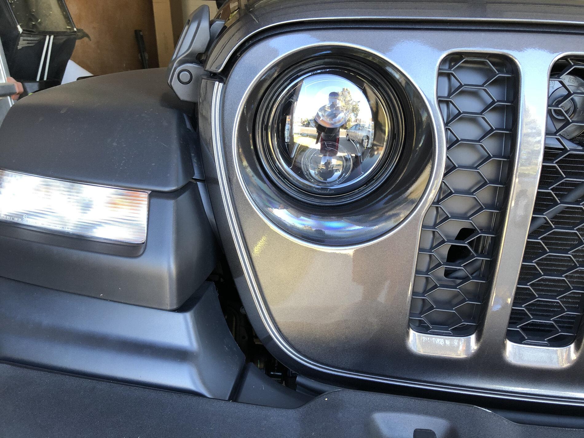

I too have a max tow. I have JW Speaker 8700 evo2 saved from my JK, same with the fog lights. No flicker and I even removed the anti flicker harness because it wouldnā€™t work with the oem harness unless u buy an adapter.
No flicker, and no bulb out message. Once I added the flashcal to change settings, I changed the headlights to led setting just because.
The fog lights though need resistors or they will not work.
There is a slight gap to the grill BUT, I added spacers to fill in the gap.
