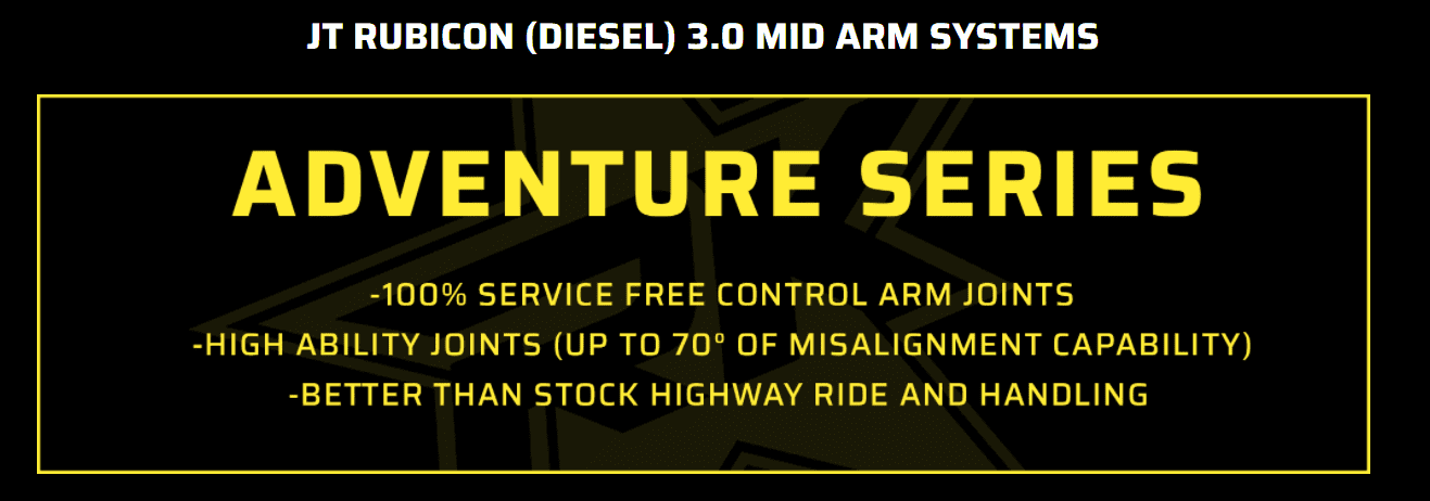

I went to the Rock krawler 3.0" adv and their RDD shocks for my ecoD and have been happy. I tow a small utility trailer so can't give much feed back on towing. RK gives a firmer ride then the stock and less floaty feeling, but is supple enough to not rattle fillings out of my head.
I think it's a better kit then mopar because it also comes with a front track bar and rear track bar relocation kit to recenter the axle under the truck. Only complaints i have :
I think their rear bump stop plates are a little tall and could be 1" less to give a little more up travel to the rear axle.
They include 2 rear spacers for the rear springs, the spacers are different heights, one for left one for right. This causes a slight lean on the rear, I plan to order a 2nd taller spacer to replace the shorter left spacer to get rid of the lean.
Last thing and its minor, I think they could use a little more weld on the sides of where the track bar bar is welded to the eylets. I don't think the lack of weld makes it weak, but it provides a avenue for salt, dirt and water to working there and rot/spall it from the inside. The front LCA's are similar.
Other then that, it's well made with strong materials, uses made in the usa springs and is pretty straight forward.

There is a thread here about the joints and it seems RK worked hard at trying to fix the issue.
That said I went with their ADV kit that uses bushing and not flex joints at the LCAs to reduce the number of serviceable parts/wearable parts, plus I didn't need that extra few inches of articulation as I am not doing crazy rock crawling in my new rig.

Adv? Got a link?
