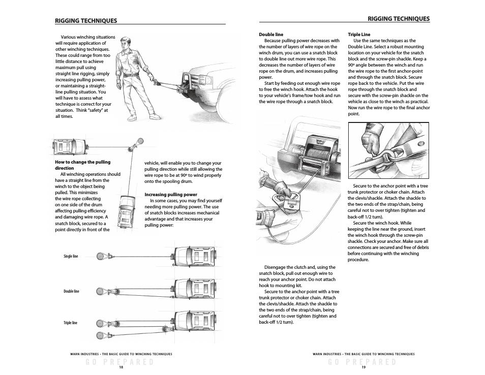

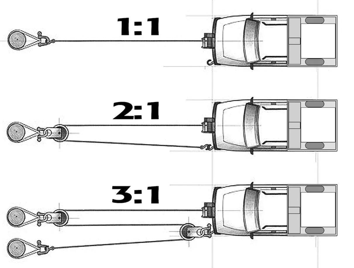

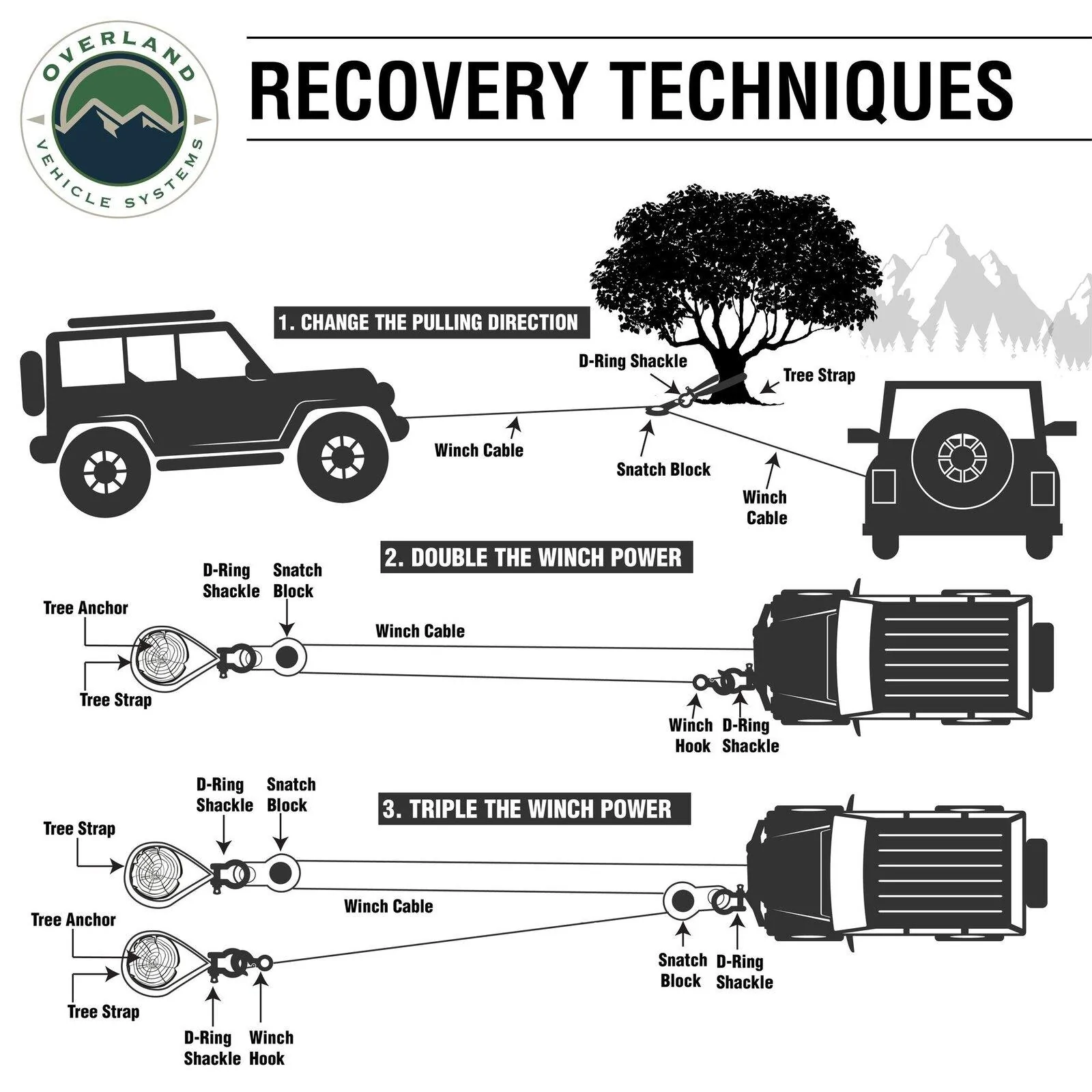

Here is my .2 : i went with a Smittybuilt X20 12k with synthetic rope. The reasons, it was rated and reviewed as a good winch, water proof and wired/wireless remote and it was a fraction of what i could find a Warn for. I went with a synthetic rope because it is lighter and safer than cable, when cable breaks it whips and cuts through anything in its path, synthetic more or less falls when it breaks, however any line of any material under tension is always hazardous and requires diligence and safety precautions when being used.
as far as going for a 8k,vs 10 or 12k, that is a personal preference. just be aware of the following: what ever you are stuck in will add resistance especially mud and snow, as the cable or rope is spooled and more wraps are on the drum the less pulling power the winch has, this can be mitigated by using snatch blocks, if used properly not only can you adjust angle of pull but can double the pulling power of the winch, example, snatch block placed directly IN front of vehicle with line from winch to block 180 degree back to bumper will give a 8k winch a 16k pull.
also to note, ensure all recovery gear can withstand the type of pressures, the snatch block for example or the shackles, if you get a 8k winch ensure the blocks shackles straps etc. can withstand a minimum of double that.
