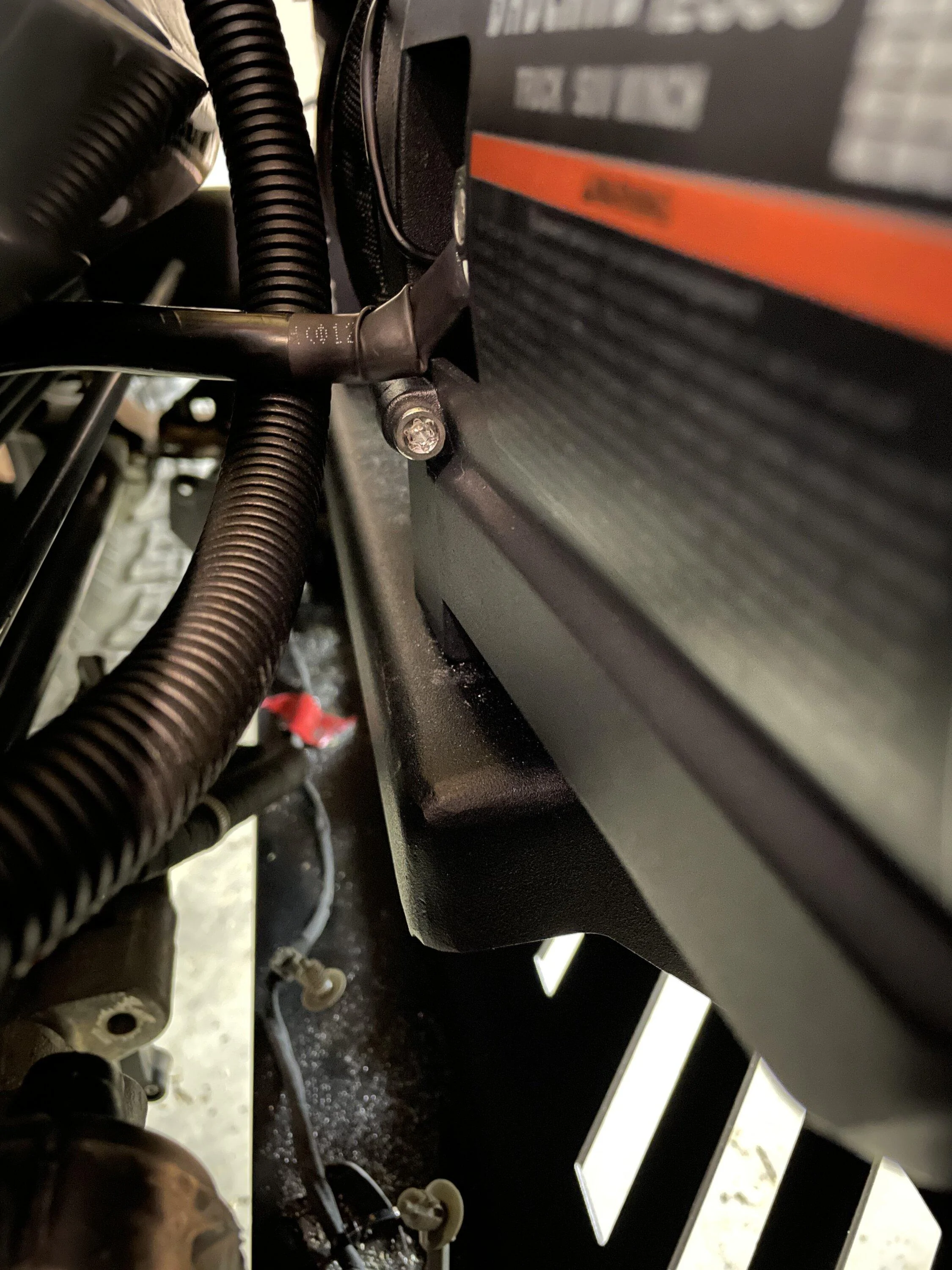

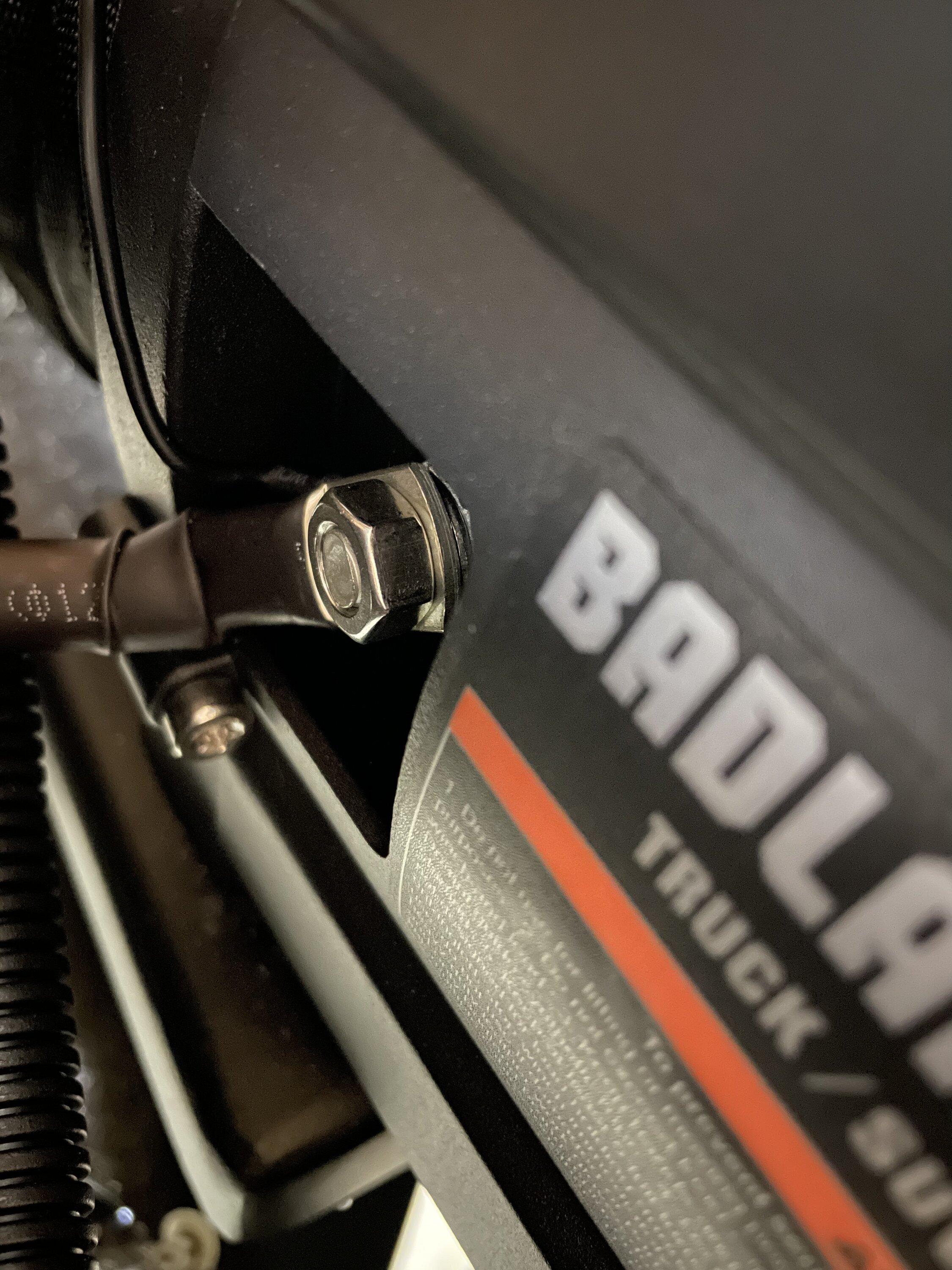

Can you reach the back of the base unit to take a picture of the connection s?

Oh! Looks like all the connections are internal as @Summitsearcher alluded to. Yeah, unfortunately it sounds like you’ll need to open the control box and peek inside.
Not a big deal to open it up. Pretty simple setup and the wiring is simple to understand.
