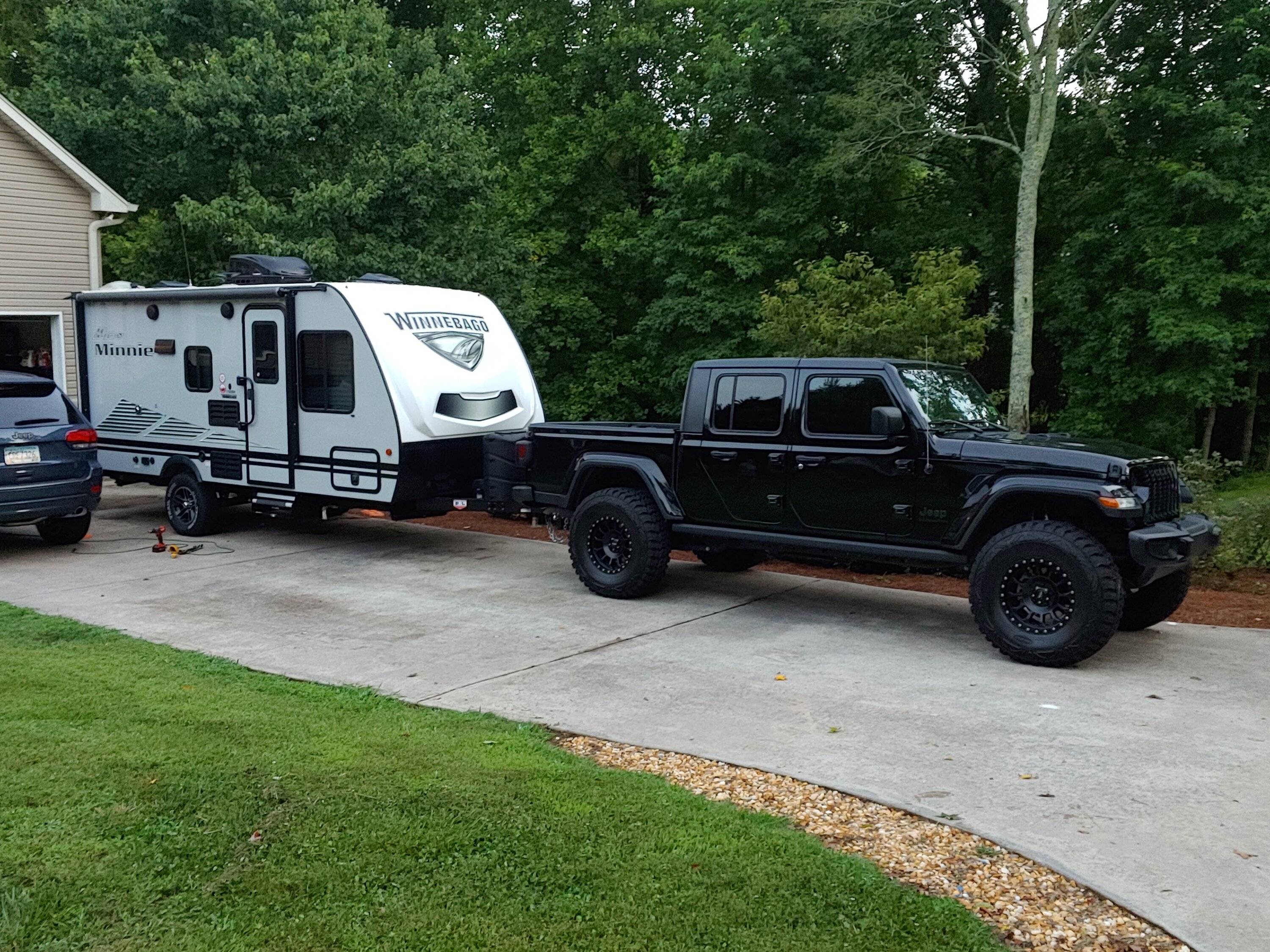

I'm a huge Metal Cloak fan but not for my gladiator. I've run them in the past on JKU's and they're fantastic. I have a major issue with the Gladiator lift however. It's the fact that it's focused on leveling the truck leaving the rear too low for folks who tow. Having sag in the rear when towing is no bueno.
The picture is an ecodiesel w/ Superlift 4' and 37's.
Murdered out!!! I love all black...I just live in the woods on a farm and can never keep it clean. My first love was my all black CJ-7...although back then polished aluminum wheels and chrome front bumper was necessary...no such thing as all black back then ?
