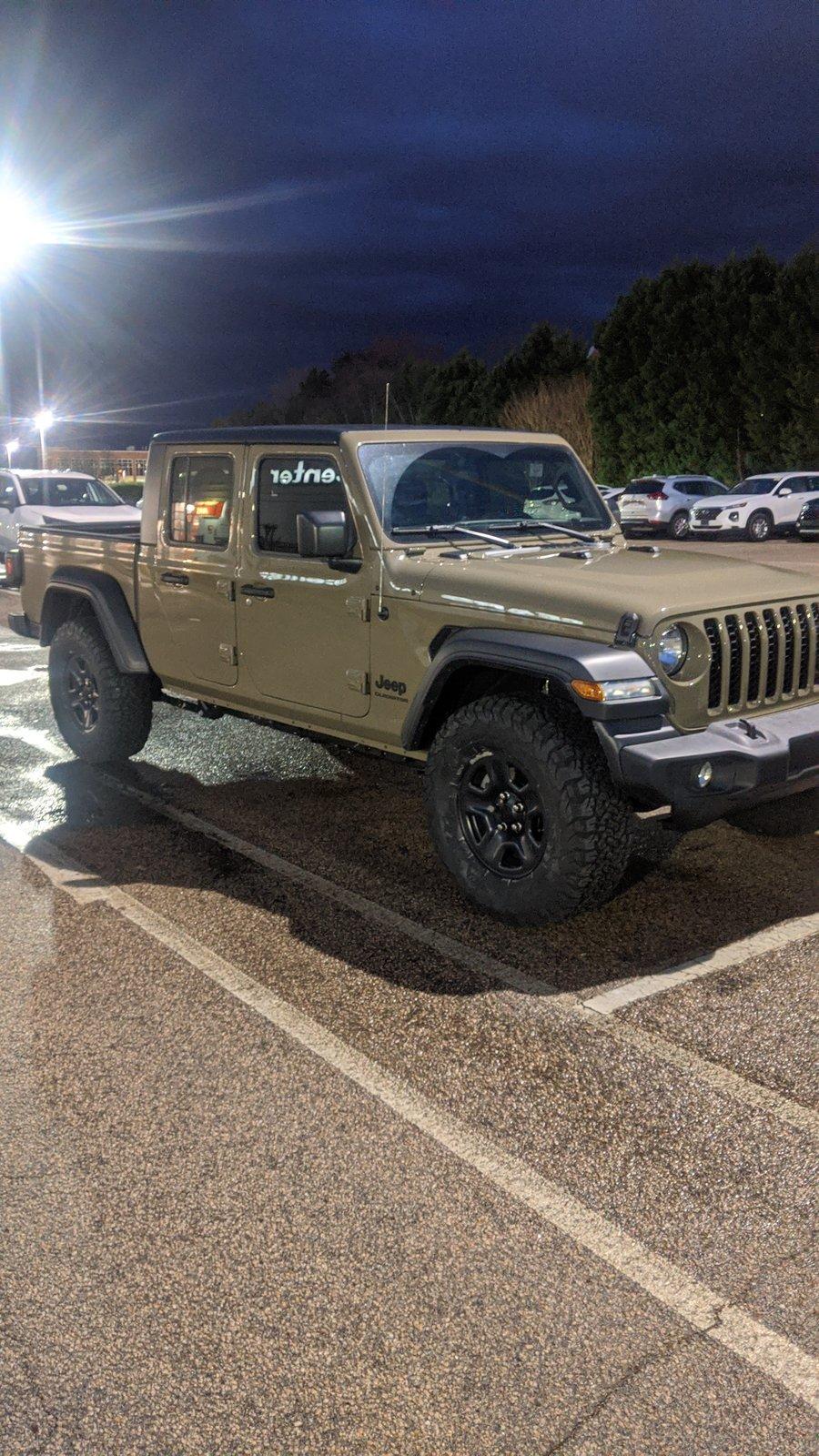

Before the lift with 315 70 17 BFG KO2 installed
Jeep Gladiator Help! Lift or level? IMG_20200213_183207

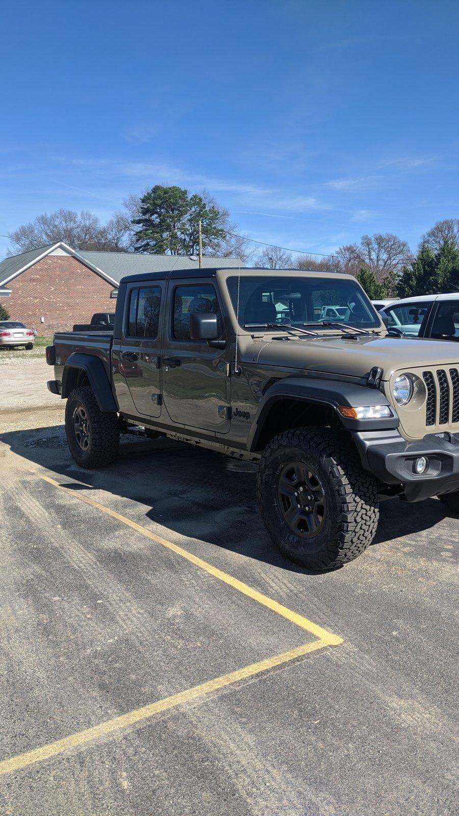

After lift same tires
Jeep Gladiator Help! Lift or level? MVIMG_20200215_113302

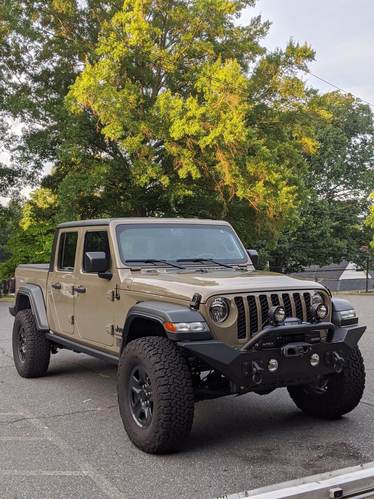

As it sits today with lift, tires and 1.75" wheel spacers
Jeep Gladiator Help! Lift or level? 00000IMG_00000_BURST20200704070037778_COVER
